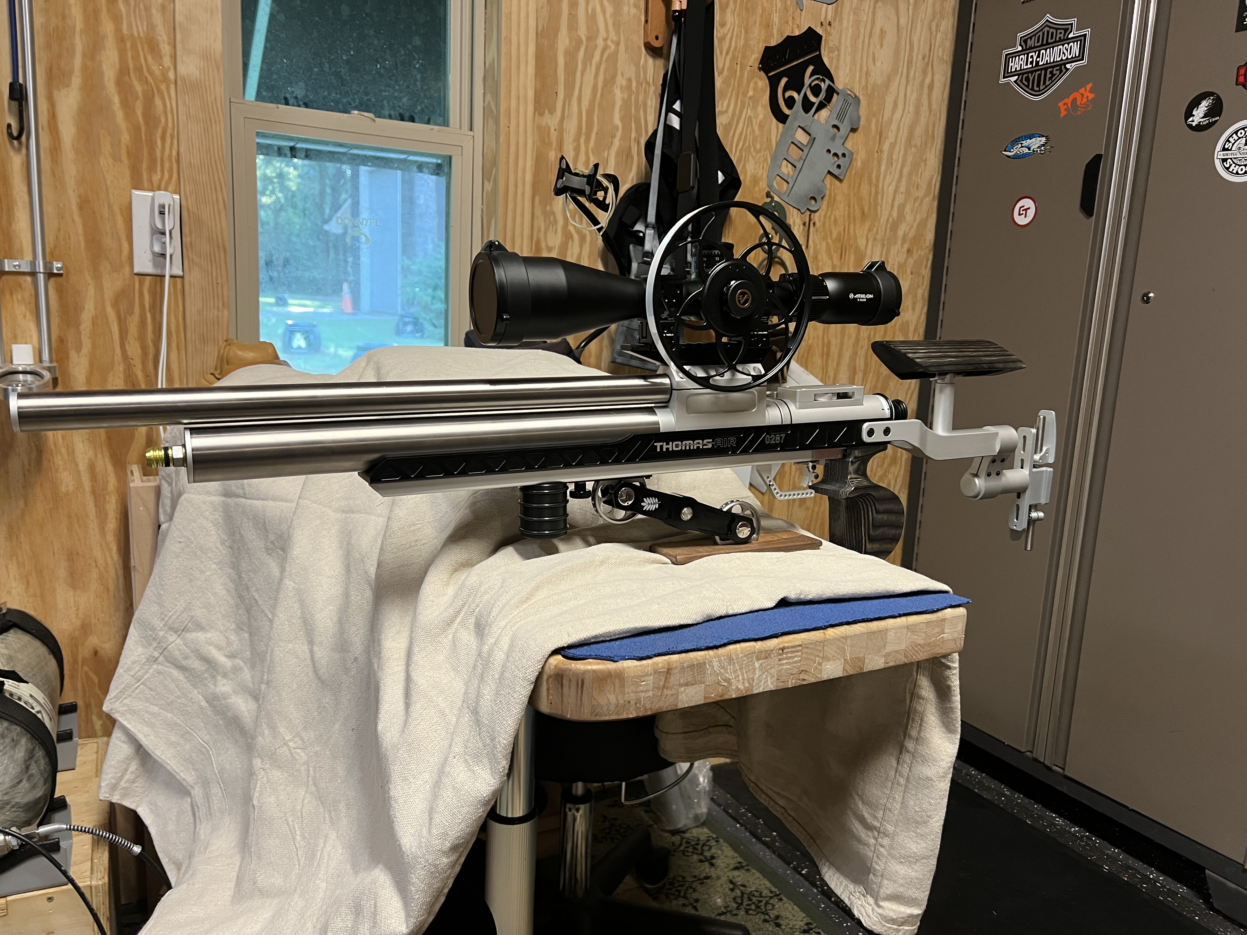

This one as shown with Athlon 6-24x56 scope and Rowan hamster weighs 12 lb 12oz
