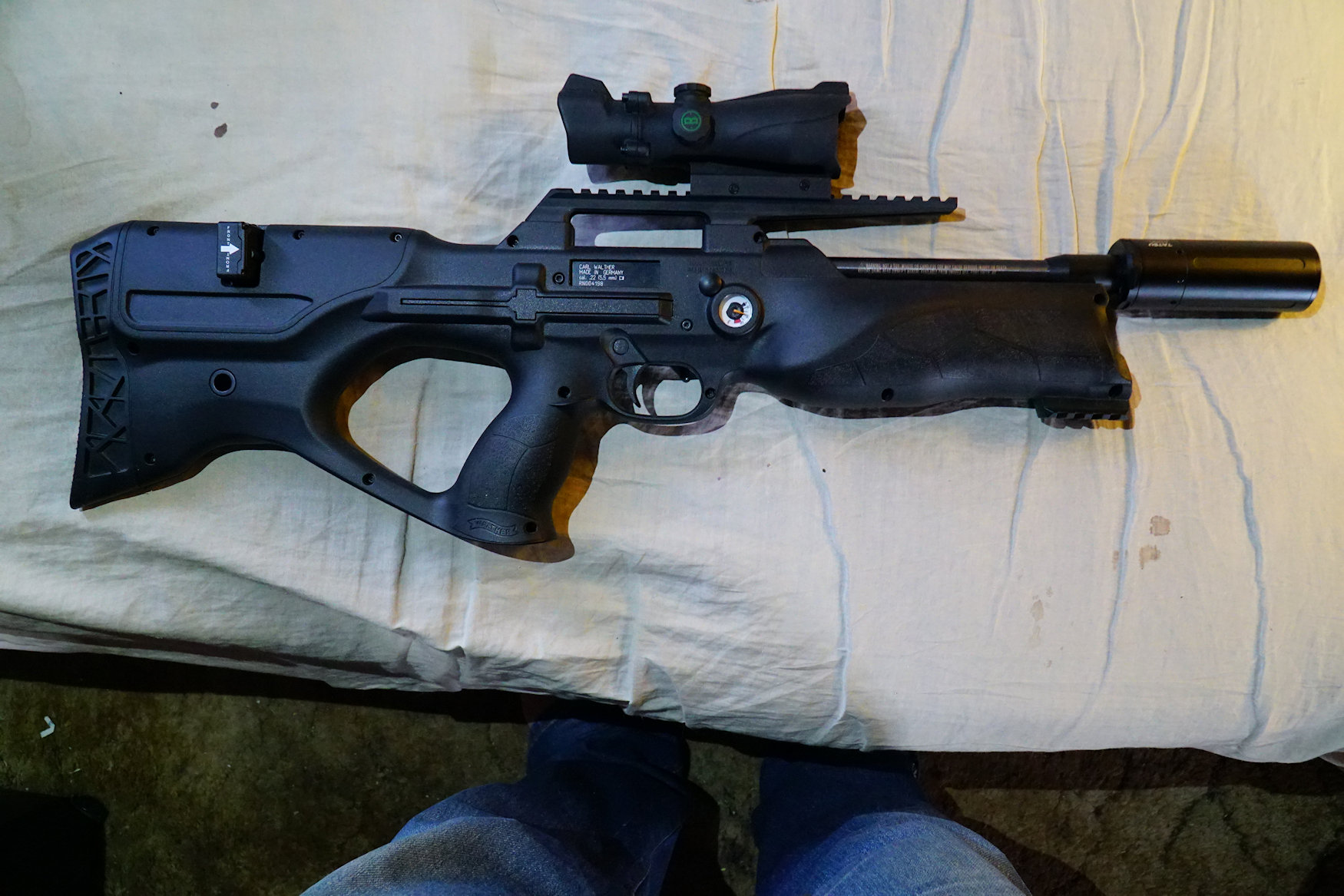

But the Walther Reign is a good bet, that's under $700 and available new . Just a note, I shortened mine a bit !

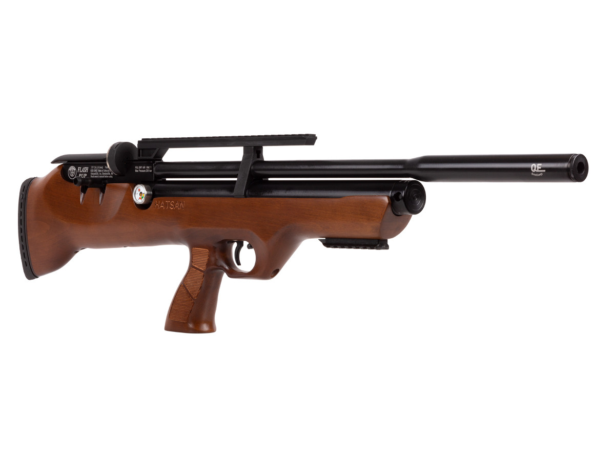

I know that the Hatsan is somewhat popular, under $700 , Available new .

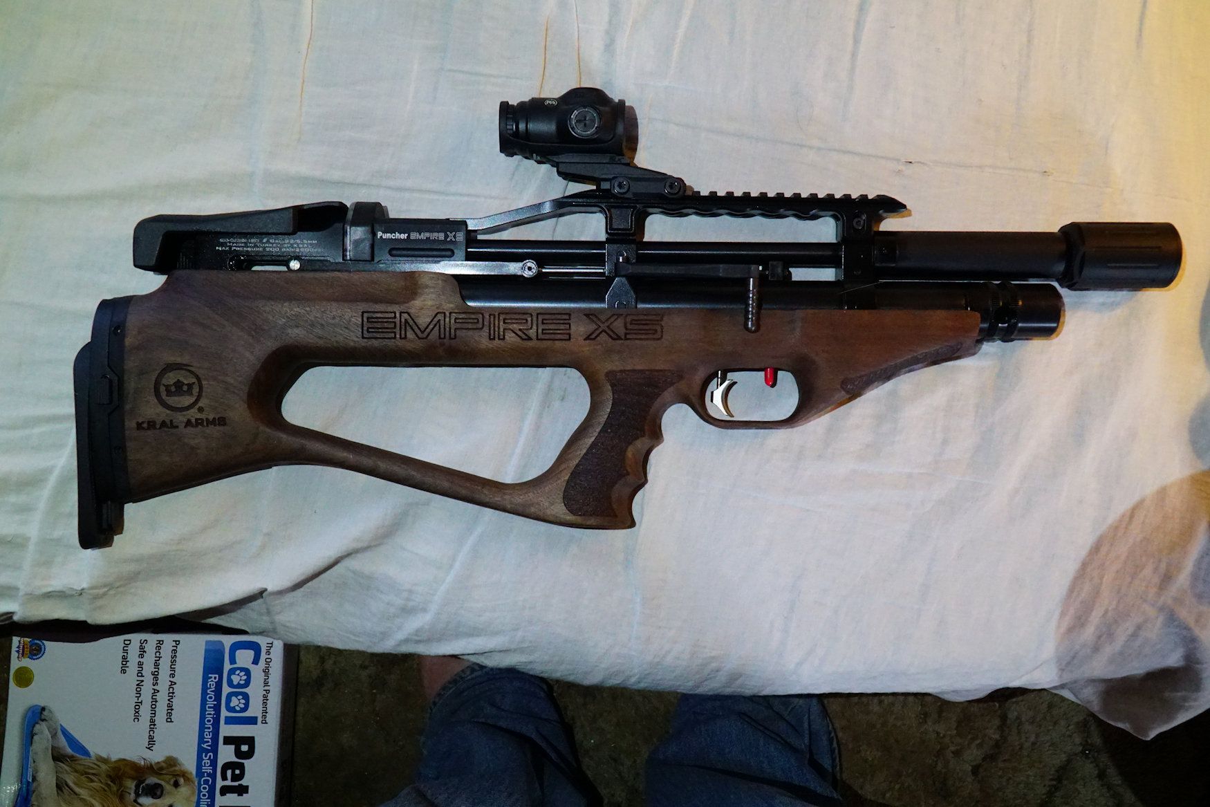

I have a Kral Empire XS that I like -

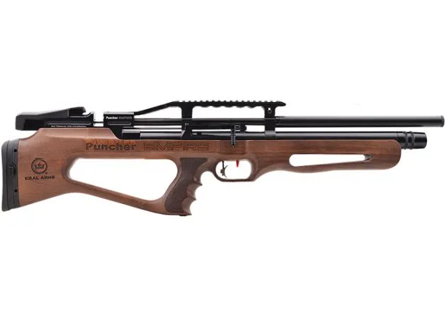

This is a "Puncher", the big brother to the XS. Look further in the Kral site to find the XS. Kral does sell to the uS with proof of age. Under $700 . Available new ,
My XS -
I really like it, but it appears to be out of stock right now. Under $700 . Out of stock right now.

Yeah...that's why I cut the barrel of my Reign...make it...short !
The Empire is a great little gun, especially for the cost. I've only had it 7 or 8 months, but so far, not a single problem. No negatives at all.
My only comment would be that I only shoot offhand and at shorter distances, so shooting to 75 or 100 yards, would be a crap shoot. But shooting 25 to 50 yards should not be a b problem at all.
