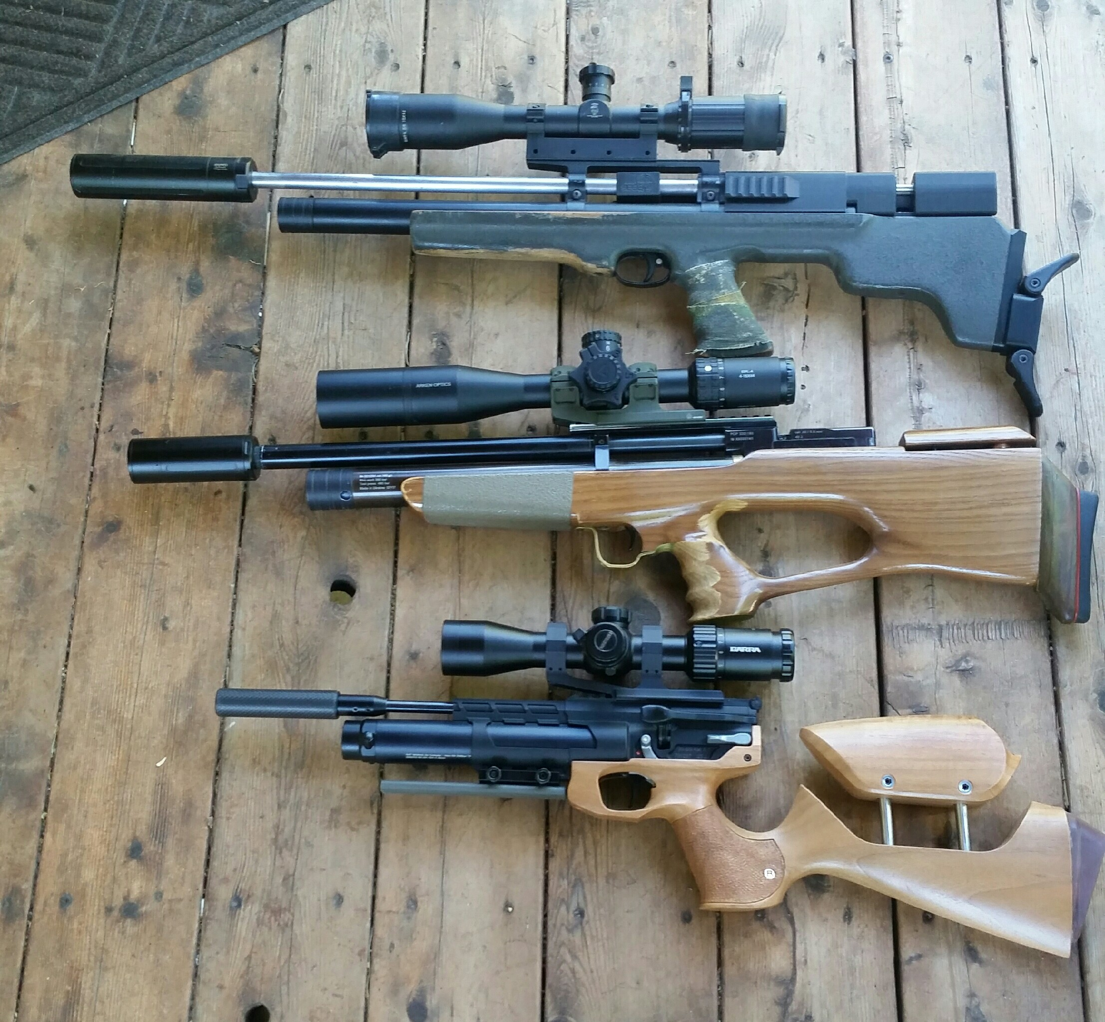

top, SPA P15 bull pup w/21 " LW barrel 25 cal 54 ft/lb
middle, Zbroia Kozak compact semi bull, with 330 mm barrel, out dated model my daily shooter de-powered to about 20ft/lb 22 cal
bottom, HW44 pistol w/Rinks stock 22 cal all stock internally as to power settings, but aftermkt air cylinder with a picatinny support under it w/rubber cover and an old spook mod

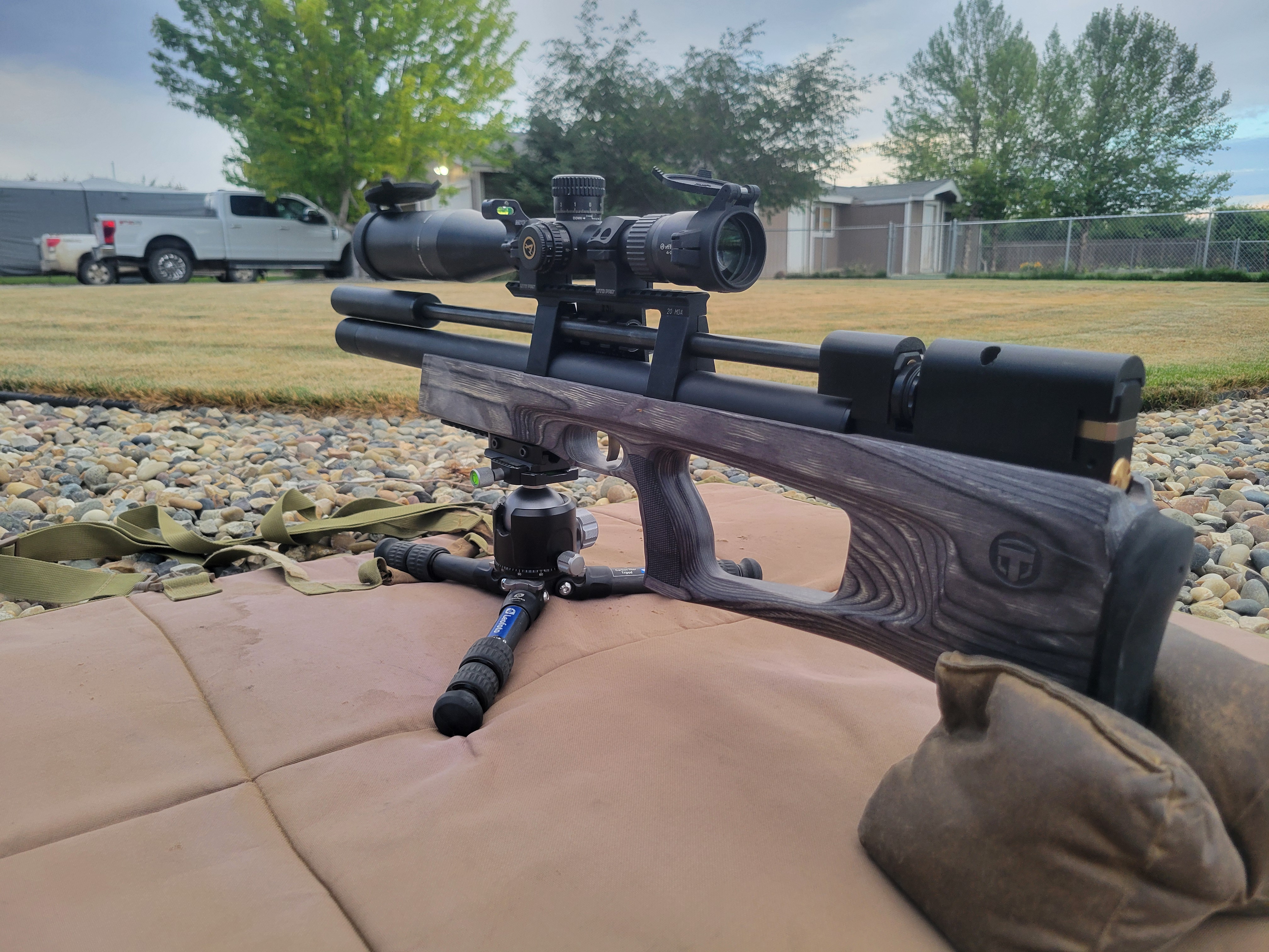

Interesting. On my Taipan even with 2.35" scope height I had to add a cheek piece for it to feel comfortable otherwise the scope felt too high for my liking.

Interesting. On my Taipan even with 2.35" scope height I had to add a cheek piece for it to feel comfortable otherwise the scope felt too high for my liking.View attachment 472250 I also do "real" hunting and never use a range finder. Mainly just to sight in and verify my strelok data. I never knew it was a big deal to people but consider me enlightened to that. My shooting consists of birds, squirrels and rabbits and my rule of thumb was always aim top of head on fur or throat area on birds up close and ill always get them. The 1/4-1/3" difference between my bullpups or rifles don't make much difference to me on up close shots. But hey to each their own.
We all have different shaped heads and faces. A 2.35” isn’t bad for a bullpup. My best and still comfortable without a 20 MOA rail is my P15 at 2.39”. I would love to keep all mine in the sub 2.40 range. My Taipan w/o a 20 MOA rail is 2.60”. My face could let me mount it lower but I would have to get an offset butt bad like I did on my P15. It’s probably an over pickyness thing. Some guys just adapt better
