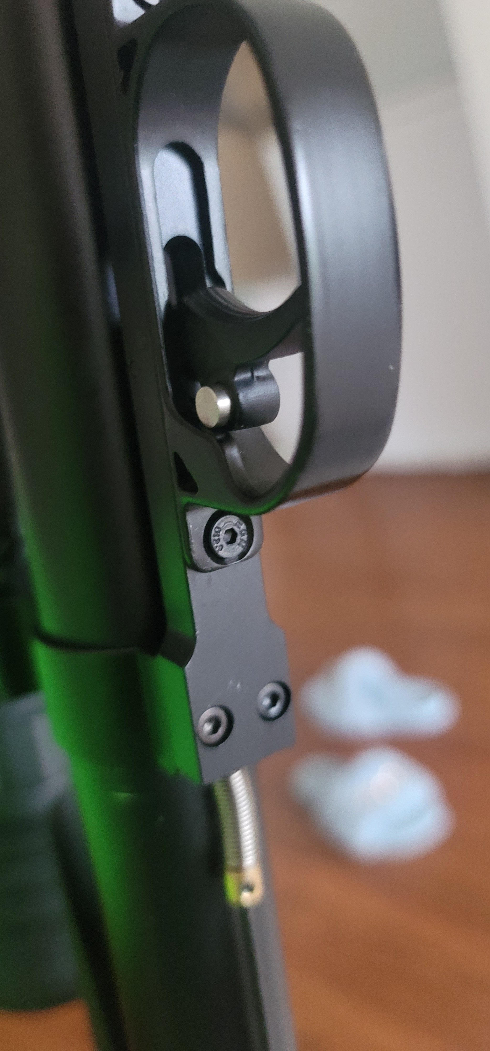

This picture comes from my newer P35-22, just for a change of pace. The gun fires when the trigger is a little further pulled than this. It is not possible for the trigger to move to this position with the safety engaged. The safety pin prevents it. The safety pin engages the bump in the trigger housing you can see right behind the shiny end of the safety pin.

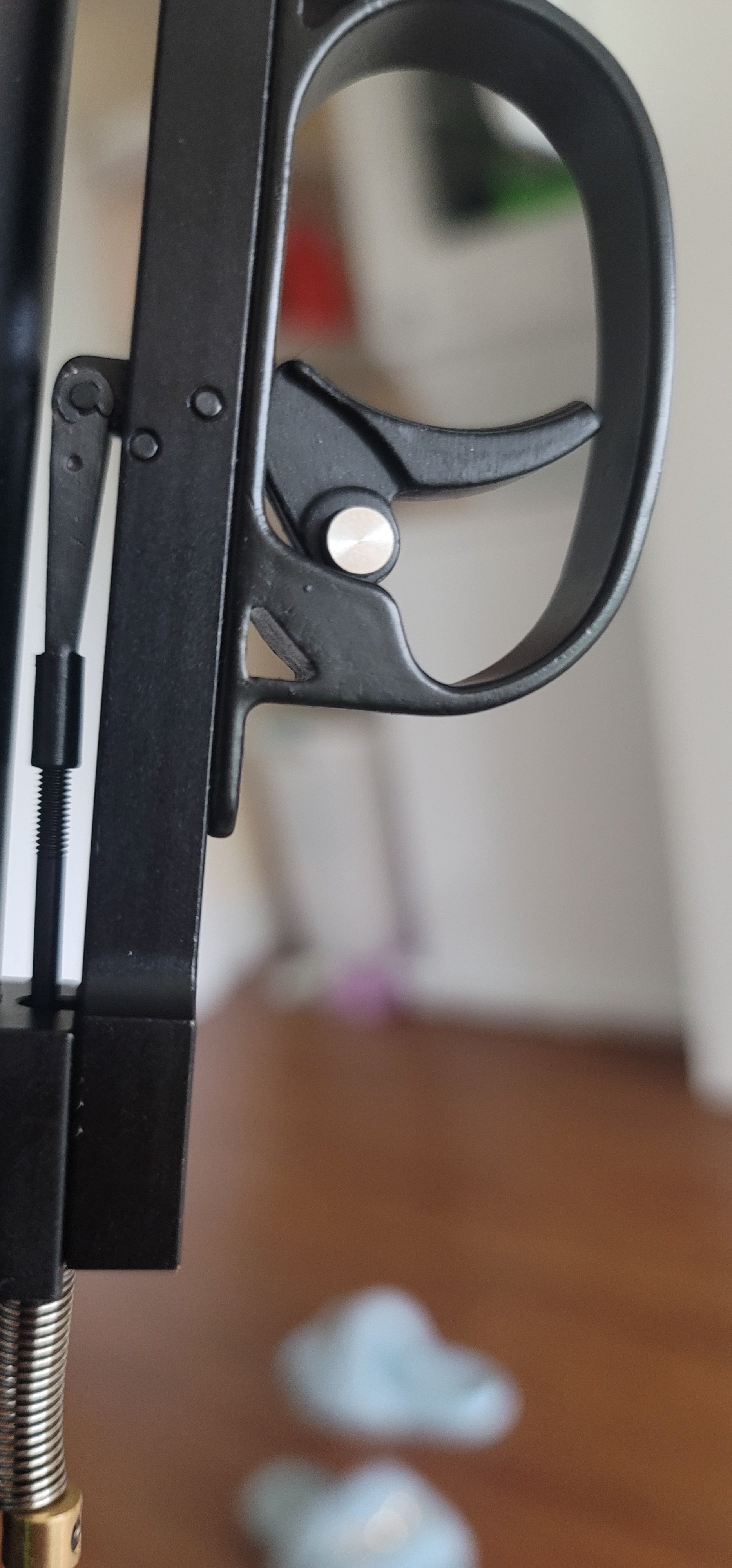

Can you take a picture from the side like this of your gun in the approximate fire position for the trigger?
I agree with jarmstrong, I think the problem is with the trigger guard and a picture straight from the side like my last one would make that conclusive. If it is the problem, one of the previous owners modified the trigger guard or installed one from another gun. I think the latter is more likely but who knows. The trigger guard can be unscrewed if the action is out of the stock. Four little screws. If you lack the bump in the trigger guard the safety needs to best "fix" is to find the original trigger guard. If that is not possible I suggest contacting a Stoeger dealer. The Bullshark I tuned for another member was a replacement he got from a Stoeger dealer when he damaged the baffle stack. He told the dealer it was his fault but they just took his gun and gave him another gun for free. You might be offered the same "fix" but if not, maybe they would swap your trigger guards for one from a gun they are returning to SPA. It is also possible to buy parts from SPA but they seem to only ship parts when they ship guns and only to gun dealers. I did it through Krale (dealer for P35s) and it took about a year.
If I had to go that route I would modify the trigger guard to use in the interim. It seems possible to remove the trigger guard and tap in a grub screw to provide the same function as the bump. It just has to block the trigger from rotating much when it is in the "safe" position. I would drill and tap it from the outside of the trigger guard. Getting the position right would be a little tricky. But it seems possible.

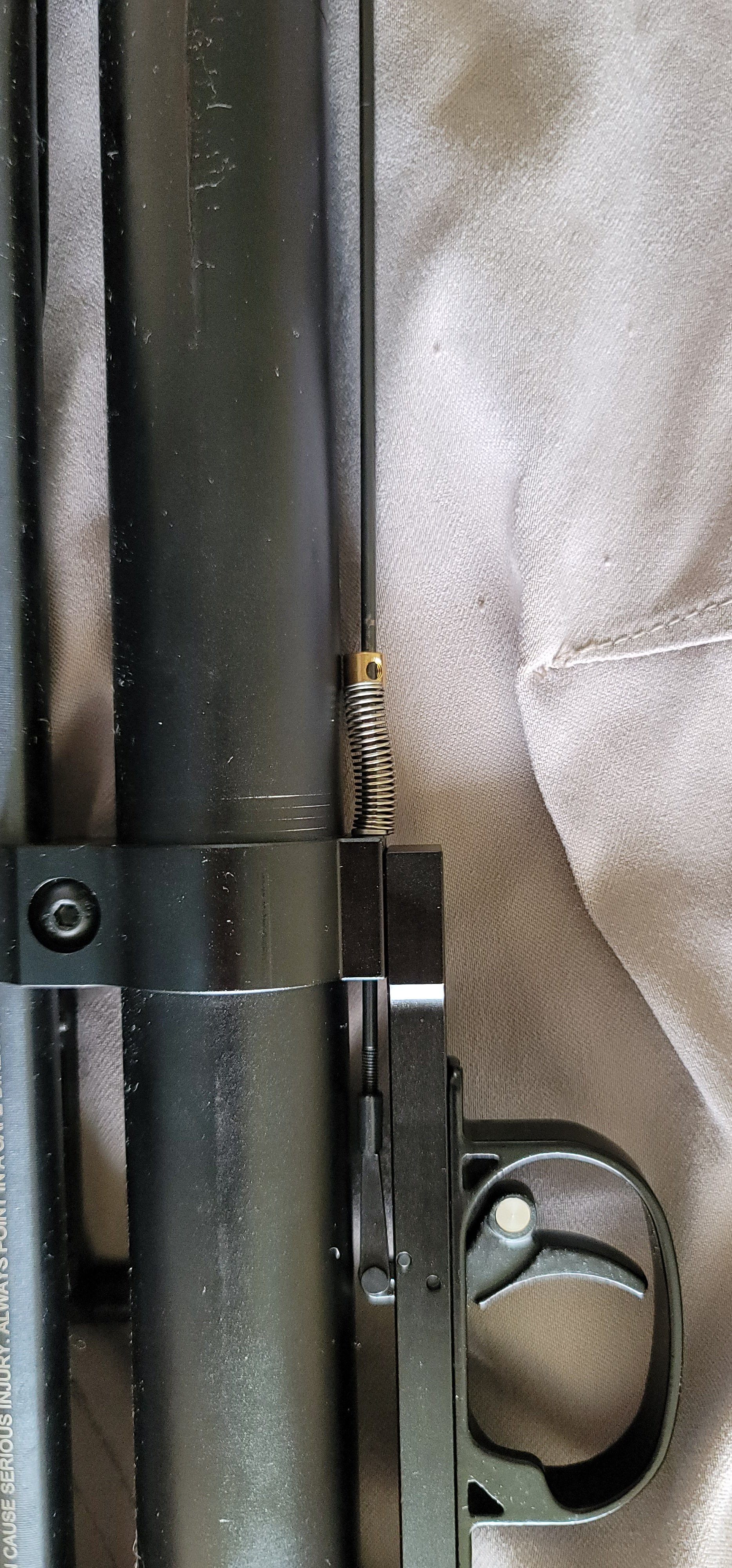

you are missing the hump on the trigger guard itself, that the safety button catches ,,, see Jim's photo

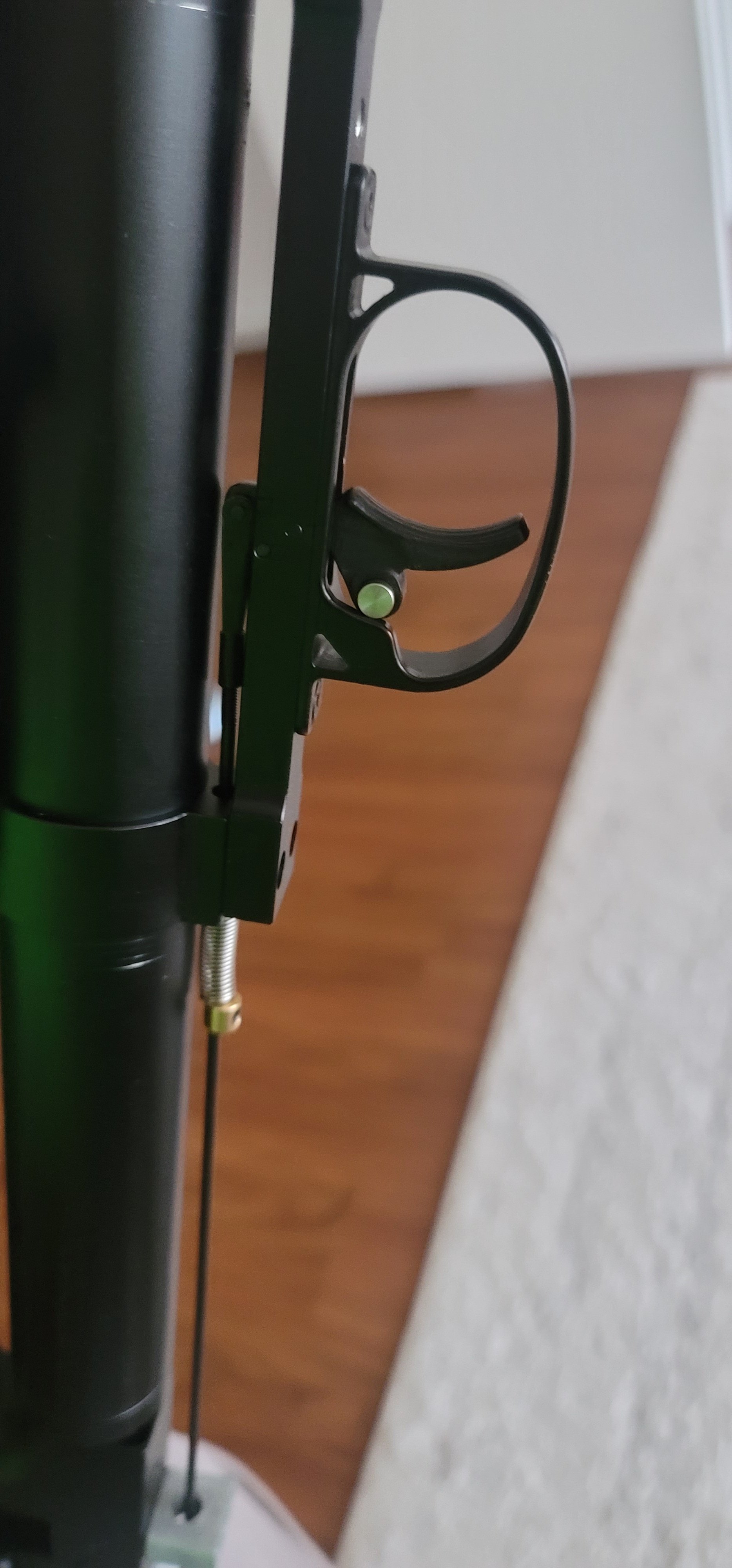

I think I found the problem, I can't say for sure atm since I'm at work but the trigger guard is backwards from the looks of it.
Reactions: jarmstrong
I agree. Looks like you just need to unscrew it, flip it, and screw it back on. I would also relax that spring unless you really like relatively heavy trigger pulls. Just loosen the grub screw and let the spring relax some and retighten it. First stage will get much lighter and the second stage will go down by the same amount but will not go to less than a pound. You might not was the first stage as light as I have it but that is pretty much a maximum spring setting so the trigger is probably around 3 lbs.
