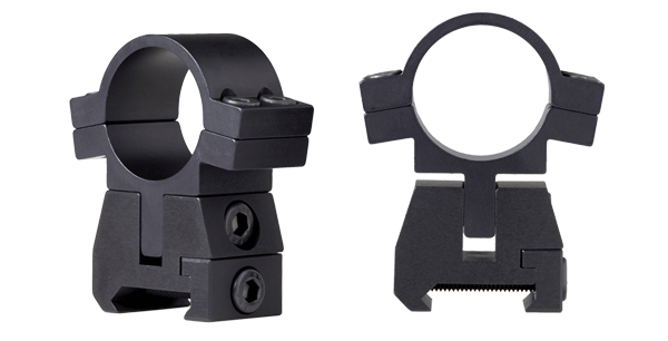

I kept thinking what that ring setup I had almost ten years ago. So here it is. The FX adjustable rings,for elevation only. So if your not off to much left to right these could work. another point, A 1/4" click scope may work better over an 1/8". For 1/4" at 25 yds is 4 clicks ... opposed to 1 click for 1/4" at 100 yds. thats why you run out at 25 yds if your over 6" lets say . I'm just bringing this up for guys that are having problems and here may be your cure all.

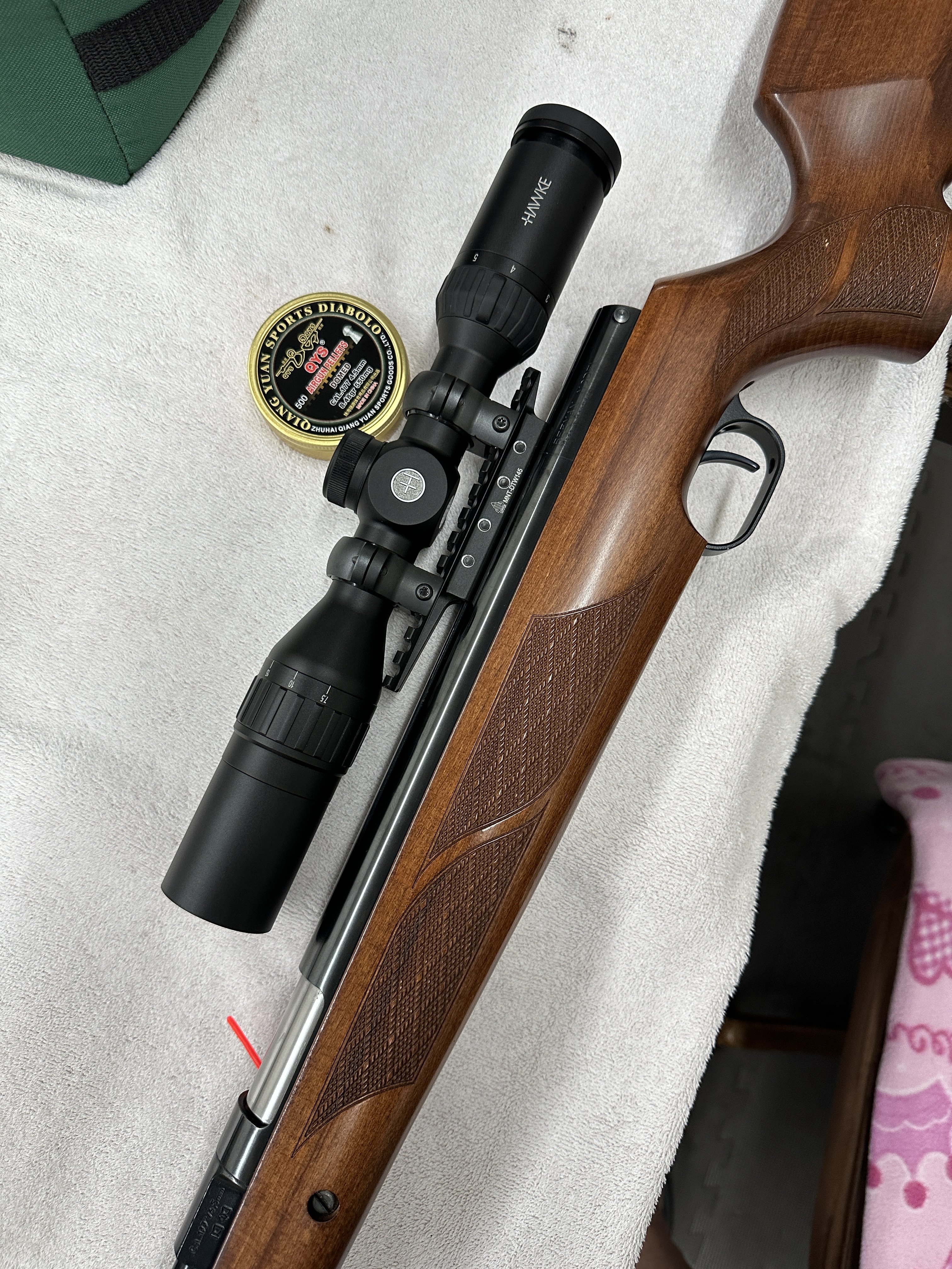

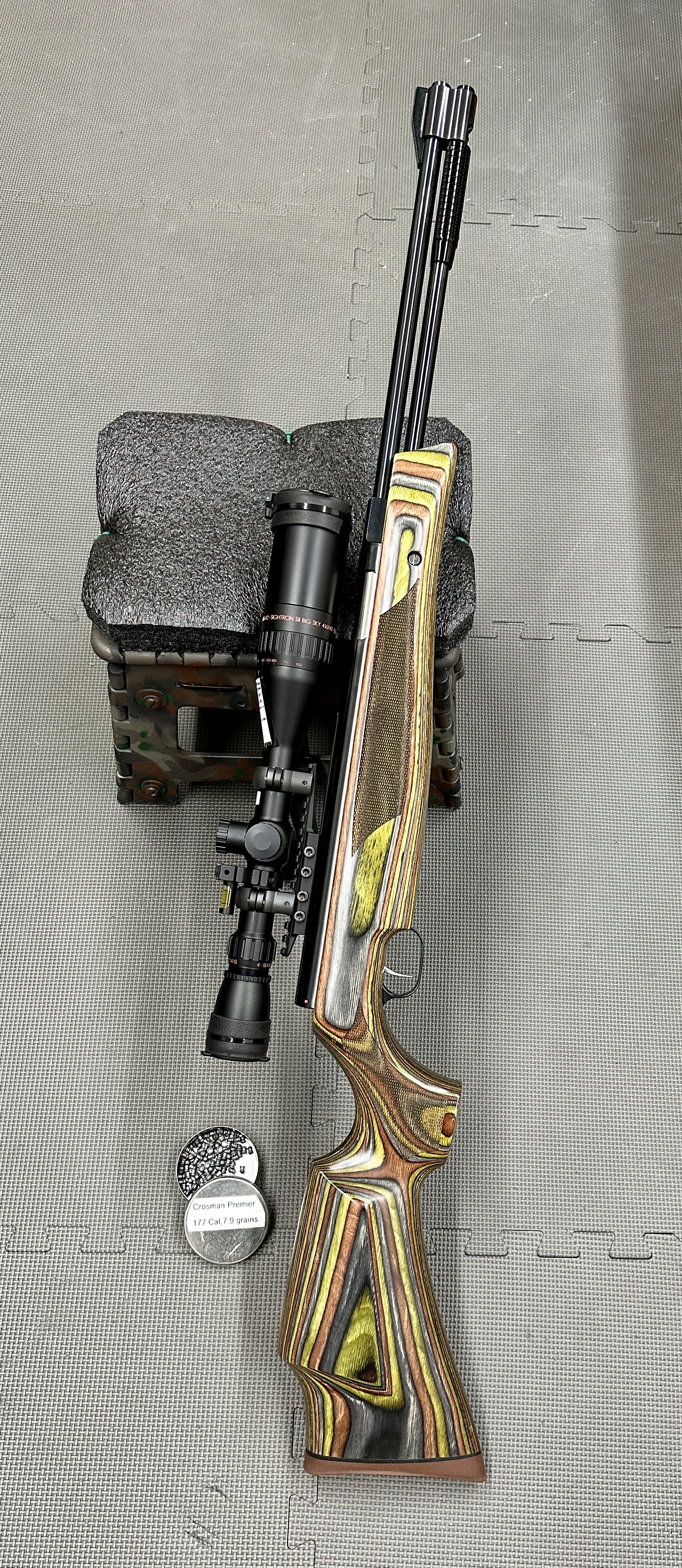

Also notice Bustachips last pic. His shims are canted up 1/4" in rear ring. He is moving the scope either right or left also. Once you start using these rings you'll see how you can move that scope around.
Remember though you must have matching opposite inserts in each ring, ie the +/- must add to 0. If you run the +20 on the bottom, you must run the -20 on top.
Incidentally the ring set doesn't come with four 0 inserts. So if you want no additional cant you have to get creative. I run +/-20 in both the front and back (-20 on the bottom halves)
