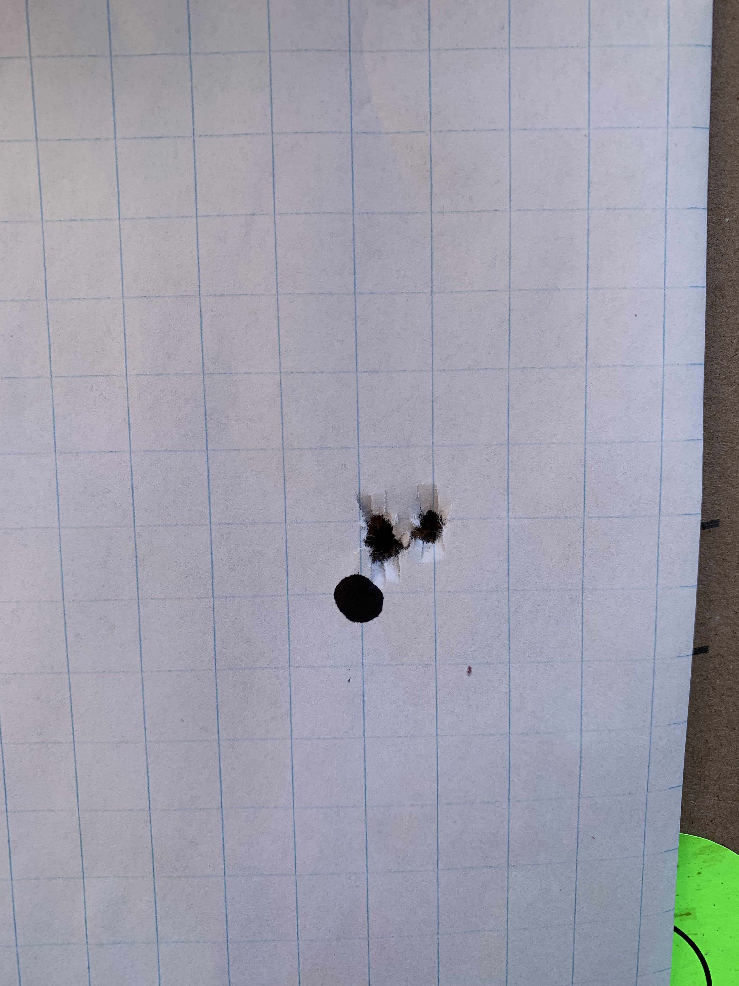

Ok…. I’m going to eat some crow. I had been shooting with the magnification cranked way up, in order to be “more accurate” with my shots. This made my head/eye placement much more critical than I realized. I backed the scope off, and made a huge improvement. This is actually 2 separate groups. The higher/righter group of 3 shots, a scope adjustment, then the rest. That’s half inch graph paper.

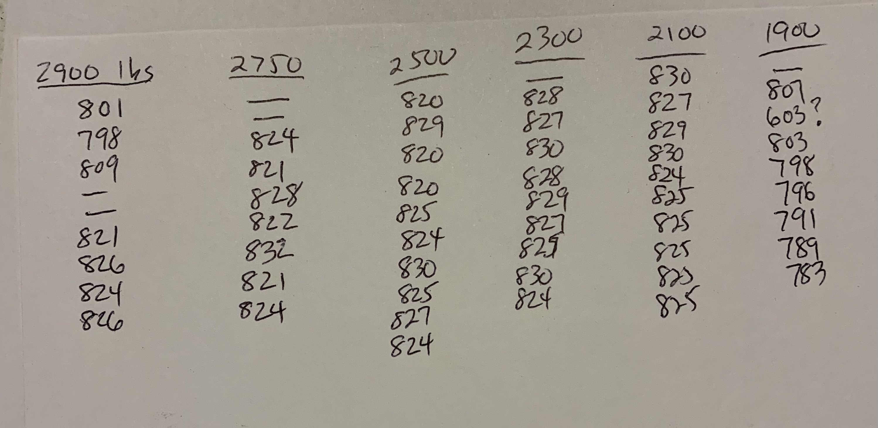

Sorry, still trying to figure out how to work this forum…. I also busted out my old chronograph and got these results, starting with a full pressure of 2950, then groups as the pressure decreased. Seems like it was most consistent from 2500-2000 lbs, then it dropped off. The missing ones are my operator error.
Looks like it…. Mmmm, gimme a nuther bite of that crow

Ok…. I’m going to eat some crow. I had been shooting with the magnification cranked way up, in order to be “more accurate” with my shots. This made my head/eye placement much more critical than I realized. I backed the scope off, and made a huge improvement. This is actually 2 separate groups. The higher/righter group of 3 shots, a scope adjustment, then the rest. That’s half inch graph paper.View attachment 400544
That's more like it. Glad to hear it. S7
