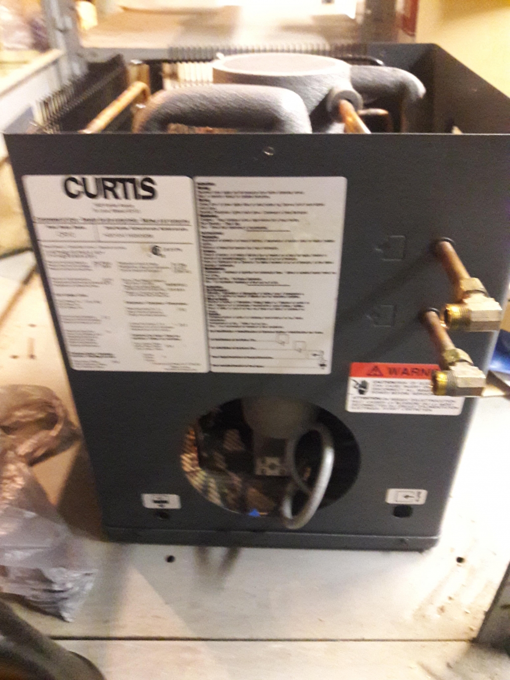

this is my basement air dryer
well I got 2 of the this one is big enough to supply air to my altaros booster at max capacity though this is a 2400.0 piece of kit the compressor burnt out in it and I got it for nothing took the compressor from an old freezer and now I'm golden.
