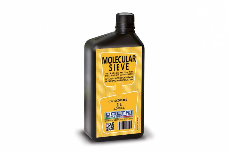

Filtering is the last thing you need to worry about because it just takes a cheap filter containing molecular sieve to remove the moisture. The air going into your PCP will be much dryer than that produced by your hand pump.

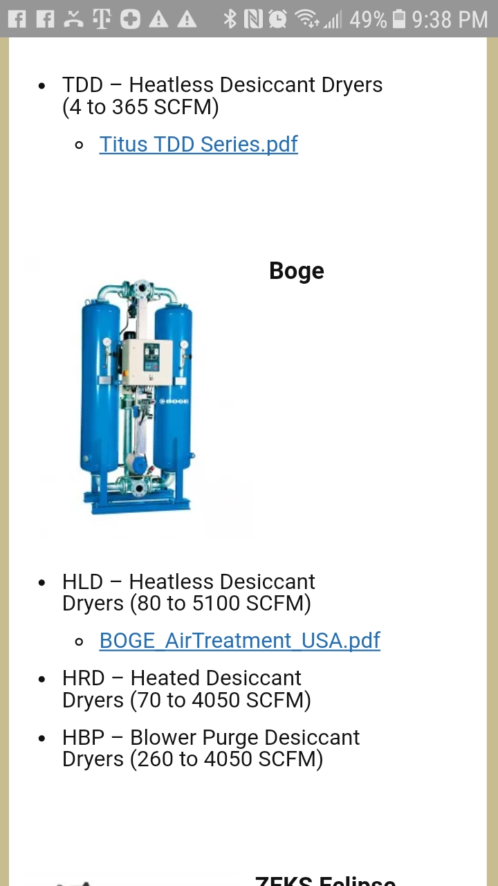

If you go on any vendors site who sells air compressors , filtration and Air dryers you will never see the molecular sieve filter dryer all these airgunners are using. Those thing are for removing water from solvents in a lab under a fume hood we have plenty in the labs never used on aircompressors
I am definitely no expert in air filtration but I do have seen many compressor shops selling filters that use molecular sieve to remove moisture. This is just an example : https://www.coltri.com/en/products/consumables/
