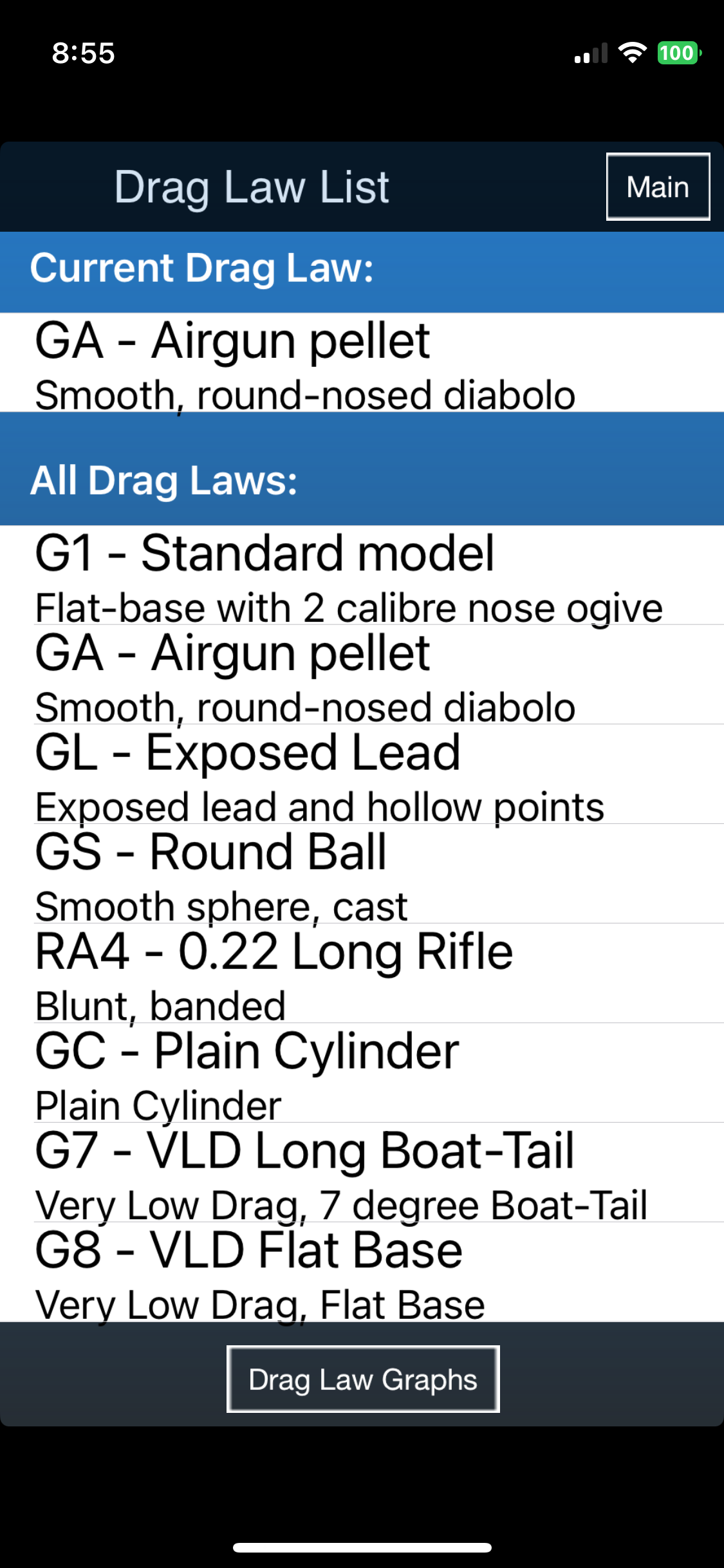

Another thing: the Pyramydair and AOA versions have no selection for the drag model. So I would assume that they were intended for GA pellets only. The old ChairGun app solves for a number of drag laws, including G1, G7, G8, GA, GC, GL, GS, and RA4.
Testing, I see no difference between GA and G1
Same distance/muzzle values from above post, but at sea level opposed to my elevation:
GA/G1 = .0492 diabolo pellet/standard model
GL = .0496 ?
GS = .1334 (smooth sphere)
RA4 = .0504 (long rifle?)
GC = .1805 ?
GI = .0519 ?
G7 = .0265 boat-tail?
G8 = .0461 ?
GU = .0457 ?
Any clue to the others purpose? Might reverse calculate a few more for a giggle if I am bored later.

G1 and GA are very close to each other at typical airgun velocities. They deviate a little from each other at very low velocities. Neither is very accurate in the transonic range as you get above 900 or 950fps. G1 is used by some airgun slug manufacturers. GA is used by some airgun pellet manufacturers. That’s makes for a convenient way to compare airgun slug BCs with airgun pellet BCs.
RA4 works well in the transonic range for rebated and boat tail slugs that are up to two or three calibers long. G7 is probably a little better match once you get much over three calibers long. The value scales of RA4 and G7 are so much different than G1 and GA, that you can’t compare them directly. But there are conversion formulas:
