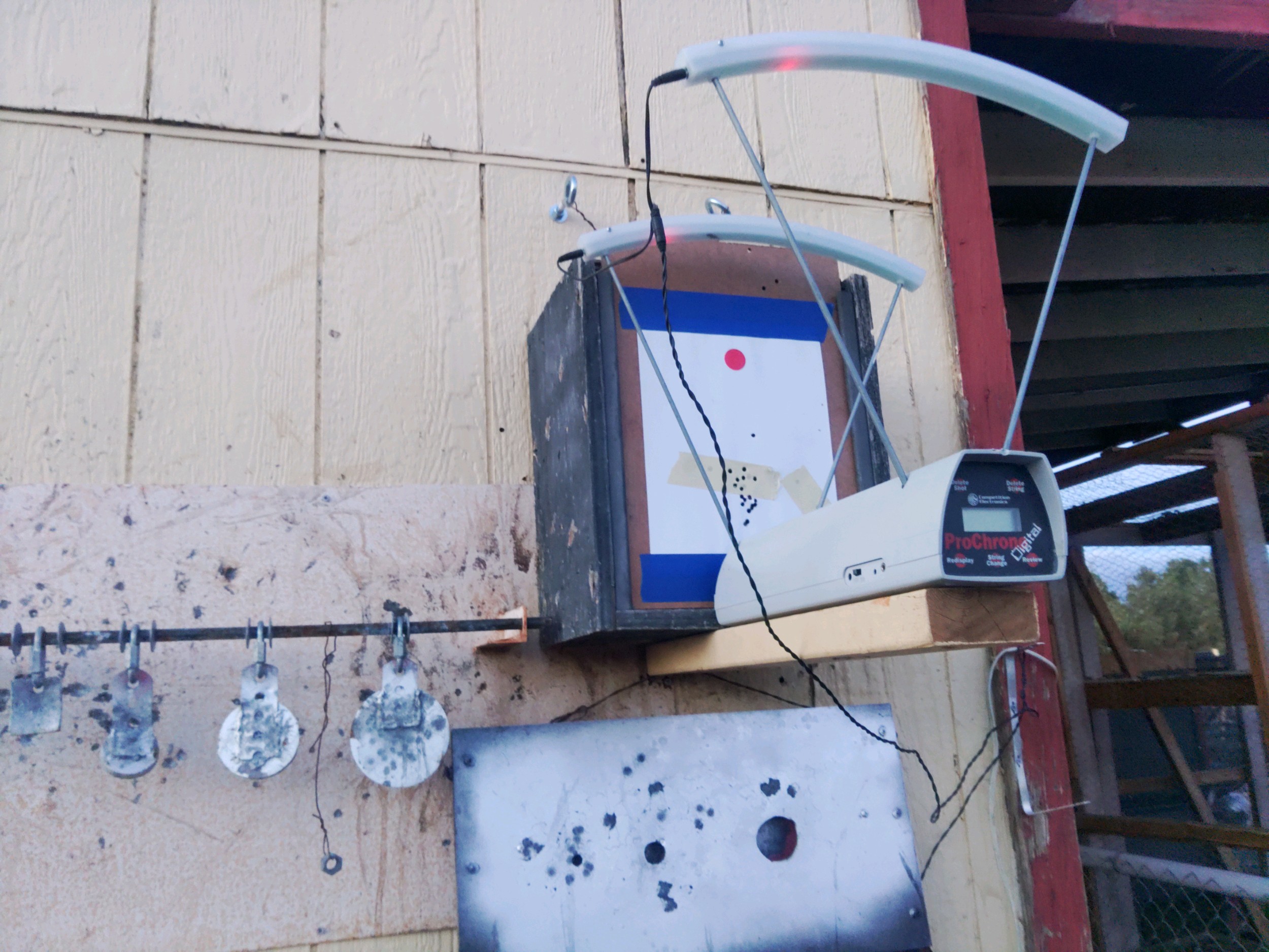

For the past several weeks, I've been having a hard time trying to match my measured drops of my .25 Vulcan shooting NSA 33.5 out to 200 yards to Strelok. I would adjust my 10 to 100 yard's drops to match but my 100 to 200 yard's drops would be off. The reverse would happen if I adjusted my 100 to 200 yard's drops. I finally decided NSA's BC was not right for my Vulcan and my area. I decided to setup my chronograph at 50 yards and shot a 20 shot string. I then I did another shot string at the muzzle and used Pyramyd Air's BC calculator. I also used AGN's BC calculator and got a slightly different number. Now my Strelok and my drop measurements match using Pyramyd Air's. I don't know why I haven't done this before with all my projectiles. I tried using my Labrador a few times to get my true BC but every time I used it, I wanted to use the Labrador as the target. Has anyone else done this to get their true BC?
