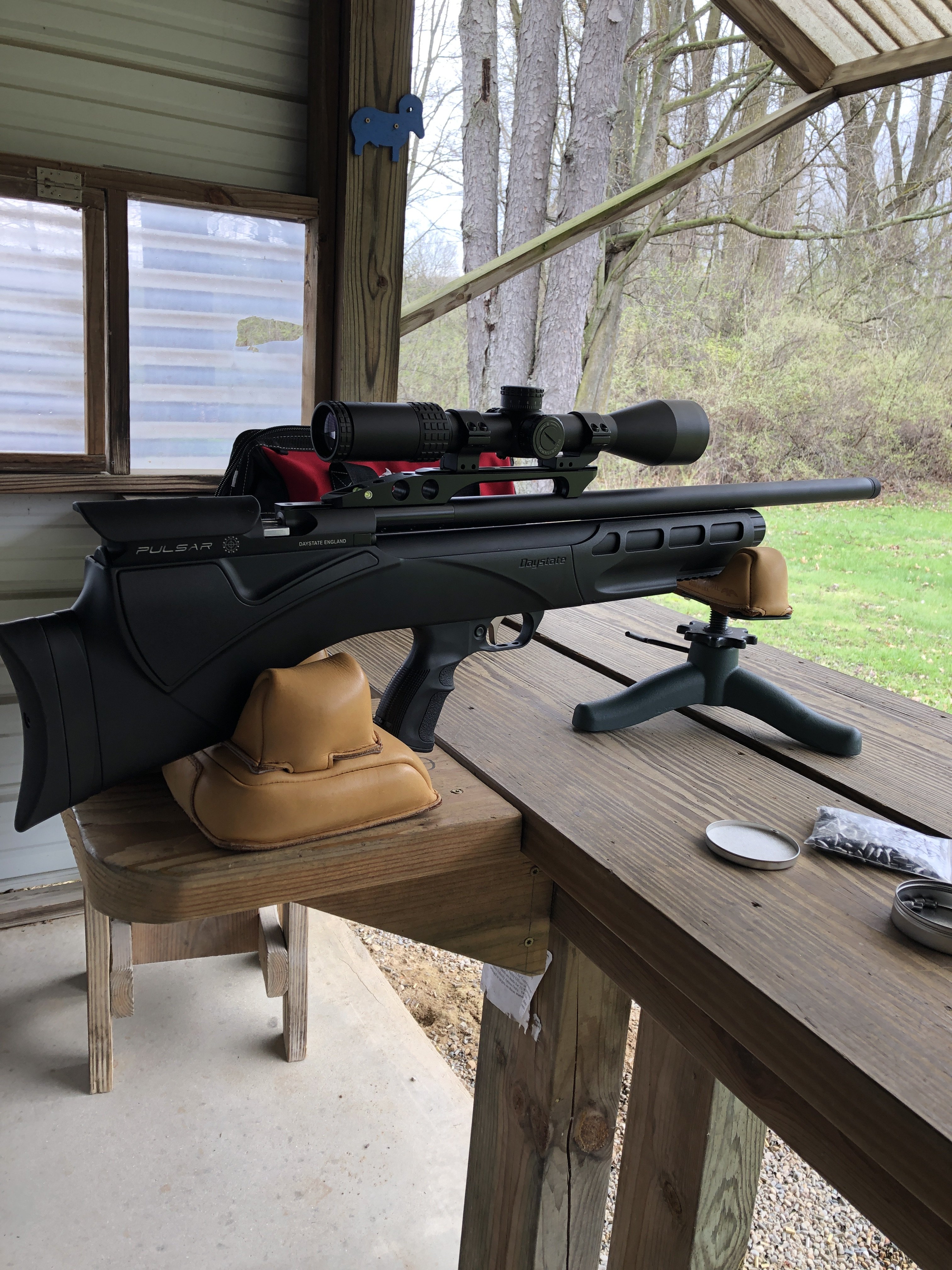

The biggest issue with a Caldwell chronograph is consistency. I have the rifle level and on two bags. The chronograph is about a foot away and about two or three inches bellow the barrel. I use the bubble level on the tripod to make sure it is level. I aim the rifle in the middle of the chronograph's sensors. I do not "aim" when I am using the chronograph. Rather, I make sure everything is level and even and pointed at a safe backstop. Then I shoot over the chronograph making sure I stay centered and level.

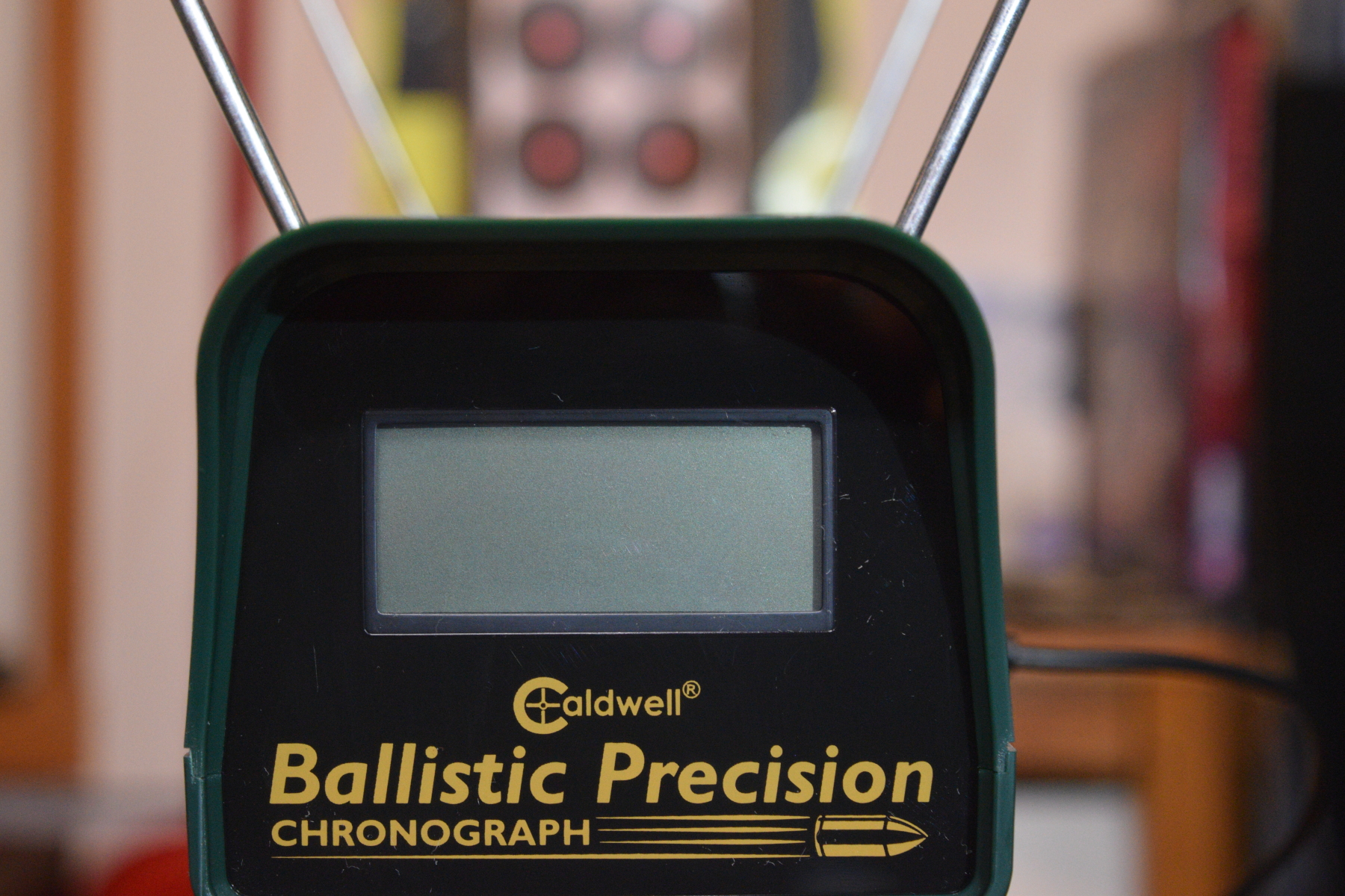

it didn't take long to come to the conclusion that i really didn't need a chrony for #backyardplinking and sold it.
Here is a string from my Caldwell. No issues with this string. Works like a champ.
