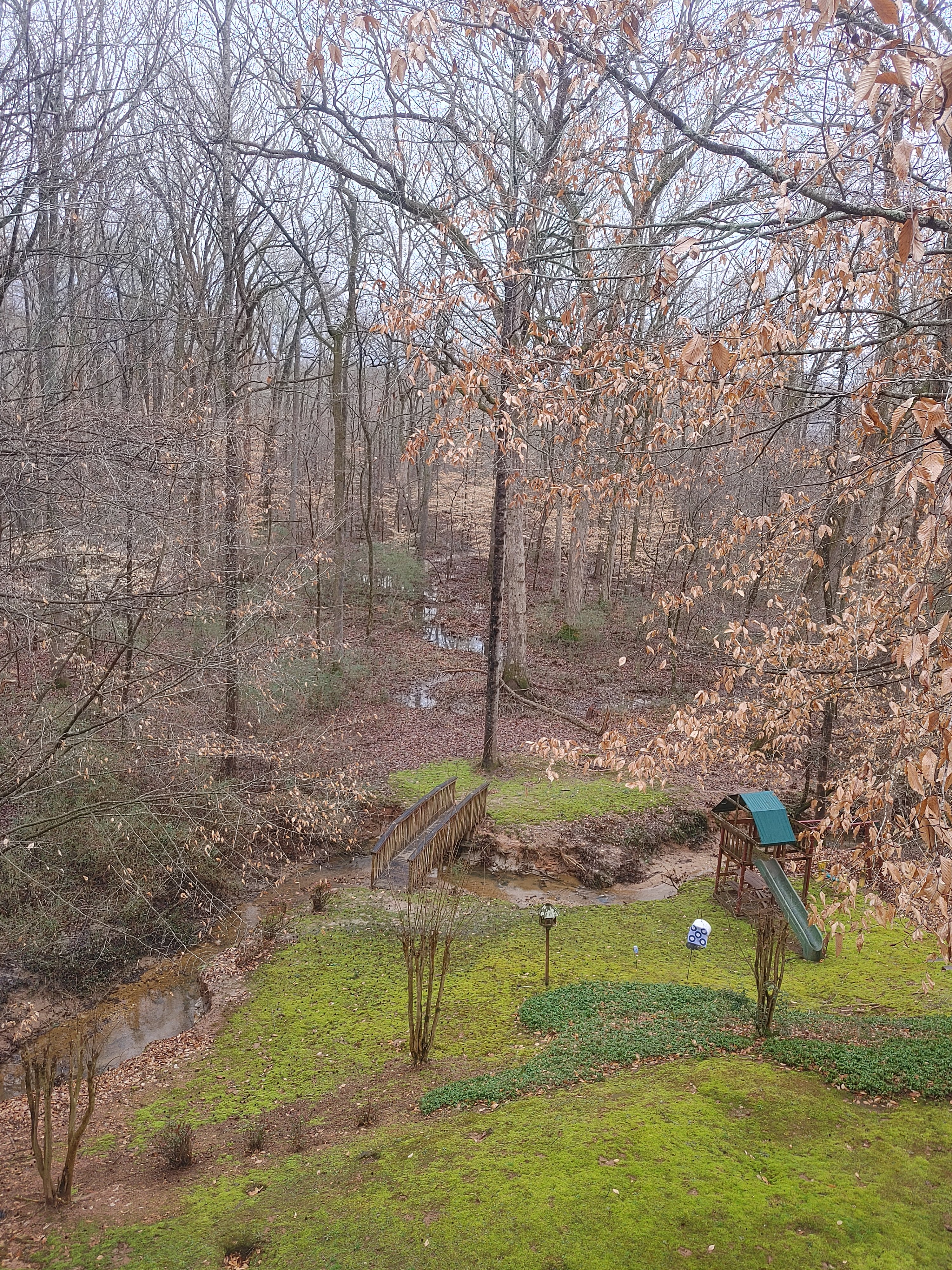

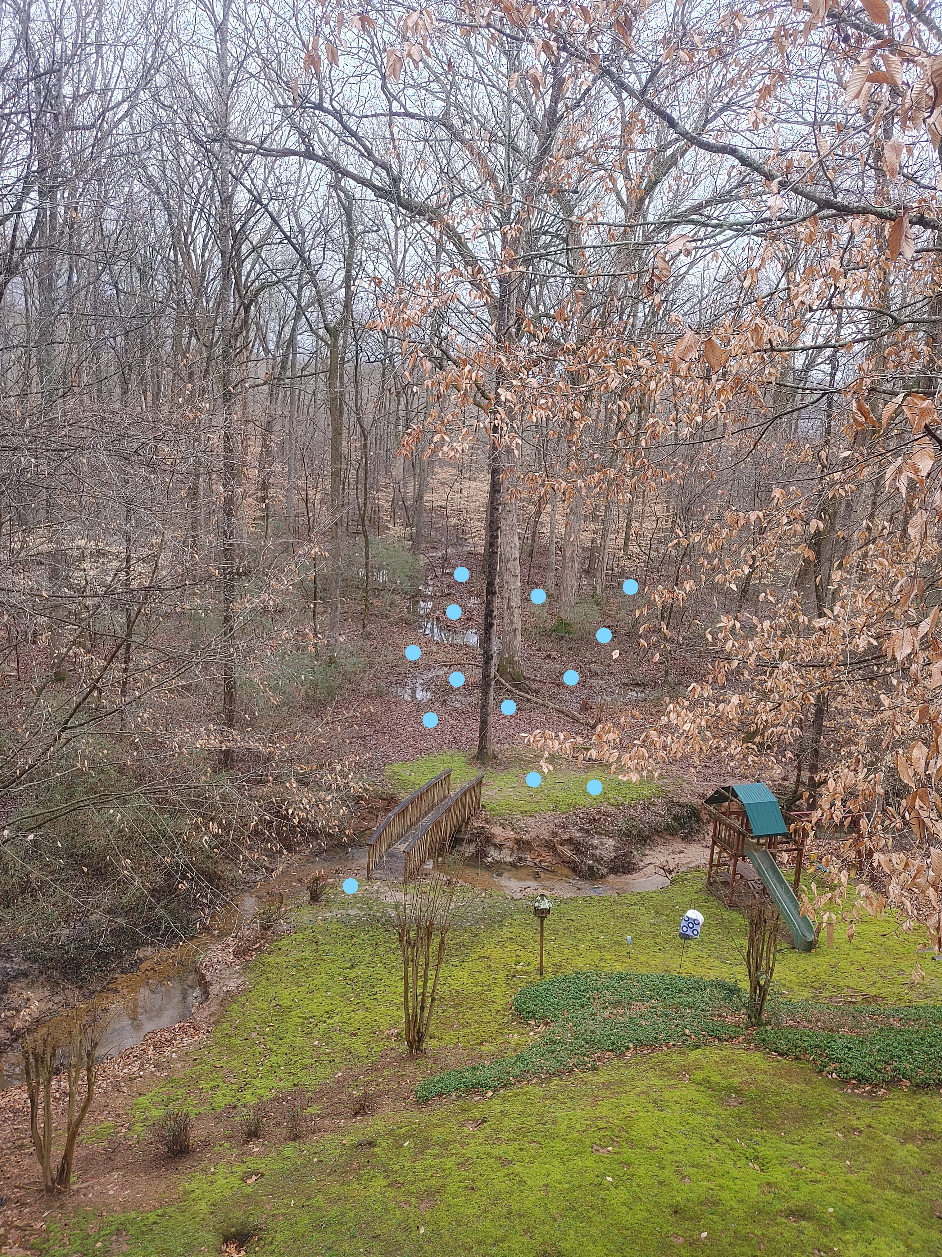

Ill be shooting from my deck and its about sixy yards to that large oak in the back across the creek. I could go considerably farther back though. Its a flood plane so no houses behind.
Ill probably be shooting anywhere from 25-100yd for the majordy of shooting.
Im definitely leaning more twoards a .22 or possibly.25 though.

That is a nice yard/range! .22 pellets will work absolutely fine. If you're even remotely decent at reading wind you won't have any issues at those ranges with a PCP. Ive shot reasonably decent groups at 100yds with a sub 12ftlb .177 springer so a .22 PCP should be a cake walk for you. 25 cal definitely has its benefits though. At 900fps a 25.39gr or 33.95gr .25 pellet makes 100yds pretty straightforward.

nice to have a yard that size , i have a 70 foot cliff down to the water .

.25 Cal for making honor to that beautiful place and to make clean kills of it’s invaders !!

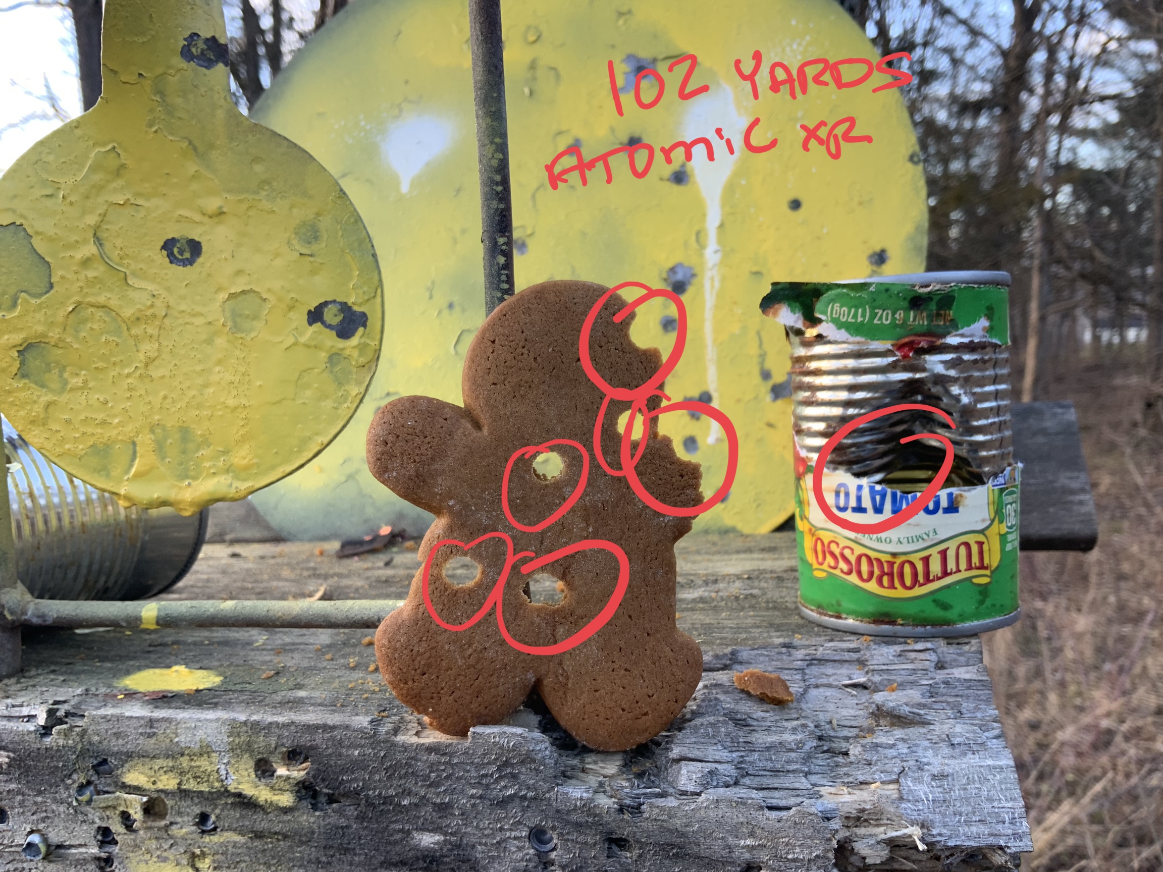

I am fortunate in that I can shoot my airguns out to 102 yards. I do all my plinking with the .22 caliber. I plink cans at that 102 yards with a 17 FPE, .22 PCP. Over 3 feet of drop! 11 MILS of holdover and unless very calm? Hold off for wind too. Do I hit them every time? Of course not, but often enough to apply what I learn at shorter ranges. Yes, the wind can blow them around out there. But I’ve also gotten much better at making consistent, consecutive hits in the wind. That’s been one of the sweeter aspects of shooting airguns for me. I gotten very good at holdovers and hold offs through thousands of pellets down range. The bulk of my plinking/pesting/shooting is from 25 to 64 yards. Go .22 then if you decided to progress to pesting or hunting? The .22 within reason will handle that too. .177 is hard for me to handle the smaller pellets. My 102 yard station.

Your backyard reminds me of Dr. Russ' back yard. He says his wife shoots from inside their house, out the window. From the looks of this photo, seems you could probably do the same thing if you so desired.

the first thing i thought when i saw this picture View attachment 331834was Field Targets
Yeah I want to setup various targets at various yardages. In the summer the skittos are nasty down there.
