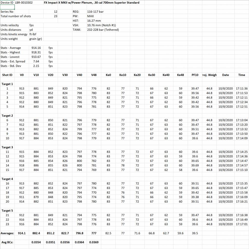

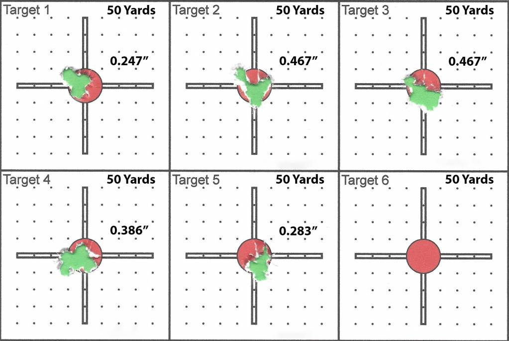

Like has been stated already, this may or may not be useful info to you, as every gun is unique in its harmonics, but here is my data sample as of a few days ago after upgrading to a HUMA regulator and Superior standard liner. I'll also say the HUMA is not any more reliable, but I wanted it for the piston made of metal vs delrin, and the ability to replace just a delrin disc vs the entire expensive piston when I damage it or it just gets too much shaft wear.
SN 193256 Superior Standard Liner Testing  Tuning - 2020 OCT 08.1602437976.jpg
This is what I’ve been looking for...thanks. What do you recommend my regulator to be at for an MK1 Impact in .25 with 600 mm barrel?

Since you are saying MK1 Impact in .25 and 600 barrel I would assume you got one second hand because this one looks like an older model. (what liner is in the barrel do you know?)
Lets start with your numbers, connect a chronograph and give us your existing specs you have right now, also give us a number where you would want to reach.
For sure here will be people to lead you through.
