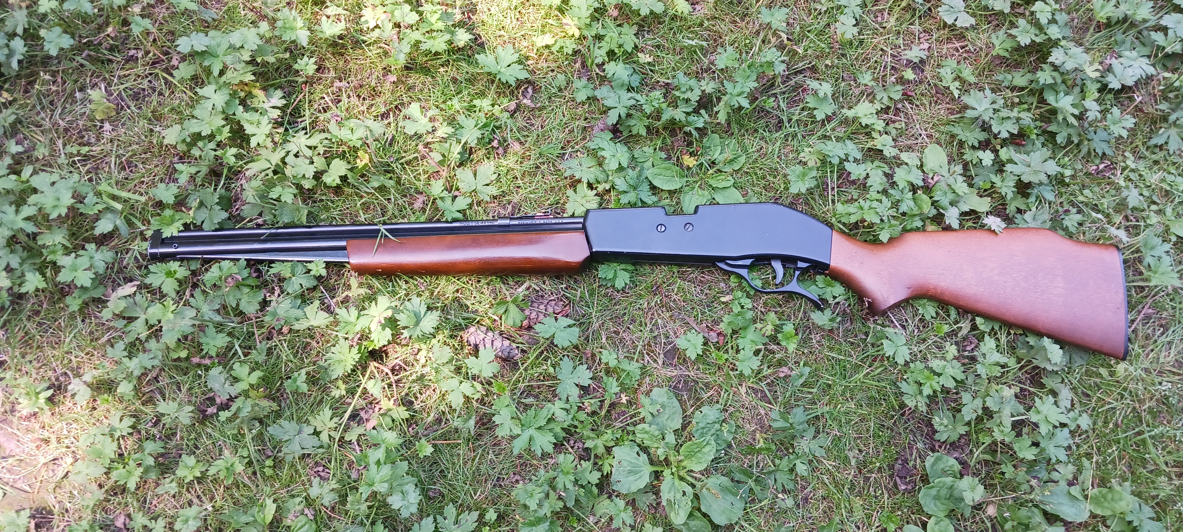

Okay, so I have recently acquired a 91 Blue Streak and a 97 392. Until now my only experience with pumpers has been with a Daisy 880, my first bb gun when I was 11. So they both shoot as they should, but the BS pumps much easier, I can pump it 8 times and it's not too bad. I usually shoot with 4 or 5. Now the 392 is not bad to 3 pumps, but it gets much more difficult than the BS past that. I was shooting it yesterday with 4 pumps and it really felt difficult at 4. I'm no weakling, but I can't imaging pumping this thing 8 times. Is this normal, or can there be a problem that makes it much harder to pump than my BS?,
Also, I have the Williams peeps on both guns, the BS is sighted at 25yds with 5 pumps and the sight is slightly below the center mark. The 392 is almost all the way down and still hitting 2 inches high at 25yds with 4 pumps. Both using a bullseye hold. Ideas?
