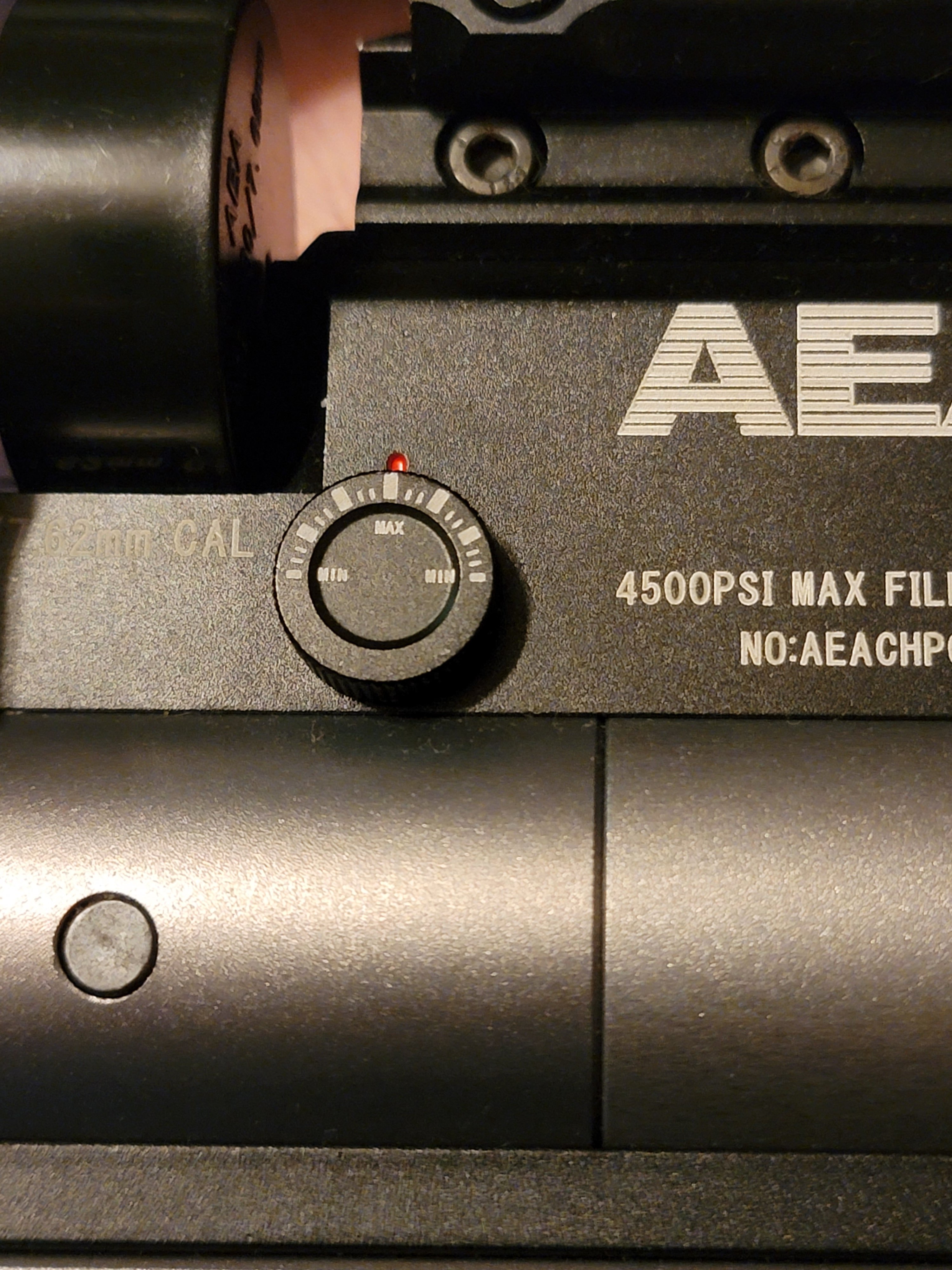

Is this what y'all are referring to when you talk about "turning"?
Is this what y'all are referring to when you talk about "turning"? View attachment 335220
Challenger Pro 30 just like I have... so slightly different instructions vs a regular Challenger with the reg upgrade. But for you and Challenger Pro -- degas the gun via the regulator gauge (unscrew it slowly until air starts leaking, then wait a while). Then you unscrew the tank by hand. Once that's off you'll see a thingy in the middle. There is a fairly large hex head in the center of it. That's what you twist either CCW to increase pressure, 20 bar per 1/8th turn, or vice versa clockwise to reduce pressure.
