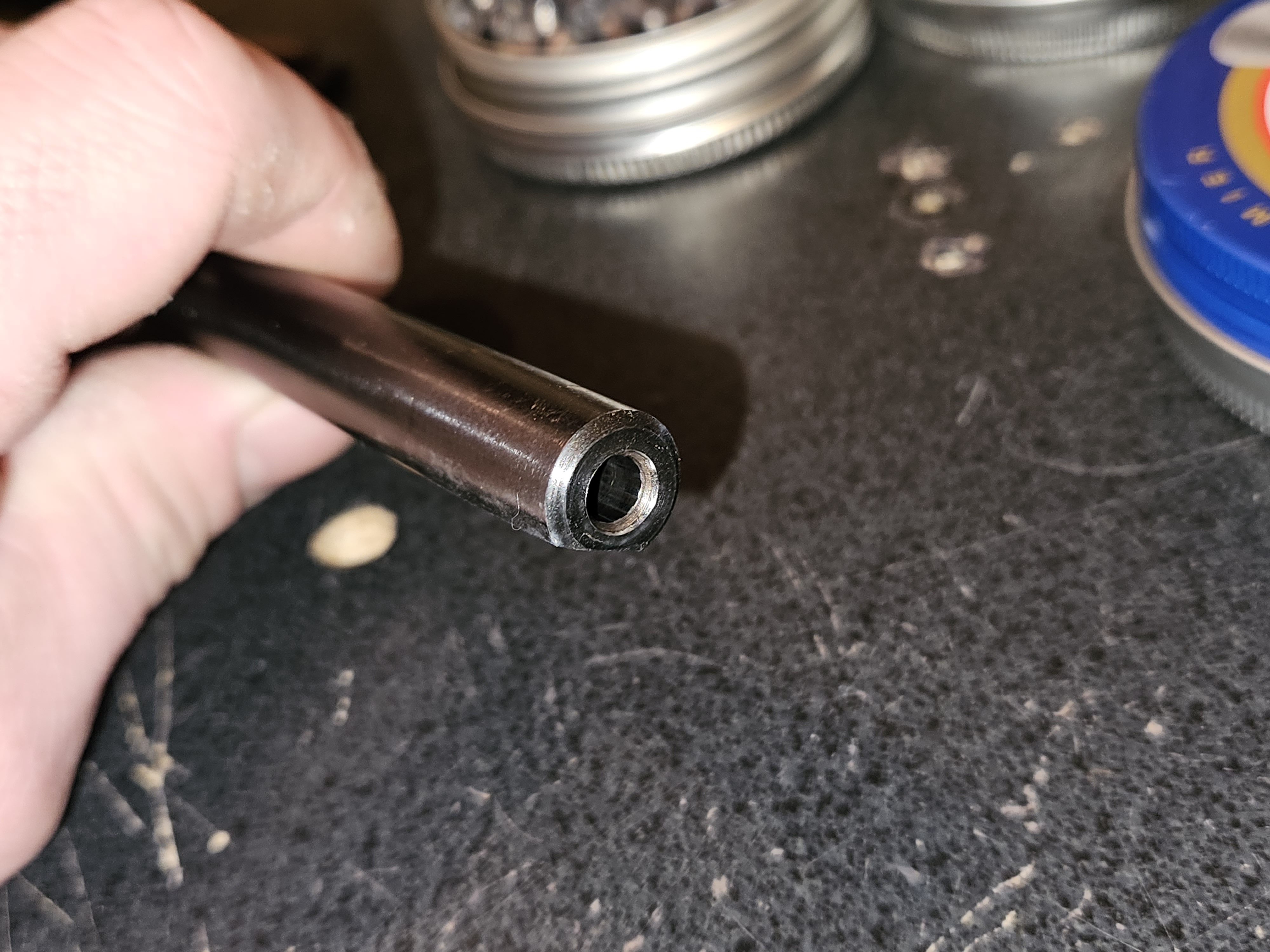

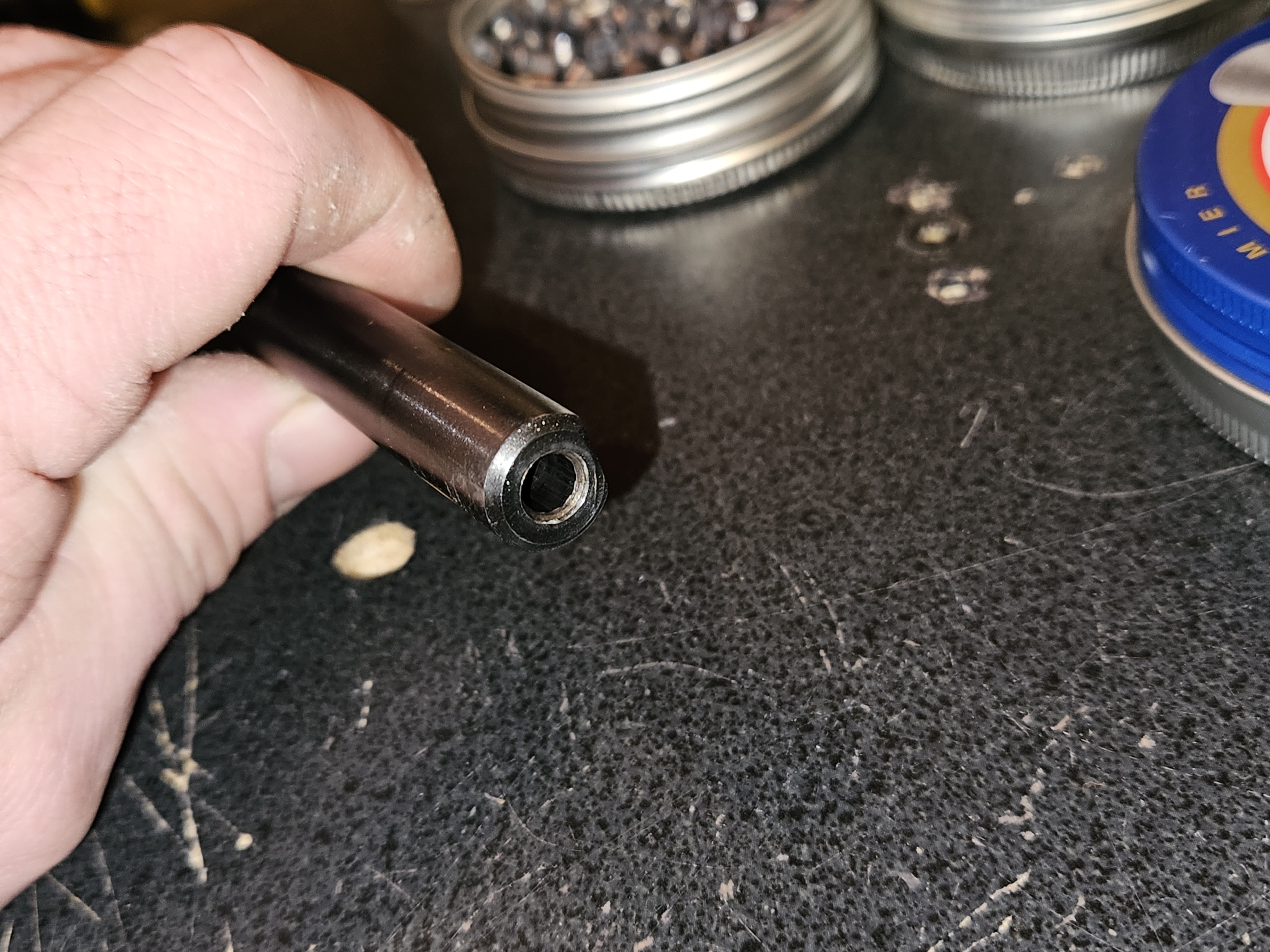

The accuracy wasn't the best to begin with. It was decent, like within an 1" at 20 yards. It was all over past 25. That's why I figured a crown dress and barrel polish would tighten things up. I will check the leade area again, and the crown. The crown is decently recessed so I might need to get in there with a #6 brass screw. It doesn't really appear to have got polished to the lands/grooves, just on the bevel down to them.
Here are a couple pics of the crown and the leade area. I havent touched the leade yet, and the crown was just a quick pass with some fine grut compound and a #8 slotted brass screw.
Yes sir, that's what I was about to say. Looks like another victim of a piloted crowning tool. Every time I see that, I want to strangle someone.
So, you think I can cut it back and recrown? Or just scrap it and move on to my Kral barrel idea? I know it's a good barrel. I'm also thinking of getting a little longer one, the np02 13" barrel. It can always go on one of my other science projects.
You know, that feeling of strangling someone who messed up an already cheap barrel isn't unique to you.....
In fact, historians have reported an increase of mysterious stranglings in China ever since that country started manufacturing airguns.....
Matthias
Reactions: Vetmx
That transfer hole have burrs, and we can also expect the start of the rifling inside lead in. When you inspect with a tip most likely each will pull the hairs.
I definitely see the burr on the transfer port now, and the leade into the rifling is basically just a flat lip vs a smooth cone in. I can clean all that up, but the pilot marks as Jason mentioned are going to still be an issue. I could cut it back a half inch or so and try again. I don't have a bore scope small enough for 22 to check the rifling the whole way, but it appears fine when held up to a light.
Here are a couple pics of the crown and the leade area. I havent touched the leade yet, and the crown was just a quick pass with some fine grut compound and a #8 slotted brass screw.View attachment 420918View attachment 420919View attachment 420920
Yes bigHUN, that transfer port and lead need to be addressed first to not damage the pellet's initial contact with the barrel.
Dr. Kralenstein you are correct, the crown looks like it could be cleaned up more as well.
Yeah that's what I would do. I've fixed a bunch of SPA and Crosman barrels with a chop and recrown, and most of them completely transformed once the damaged portion at the muzzle was removed. But of course there are no guarantees, and since you have another barrel at the ready, my guess is it comes down to whether you are enticed by the prospect of turning a sow's ear into a silk purse, or would prefer to take the higher probability path and repurpose the offending barrel as a tomato stake this spring.
By the way, I agree with bugHUN that the barrel port and leade could use some attention. And it looks virtually identical to the barrel from the Crosman Icon I got a few weeks ago, which appears to come from the same factory as the Beeman Commander, so it wouldn't surprise me if the same factory made your Beeman 2028...exercising the same extreme care to mangle the rifling at the muzzle.

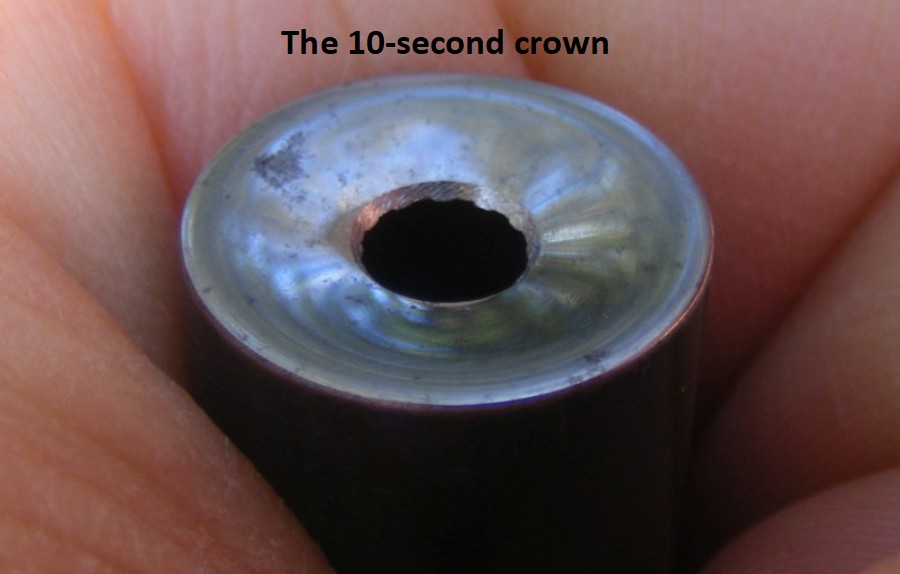

Just for perspective, I wanted to consider the time it takes to repair a barrel that has been damaged by a piloted crowning tool, versus what it takes to apply a "good enough" crown in a rushed production setting...even one tasked with building the cheapest entry level air rifles like the aforementioned Crosman, Beeman, and Diana guns.
So I gave myself 10 seconds to bang out a quick crown. Three (3) seconds with a carbide burr, followed by 7 seconds with a diamond ball:
It's not the prettiest but it's burr-free, showing the distinct profile of the lands and grooves, and no chance of damaging the rifling in the bore. So this is the level of care and attention they seemingly cannot be bothered to give. Utterly shameful.
