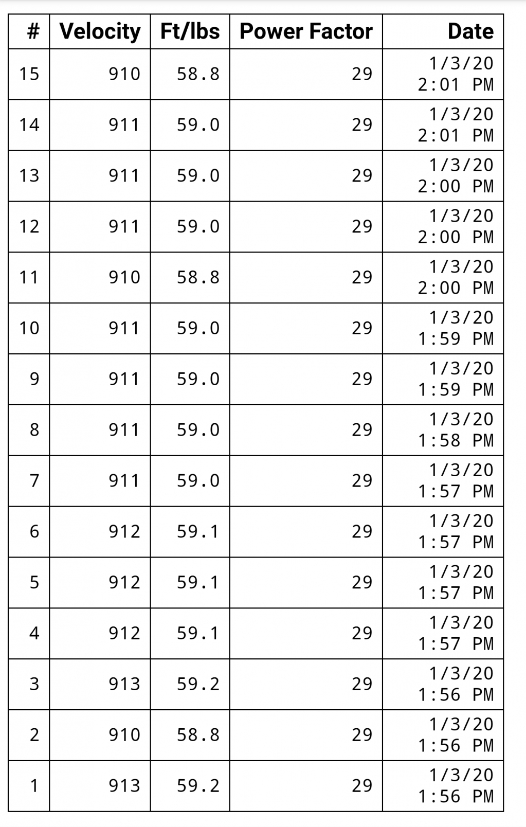

Hi Hisson, I have shoot all pellets in slugliner .22 the only one that is not good is the beast 33.9gn, all all others are good with the right tuning. Hybrids are a bit light, make sense those work ok in pellet liners. Good info!
In regards to the 33.9gn, I had the same outcome as you. I totally agree with the conclusion of light slugs/pellet liner and heavy slugs/slug liner with regards to the mentioned weights. Currently I shoot 25.39 jsb at 980ish at 130bar. HST Max. 138bar I shoot 32gn slugs at 911ish.
1579003282_20571909115e1dad92028142.11956775_Screenshot_20200114-035937_Digital Link.jpg
This has definitely been a fun ride so far.
