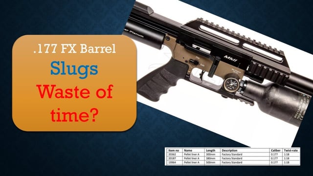

In my experience, the chokes are too tight in FX barrel liners and they build up lead fast. The tight chokes also slow the slugs down considerably. Watch this video.
I'm going to watch the video, but I believe the newest superior X barrels are made to accommodate

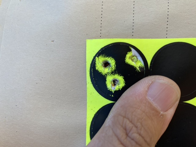

This is shot with my crown with 500mm 177 barrel so impact can do the same thing if tuned correctly. This is 0.54 inch at 100 yards, stick with 12.5 NSA and 13.5g KO at 900ish fps.
