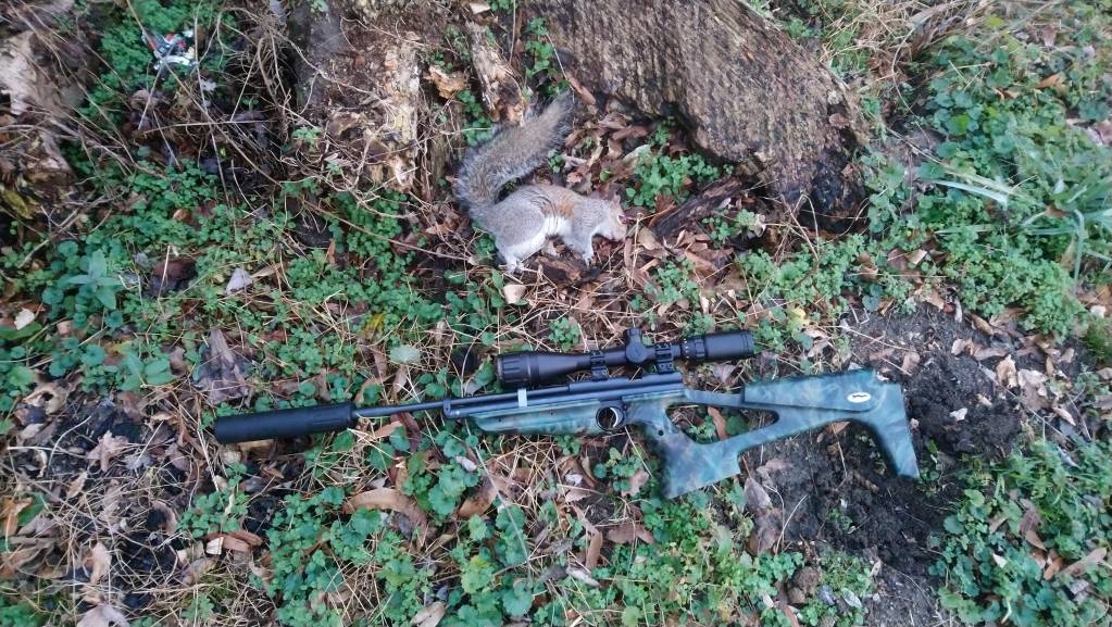

It's as though it was made for the 1701P too see picture. RenoTwolf. I don't have pics for any of mine. Here's a link.
