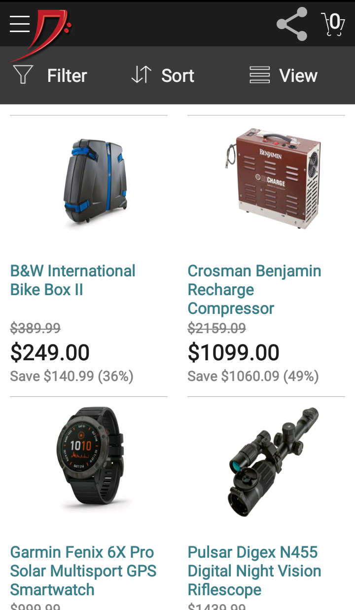

I continued to use my existing Benjamin ReCharge. About the same price point as the Hill (I paid a little under $1,300), but it now has just shy of 28 hours on it and I have only done 2 oil changes and 1 internal filter change. I use it to fill guns directly, along with my 100 cu in and 6.8 liter bottles.
Like I said above I only fill until it reaches ~65C and then de-pressurize it and let it cool down. IIRC it has an automatic shut-down at ~95C, or after 40 minutes of continuous operation. So I definitely baby mine. But I'm not in any big hurry, so why not?
