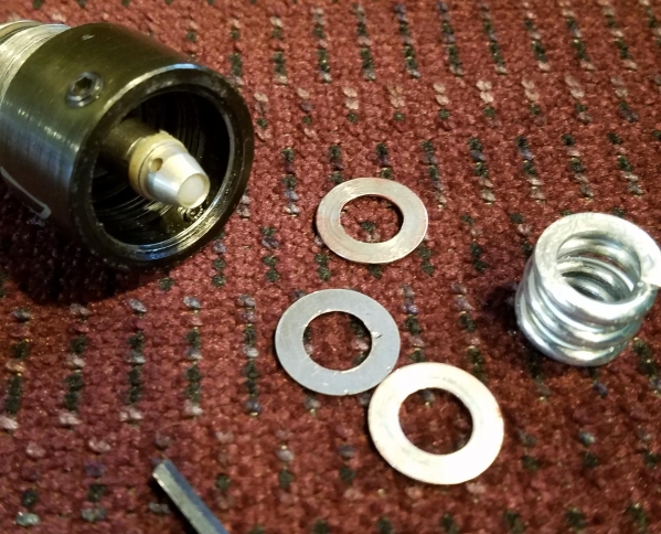

Just to add my two cents. I bought an ninja air tank and it was a 4500psi regulated to 900psi. After playing for a while I found the stock washers, 2 washers more and a new burst disk. I also added a new oring. And it know gives out 4500psi. I would not recomand doing this because of safety issues.
