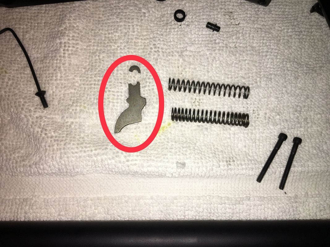

Can this be repaired?

Thanks guys for all the good answers, My problem is the gun is pretty much as new other than the broken part. I just find it hard to toss it.

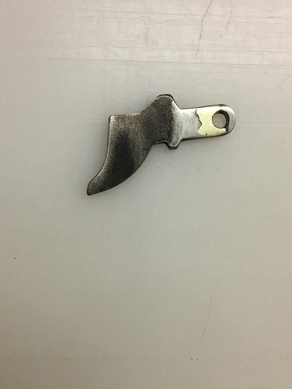

I can't see what that part is but if it's steel (cast steel?) it could probably be sweated with silver solder and be quite strong again. Has to be a fresh break with absolutely no corosion or oil contamination. The solder process actually exchanges some molecules with the steel and makes a bond stronger than the solder itself. Silver solder, not silver bearing solder.
Having it properly silver soldered would probably cost as much as or more than a new gun.

The way I think is. It’s already broke. So what do you have to lose by trying to fix it?
I’ve been silver soldering gun parts for years. Am I an expert? Absolutely not. Sometimes it works some time it does not.
One way or another you will be learning something.
I broke the sear on my Benjamin P-rod. It is an easy to find part and cheap to replace. Less than $20.00. I ordered the new part but it was going to be a week. I could not wait that long to shoot my relatively new air gun. So , I tried to silver solder it back together. 4 years later. Oh yeah I got the new sear. But the one I fixed is still in the gun and working just fine.
Reactions: Frogy and Treefrog
Although I agree it won't hurt to try, and I may at some point do that. I can see the metal is.. and I'm quite sure, made from metal sinterings, which is powdered metal forged together with a blend of metals, there's a whole industry designed around the process. I've actually delivered scrap material to a business in CT. called Engineered Sinterings. Think gears in your kitchen blender or gears in your barbecue rotisserie drive motor. It is a weak metal to begin with and the piece being so small and the location it's in would make it a tough spot to finish to the tolerance need for the barrel to close. I will take some time to ponder on it before I decide how I want to deal with it, it isn't hurting anything standing in the corner for now.
