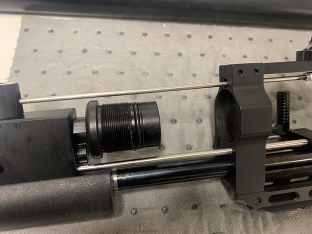

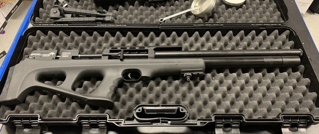

So the original batch MKIII's were using the airtube/cap assembly like on the MKII's so the existing power plenum from 910 worked great. Then FX changed the (not much) later MKIII's to a new endcap/plenum style so that rendered the 910 power plenum obsolete for the newer revision MKIII's. 910 is supposed to have something in the works as that required a redesign. If you have a Compact WC you will need to use a smaller diameter moderator as mentioned above or the extended length of the airtube may hit your moderator, or you can also use a Huggett shroud that also has a built in moderator. That's what I chose to do so my overall length on my Compact is now almost 1/2" in shorter than with the original setup using the DonnieFL moderator. Watch the 910 Airgun Tuning web site and they will have the new ones there at some point.
