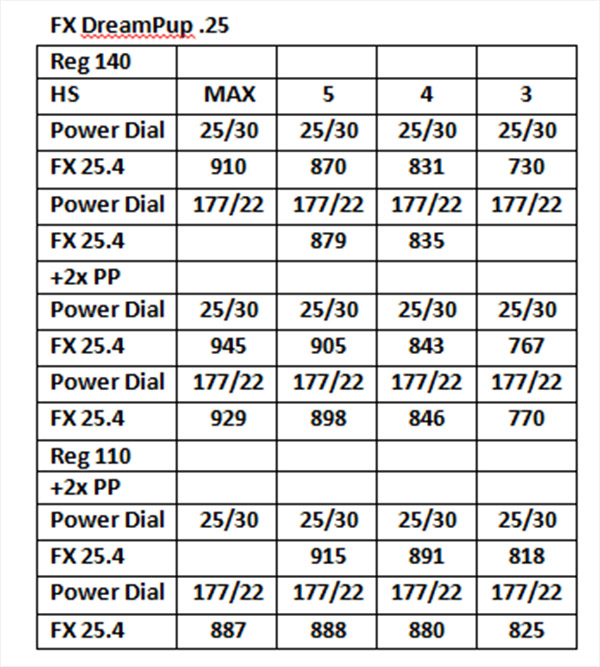

Yes you can. Here are some numbers I got before and after +2 stacked PP's on a .25 cal DreamPup. Leaving the reg set where it was, the +2 PP's gave me a 35fps increase at the muzzle. I then ended up turning the reg down from OEM 140 to 110. With the transfer port adjusted down to the 177/22 setting it gave me the 880 fps I wanted on HS=4, with a very smooth shot cycle and great accuracy. And now my shots per fill went way up since I could shoot down to 110 bar before falling off the reg.
