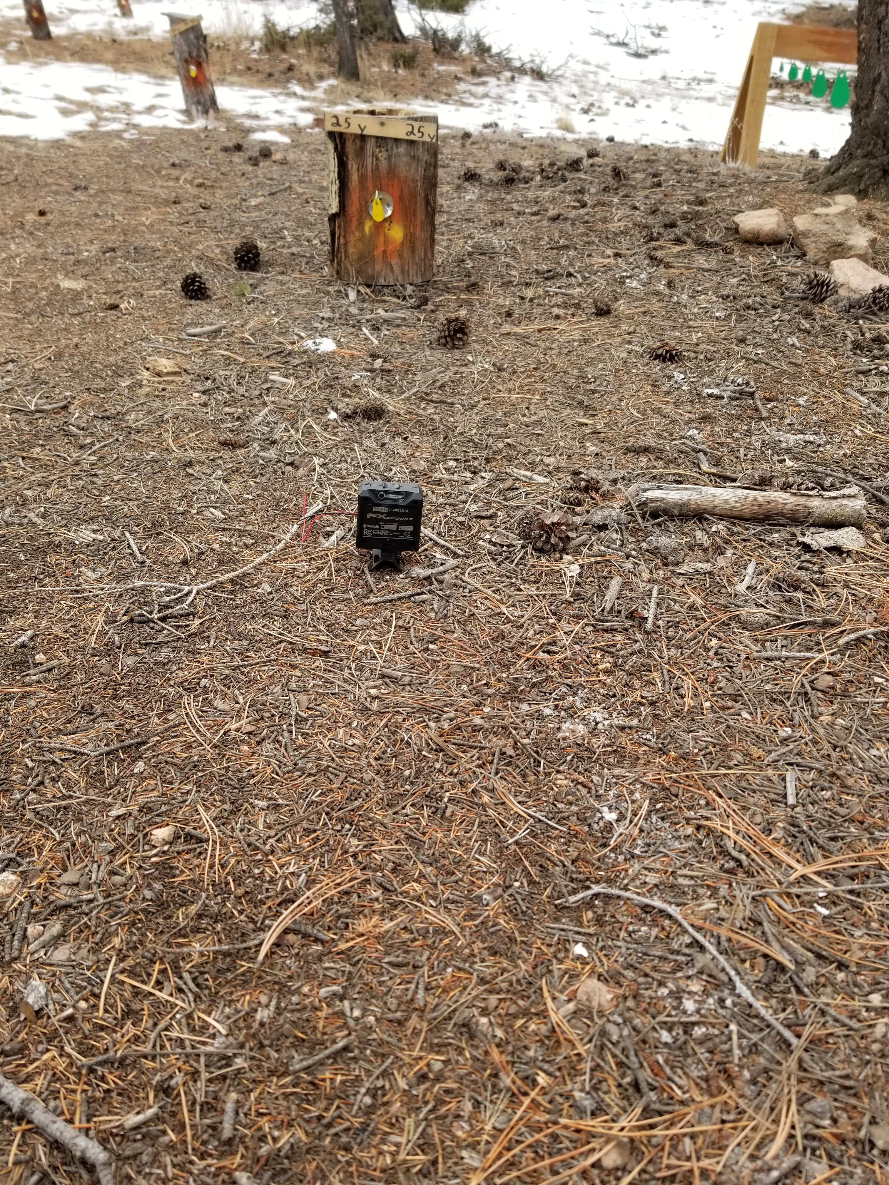

To update this thread, even though I can't spell "FX Chronograph", apparently, you can NOT shoot toward the FX Chronograph and get it to read. It just sits there with a dumb look, not knowing what happened. That said, if you place the Chronograph 3 or 4 feet from a target, it will read it just fine and you can calculate BC all day long. I did it both at 25 yards and at 50 yards. I left my phone out at the distance, but behind a tree or something to make sure it is safe. I'm shooting about 4-5" above the Chrony to get the readings. Here is a picture at 25 yards:
I'm just shooting into my target above the Chrony.

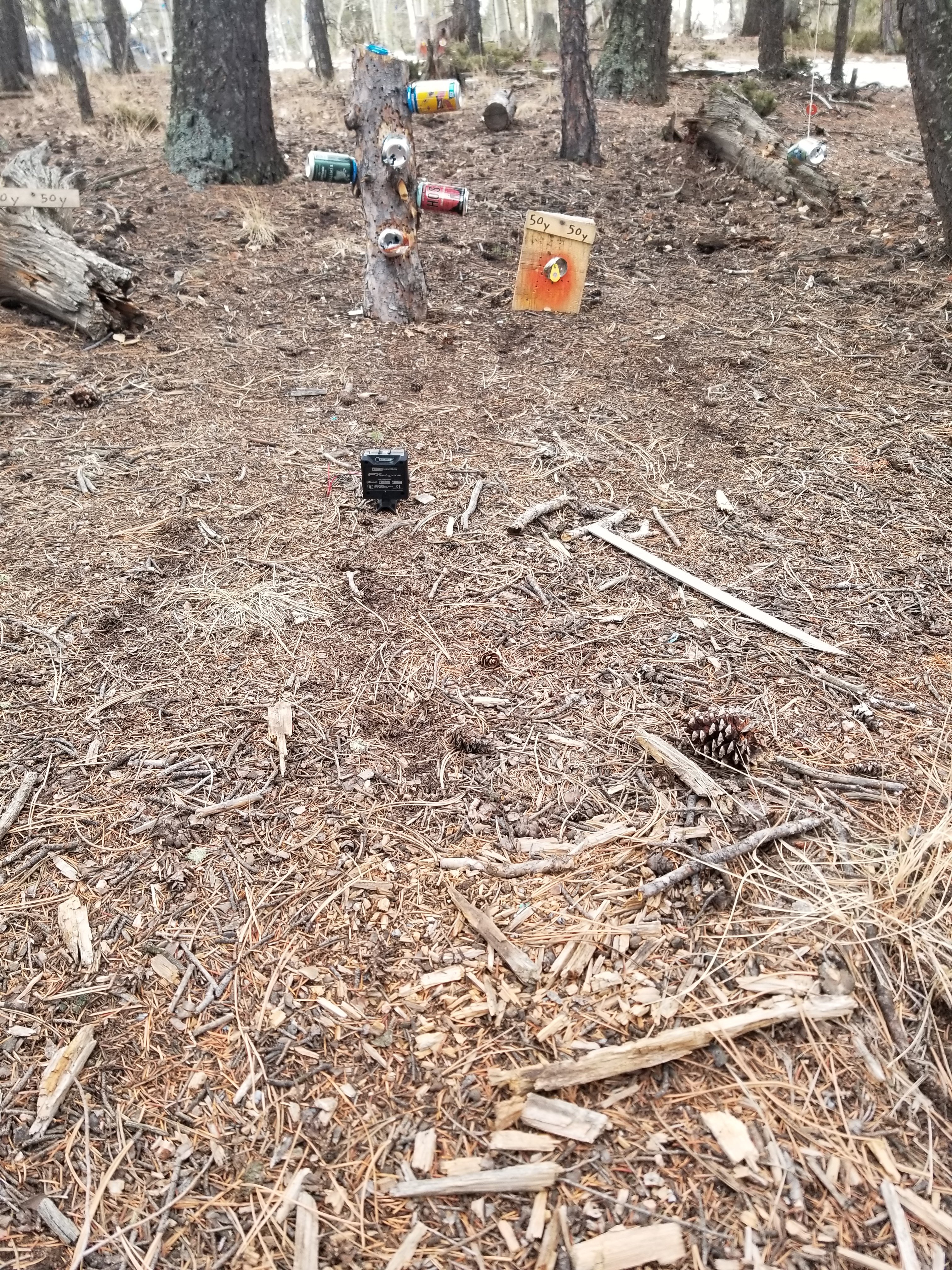

Here it is at 50 yards:
I used the BC calculators on AOA's website at this link.
My results were a little surprising...at least to me. I was shooting JSB 15.89gr Diabolo. I was getting 876FPS at the muzzle, 744.4FPS at 25 yards, and 704.1FPS at 50 yards. According to the calculators, my BC was 0.019 at 25 Yards, and 0.028444 at 50 yards. I was surprised that the BC calculated to be so low at 25 yards. I expected about the same results and thought that the drag was more linear than that, let alone being inverted. Interesting... :unsure: I'm guessing now that the pellet must be stabilizing for the first part of the path, and that takes energy, so that the BC increases as it "finds it's way" and glides along. I imagine that @Ballisticboy or others WAAAAYYY more versed on this subject than I may have more to contribute on that.

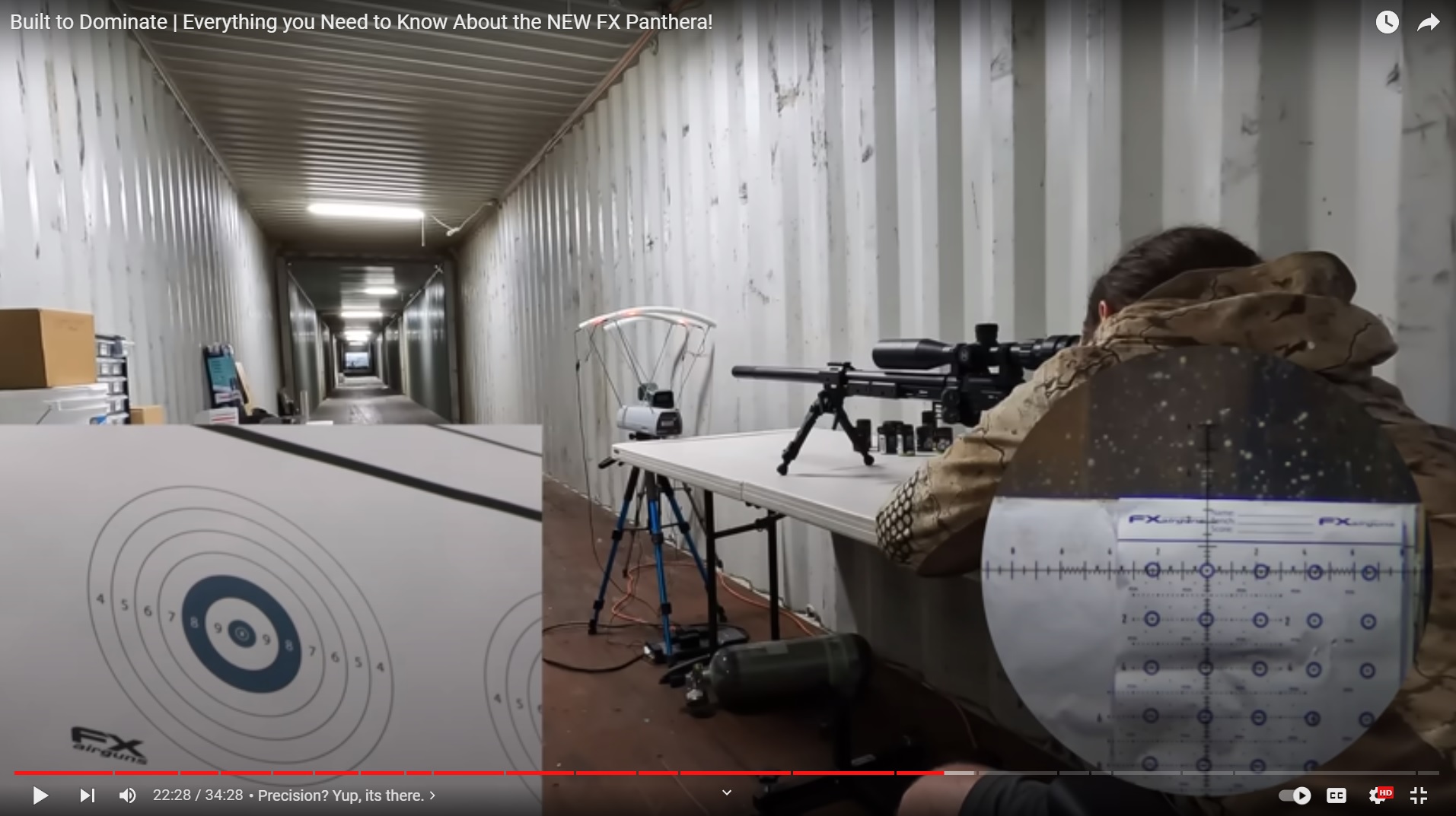

The echo from closed walls or close objects or shooting in a long hall or along a wall will interfere with reading.
Thanks for the input! I've heard something similar. It makes me wonder, though. At the FX facility in the US they have a bunch of shipping containers end-to-end to test. I wonder if they have some kind of dampening material along the route? Matt Dubber shows it a lot in his review of the Panthera, so I'll have to watch that again and see if there appears to be something along the flight path. Perhaps it only needs to be the first few feet?
Do you know why? and what is the difference between these two?
Great point, and none better expressed than by the picture I posted. Makes your point clearly. That is an echo-chamber, so the radar would lose its mind, while the optical system in the Caldwell would be in optimal conditions, out of the sun and all that.
I thought that it was a little ironic to see a non-FX Chronograph being used at FX. We know the reason, don't we?
