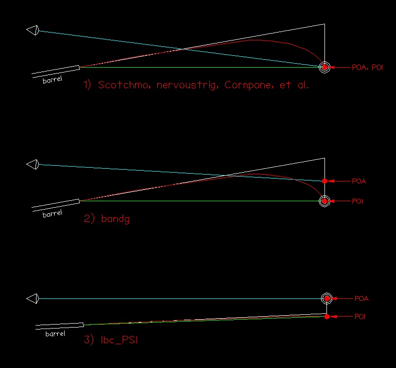

Uh huh, the drawings you are posting are Copyright "Pinwheel Software". So I guess the first question is do you own them? They aren't very good, are they? Can you link the document you are pulling them from because a visit to the site simply shows me they do software for archery "ballistics". I'd like to see what other misinformation the company is putting out.
As for the documents, yes, they're mine. My opinion. Created for this discussion. Yes, I own Pinwheel Software..wrote the software, made the website, one-person shop. It's been a going concern for 21 years. Just to be clear, that was "years", not "ears". ;-) That said, I probably don't know enough about ballistics, drag, wind drift, calculating proper arrow spine, making sight tapes from drop tables to match a shooter's "clickable" target sight..but I am still learning..sigh.
It seems to me the surest way to simplify this problem is to introduce another two or three optical systems before we start to simply DO THE MATH? Because there is NOTHING like half a dozen extraneous variables to simplify the problem, right?
Before the math can or needs to be resolved, we need to start with "why". There's really more than one..but they're connected. Why do scope height and LOB matter?. The picture I think you're referring to is actually one image at different perspectives. The top one represents LOB and two LOS at different heights as viewed from the side..as if there is 0 cant. The bottom two pictures show the original image normalized around each LOS..Scope1 LOS and Scope2 LOS..so laying flat viewed from above..as if canted 90 degrees. The dotted red lines of different lengths are to show that when canted 90 degrees, LOB will not be pointing in the same direction. I could have shown the same thing knowing the angles created from scope1&2 heights and LOB. The inference is..and this answers the "why"..when canting occurs, LOB will not point in the same direction as when no cant exists. The greater the angle between scope and LOB, the more divergence there is. The logical conclusion would be, both degree of cant and scope height effect shot outcome.
As for how good the drawings are? IDK. I think they disprove the main premise of the Szottesfold paper..so I suppose they're good enough. No math required. ;-)

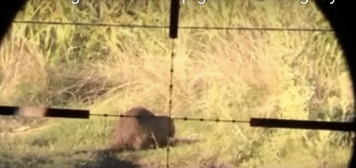

Shooting live targets makes cant more important. Squirrel brains don't grow in size as their distance from you increases. Misses on live targets have consequences.

'... I think they disprove the main premise of the Szottesfold paper...."
Everything I've read here proves Szottesfold. For every scenario that "disproved" it, they started with a POA vs POI error and then induced gun cant. Instead, start out with a coincident POA and POI.

Sure, but the DROP does not change. This is drop from LINE OF DEPARTURE. Line of Bore is the same thing. The projectile NEVER rises above LOB, not ever. At T=0, when the projectile exits the bore it instantly drops below LOB and that drop is a simple Newtonian equation.
I did not say the trajectory rises above LOB.  Duh! Watch the video link and try to understand what the guy is saying.
