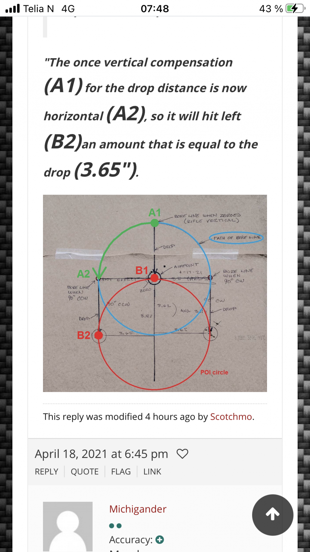

To Scotchmo-I really want to get this resolved. So I would like to have a bit of specificity in exactly what is being stated. I will try to do the same.
The quote directly below is your response to the original Michigander post which I also put below that.
"The once vertical compensation for the drop distance is now horizontal, so it will hit left an amount that is equal to the drop.
Now I believe I see what you are saying you did. Tell me if I have this correct. You first "aimed" at the very top red circle and fired a shot to see where it would hit (impact point circled and labelled "zero") and then you measured from the top red circle to the "zero" circle to quantify your "drop" which you note as 3.82". Then you drew the central circle (labelled aimpoint) around that impact point and used that point as the "aim" point to cant around. Do I have that correct?

"That's not the drop, that would be the POI with respect to the zero. Drop has nothing to do with the LOS. Drop is determined by time of flight, and gravity."
In large part I view your quote above as mostly semantics and I bet a large percentage of people that shoot also view it that way. Which seems to sum up the entire issue. Some have a view based on one method of shooting and others have a view based on a different way of shooting. As another poster noted to me recently, there will probably be no agreement. Both methods can hit the target but they seem to be utilized predominant for generally different undertakings and maybe that is all that can be said.
I'll say the same thing that I've said before. I'll never agree with the generalized statement-"Scope height has no effect on cant error". Never. Because just one instance where such isn't the case negates such a generalized statement. I'm sure in your method (and that of those who agree with you) it is correct. But there are other methods where it isn't correct. And even Szottesfeld conceded such, although he stated that there was only the one specific method where such is true, the method that nervoustrigger also referred to recently (I can't remember the exact term he used but something like artificial holdover).
