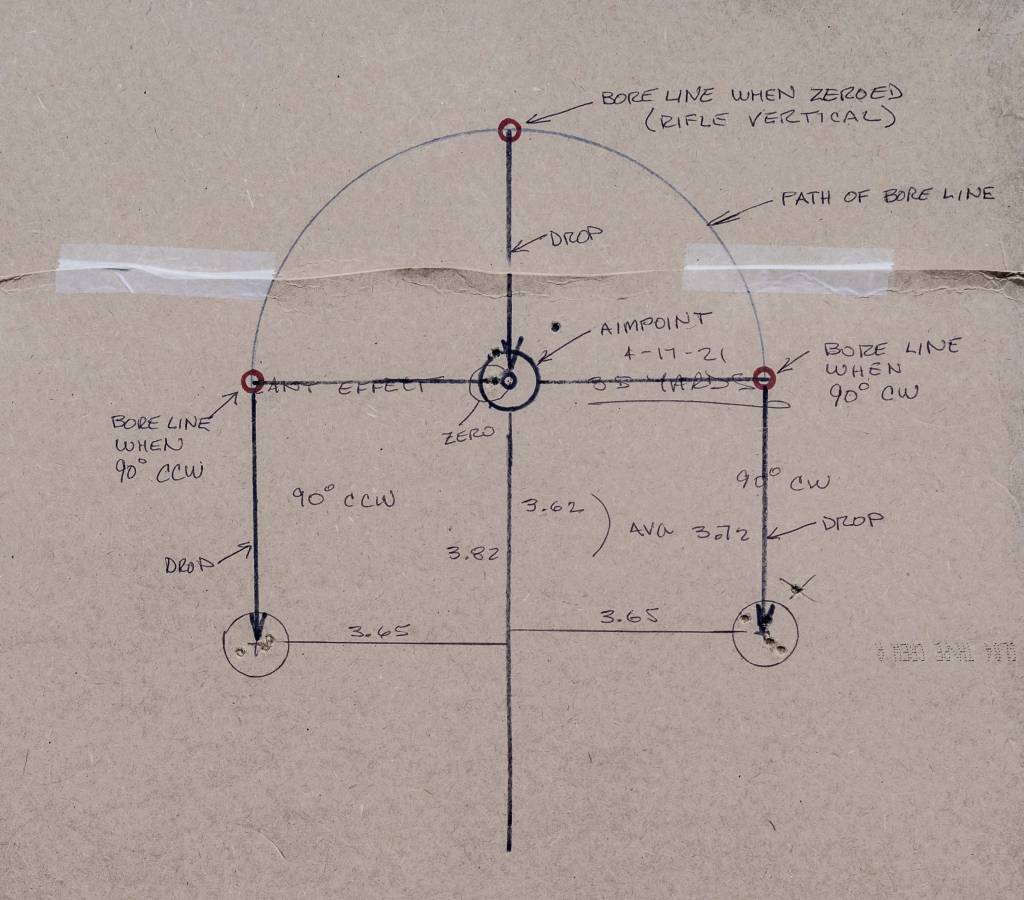

Below is a response nervoustrigger posted to my open sight vs scope photos early in this thread-

scotchmo-"Please diagram the exception so I can better understand what you are describing."
You've basically already done about half of that, but as with every person who holds the Szottesfeld view, you stopped a bit short. That is the FATAL ERROR for Szottesfeld. Go back to your B0 and B90 diagram. Redo that illustration using a SIDE ON view but with a SINGLE PAGE SHOWING THE HIGH SCOPE, BORE, AND THAT CONVERGENCE ANGLE TO TARGET and a second SINGLE PAGE SHOWING THE LOW SCOPE, BORE, AND THAT CONVERGENCE ANGLE TO TARGET. REMEMBER to use a COMMON DISTANCE TO TARGET (the basis for the two zero method). Place the scope and muzzle to the left side of both diagrams and the target near the center. Leave some space to the right of the "target". These separate page drawings are still accurate and still show exactly the same relationships as your B0 and B90 drawings but it is easier to "see" the relationship between the two different heights. It's exactly the same illustration of the relationship, just less cluttered and people can view them more easily. As you've noted in the past, you often view things in terms of bore line while I focus on scope line and that is fine. It doesn't matter because they are connected by the scope rings. Fixed in relation to each other. To me, it is simply easier to "see" the relationship if you keep the scope horizontal and show the inclined bore below. But do it as you wish. Once you have those two pages, lay them side by side and look at them. You will see an angle between scope (you can also call the scope the LINE OF SIGHT or LOS, it's all the same) and bore on each individual drawing. But with each "scope height" set to a common base zero distance (distance to "the target", the ANGLES will be different. The lower scope height will produce a SHALLOWER angle of convergence from muzzle to target while the higher scope height will produce a STEEPER angle of convergence from muzzle to target.
Now the critical part. EXTEND EACH "BORE LINE" PAST THE "TARGET" and across the page to the right. You will observe that, as you get further and further beyond the "target" (increasing range), both lines continually DIVERGE FROM LOS but the steeper angle of the higher sight causes it to progressively be FURTHER DIVERGED from LOS in relation to the low sight line as distance increases. The SPECIFIC SCOPE HEIGHT produces a SPECIFIC CONVERGENCE ANGLE. DIFFERENT for each HEIGHT but specific to each. BEYOND the target, the CONVERGENCE becomes DIVERGENCE (simple geometry).
Now imagine firing a pellet from the LOW scope height setup using a perfectly vertical "gun cant" (meaning no cant is present). Assume 20 YARD ZERO. With the low sight (assume 2") and at 20 yards, the pellet "rises" (in relation to LOS, absolutely not in relation to gravity, common sense) exactly 2" to hit the target. BEYOND the target, it "rises" a bit more (again and as always, in relation to LOS) as gravity continually works to pull the pellet DOWN and now back TOWARD LOS. Assume the pellet manages to rise 1" above LOS before gravity halts the "rise". The pellet then continually "falls" (constant gravity at work) as it travels until it AGAIN crosses LOS. That is the SECOND ZERO for the LOW SIGHT, and assume it is at 40 yards.
To continue, now imagine firing a pellet from the HIGH scope height setup, still using a perfectly vertical "gun cant" i.e. NO CANT. Same as before. But now assume the scope height is 4" (the higher scope). That pellet "rises" (as above, in relation to LOS, not gravity as that isn't possible) exactly 4" to hit the target. BEYOND the target, that pellet "rises" a bit more as well but just a bit more than the low scope due to the ANGLE. Assume it manages to "rise" 2" above LOS (remember, the low sight only managed to "rise"1") then as always gravity continues to pull it DOWN and back TOWARD LOS. But because it has risen a bit higher and is travelling at about the same velocity, it "travels" a bit further until gravity (always there, always a contant") pulls it down to again intersect LOS. That is the SECOND ZERO for the HIGH SIGHT. But it is at a bit longer range because it "rose" a bit more above LOS. Assume the second zero in this case is 50 yards.
Last step. We are going to hold both "guns" vertical (0 "gun cant", not canted) Now aim the crosshair of the LOW SIGHT at the center of the "target" at the second zero distance (remember, it is at 40 yards). Shoot and you hit dead center. Because the pellet "rose" a bit above LOS and fell EXACTLY back onto LOS at that second zero distance. Now CANT 45 degrees in either direction. Doesn't matter which direction but lets assume a CLOCKWISE CANT AROUND THE LOS. WHY DO I SAY CANT AROUND LOS? Because when we shoot, we aim with the scope, or the open sights, or a red dot. That is the LOS. EYE to "SIGHT" (whatever it is) to TARGET. ALWAYS a STRAIGHT LINE. We DO NOT aim with the bore. Bore and LOS are connected physically, but we AIM with the LOS. AND it doesn't matter what particular TYPE of sight we use. They only vary in PRECISION. ALL are adjustable. Back to taking the shot. When canted and shot, the LOW setup will hit LOW and RIGHT with the CW cant direction. GRAVITY determines how much it will DROP. Always a constant, always working. But how much it hits LATERALLY is determined by the ANGLE OF DIVERGENCE and measured NOT from the bore BUT from the 20 yard base zero distance. WHY? Because that 20 yard distance was SET by the common zero distance for low and high scopes when we set up the two DIFFERENT HEIGHT SCOPES and sighted both in at 20 yards.
But now follow the same process as above with the HIGH SIGHT setup. Shoot "level" (again 0 "gun cant", not canted) and the pellet still "rises" above LOS (but it still "rises" a bit more than the low height setup AGAIN due to the angle). But the SECOND ZERO for this setup is 50 yards and that is the "target" distance that we are holding dead center on to hit dead center-50 yards. At 40 yards with the HIGH setup, the pellet is still a bit ABOVE LOS (remember, it "rose" a bit higher due to the angle) but gravity is pulling it straight down TOWARD LOS. At 50 YARDS, it has been pulled (straight down, by gravity) back onto LOS. We aim center with the HIGH SCOPE and hit center, AT 50 YARDS. NOW cant exactly the same as we did with the LOW SIGHT. Same amount of "gun cant". What happens at the 50 yard SECOND ZERO "target" distance? It hits low and right. As above. But because the ANGLE is steeper (from the original setup of HIGH vs. LOW and again, a SET angle for each setup but a DIFFERENT angle DUE TO HEIGHT), the HIGH setup impacts MORE laterally at 50 yards than did the low setup at 40 yards.
All this stuff can be difficult to visualize. Why? Because we are trying to reconcile the functions of ONE straight line (LOS) connected to a SECOND straight line (bore line) at an ANGLE (a SET angle for each SCOPE HEIGHT but a DIFFERENT angle for each SCOPE HEIGHT due to the common base zero distance used at setup for the 2 zero shooting method) all operating under the force of GRAVITY which produces a CURVED TRAJECTORY. But there are a couple of physical facts operating across all of this. GRAVITY works (affects) the pellet only in the vertical plane. It doesn't move the pellet left or right, only down. AND the ANGLE only works in the vertical plane, AS LONG AS NO CANT IS INTRODUCED. So in the uncanted position, we have both GRAVITY AND ANGLE working only in the vertical plane. BUT once we introduce ANY amount of cant, what happens to the forces. GRAVITY is a constant. It absolutely continues to work but only (and always) in the vertical plane. But think about the ANGLE function. As we begin to cant, we take some of the vertical effect of the angle (100% in the vertical with no cant) and transfer it to the horizontal. More cant and more transfer from vertical to horizontal. By 90 degrees of cant (gun on it's side) we have 100% of the ANGLE now operating in the horizontal and 0% working in the vertical. All the while through the canting process, gravity has not varied in either force or direction. IT GETS VERY HARD TO EASILY VISUALIZE THE COMPLICATED INTERRELATIONSHPS.
This statement is false-"scope height above bore does not affect cant error". It is false because it suggests that scope height above bore NEVER affects cant error. Even good ole Szottesfeld admitted that scope height above bore DOES affect cant error, in "certain instances". A shooter can dislike those instances or prefer to shoot in a different manner than those instances, and that is perfectly valid and scope height might well NOT effect cant error for those methods. But that is a PREFERENCE for a certain "instance" (or method) of aiming and shooting and IN NO WAY INVALIDATES THOSE "OTHER" INSTANCES, A person can say that "holding over with the crosshair is an aiming error" but it sure seems odd that if I know the drop for a given distance and I know that a target is at that distance, I can hold over WITH THE CROSSHAIR with no gun cant and I'll hit the target. But using the same method, if I introduce gun cant then I miss the target while "aiming" at exactly the same point. I'll ask a question again that I've asked before, how can anyone state that this is an "aiming error". Even Szottesfeld admitted that this works as I've described, admitting that the miss would be more for a higher mounted scope. This statement is true-"scope height above bore does not effect cant error if you click to zero". Perfectly valid. Because it isn't overgeneralized and doesn't mislead those who are trying to understand the topic into thinking that IN NO CASE WILL SCOPE HEIGHT EVER AFFECT CANT ERROR.
One more thing I want to point out. Go back and look at the photos I posted near the beginning of this thread. Note that I marked then the changing wind conditions during that shooting. I shot the open sight group (a LOW SIGHT but relatively high on the LGV as it's open sights are pretty high off the bore) first and in more calm conditions with a low value left to right wind and saw a given lateral movement related to a given amount of cant. CCW cant producing a lateral movement to the left of POI in a lighter wind. Then note that by the time I remounted, rezeroed, and shot the group with the HIGHER SIGHT (the scope but not a particularly highly mounted scope) the wind value was still from the left but had increased noticeably. Again a matching CCW cant moving the group to the left but in a noticeably higher amount of wind from the left. Just how much a wind can move a pellet has been discussed quite a bit recently. It can be a larger amount than expected. This lessened the amount of cant error that the scope produced because the cant error was trying to move impact left and the higher wind was pushing it further back right than the lower value wind had for the open sights. There was a clear difference in lateral movement in the two but I believe it would have been even more if conditions had been calm or even as least the same. Any testing of these setups must be done in calm conditions to be easily viewed and at the very least they should be consistent conditions.
As to dismissing open sight vs. scope comparison, one should at least thoroughly evaluate what I wrote above before doing so.

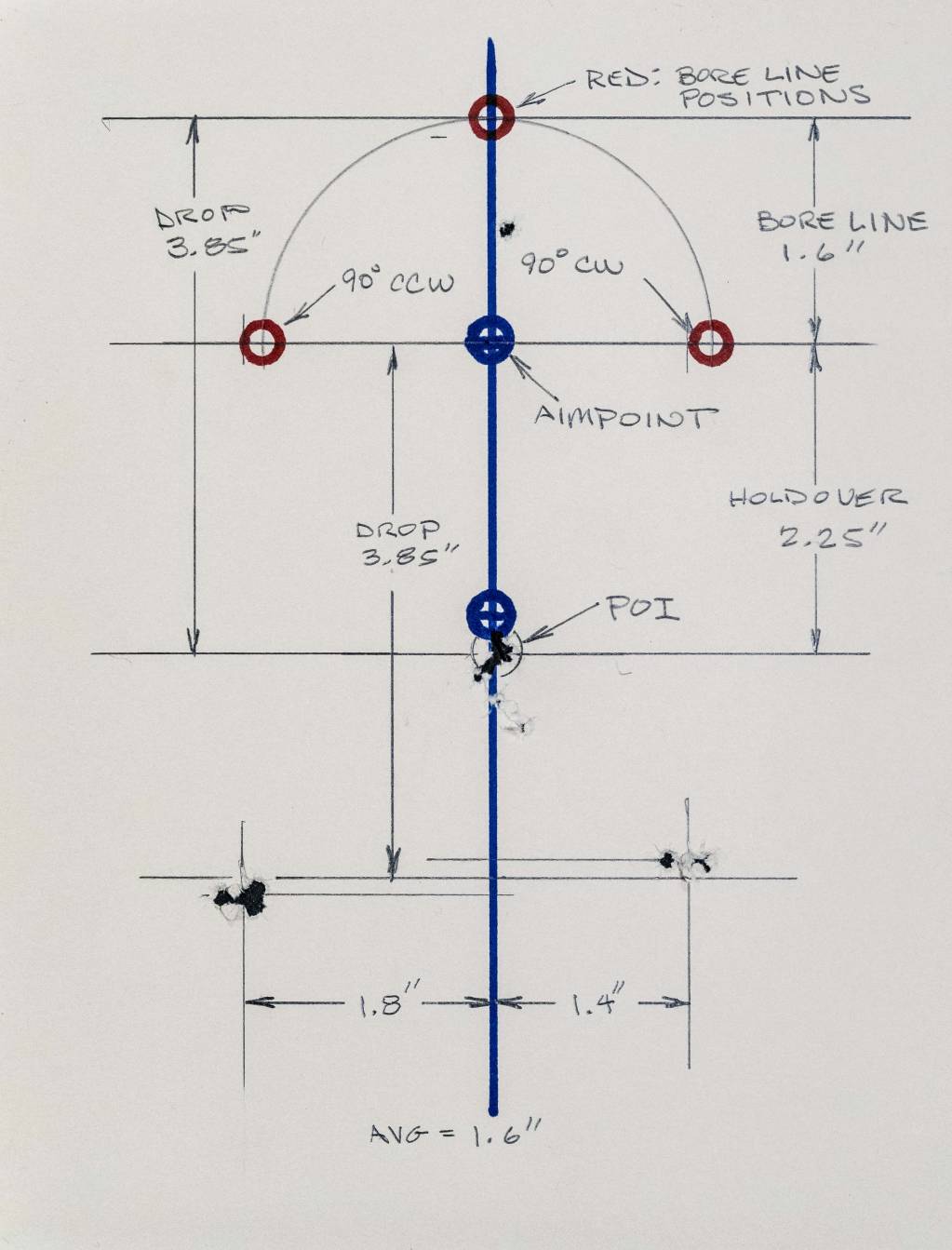

About what I expected. Still stuck on "range error" and "at the target" (i.e. a single click to distance). Even Szottesfeld was smart enough to add (although begrudgingly as I noted because of his FT biased view) his caveat that scope height does make a difference in certain circumstances. I guess there is no "debate" here as you referred to this back and forth recently. There is one point of view (those who SELECTIVELY agree with Szottesfeld) and another point of view (those who don't agree with that view at all). If nothing else, I believe that at least CONSISTENCY is on the side of the non-Szottesfeld viewpoint. I'm not going to change and it doesn't seem you are either so as has been the case for a long time now, we'll have to agree to disagree. And you (i.e. the Szottesfeld supporters) have repeatedly stated a negative after Szottesfeld himself basically said OK, hold it a second, I'm actually correct in my negative BUT there are circumstances where I'm not. Doesn't seem like there's anything for me to prove so I'll spend my time shooting. Best to you, hope you shoot well.
I promised I would conduct another canting experiment using holdover to see if two simple concepts could correctly predict the outcome in this second scenario:
  1. The point of impact will always be below the bore line by the amount of drop at the target distance.
  2. The bore line remains the same distance from the aimpoint regardless of cant angle.
    [/LIST=1]
    In this experiment I intended to use a 2.0" holdover at 35 yards, but it was dark and when I retrieved the target I could see the holdover was actually 2.25". Using my Harrier again, drop at 35 yards was predicted to be 3.82". I measured an average of 3.85" on the target.
    As you can see, with a 2.25" holdover and 3.85" drop the bore line can be assumed to be 1.6" above the aimpoint. Accordingly, when the rifle is rotated 90 degrees the bore line will be displaced laterally the same 1.6". The groups produced by a 90 degree cant should appear 1.6" (average) left or right of the aimpoint, and below the aimpoint by the 3.85" drop value. And they do. Note that scope height did not need to be taken into consideration to adequately predict or explain cant behavior when holdover is used. Nor did scope height need to be taken into account to predict cant behavior when a conventional aiming method (aimpoint/POI at crosshairs) is used as shown previously.
    The only difference in the outcome is that the holdover method produces less elevation and windage "error" due to the bore line being closer to the aimpoint (max error of 1.6" from intended POI versus 3.8").

For bandg: The point of the experiments was to verify that cant error can be predicted by knowing just the drop at a given distance, and holdover if holdover is used. So it is no longer necessary to perform real world experiments if you have access to software that can calculate trajectories accurately.
For the scenarios that you describe, and using trajectories for my rifle I come up with the following:
Scope height 1.76", first zero at 20 yards
  • Second zero = 28 yards
  • Time of flight to 28 yards = 0.132 seconds
  • Drop at 28 yards = 3.37"
  • Error at 45 degrees = 0.707 * 3.37 = 2.38"
Scope height 2.76", first zero at 20 yards
  • Second zero = 42.5 yards
  • Time of flight to 42.5 yards = 0.173 seconds
  • Drop at 42.5 yards = 5.78"
  • Error at 45 degrees = 0.707 * 5.78 = 4.09"
Without a doubt the errors are different at the second zero. But that is because the second zero distances are different. No matter how you manage to zero at 28 and 42.5 yards, the errors at 45 degrees will remain 2.38" and 4.09" respectively.
The one scenario that I thought did show an effect of scope height on cant error was the commonly used technique of zeroing for a midrange distance and using holdover for longer distances. Because holdover does affect cant error, and scope height will affect the required holdover at longer distances, there can be an impact of scope height when using holdover. Again for my rifle zeroed at 35 yards, and using holdover at 50 yards:
Scope height 1.76"
  • Time of flight to 50 yards = 0.207 seconds
  • Drop at 50 yards = 8.28"
  • Required holdover = 1.79"
  • Error at 90 degrees = 8.28 - 1.79 = 6.49"
  • Error at 45 degrees = 0.707 * 6.49 = 4.59"
Scope height 2.76"
  • Required holdover = 1.36"
  • Error at 90 degrees = 8.28 - 1.36 = 6.92"
  • Error at 45 degrees = 0.707 * 6.92 = 4.88"
It might be surprising that the higher scope height produced a larger cant error, but that is because less holdover was required. As shown in the second experiment, holdover reduces the cant error at any given distance.

Bandg, the answer to your question is represented in Scott’s diagram where circled.
Because the severity of cant error is determined chiefly by the amount of drop (for the small cant angles typical of normal shooting), the error is small for close shots and grows ever larger with increasing distance.
That is a characteristic of cant error bound to my example only in the most tenuous way.
I look forward to seeing you substantiate how two identical points of aim produce different errors.
