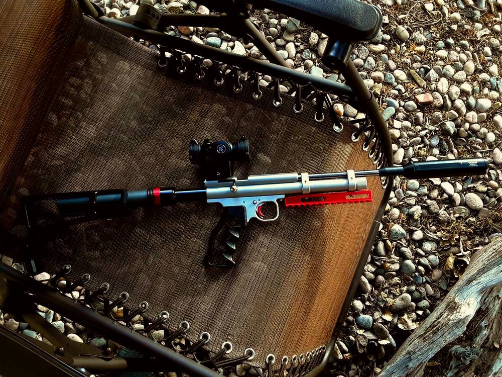

I have about the same set-up (same platform and Vortex red dot) and it gives me no trouble.
The problem with the OEM barrel band is that it pushes the barrel downwards----set screw is on top.
My bands have set screws on the sides and angled downwards (presses tube instead of barrel), thereby negating the inherent barrel droop.
It is an all stainless Don Cothran build:
The photo shows a Vortex Sparc, but I did try my Vortex pistol sight on it with no ill effects.
I believe the OP uses a mini UTG adapter (read it somewhere), so it is very low.
Like Darkhorse, I’ve used reflex sights on top of Picatinny adapters and was able to zero them at 10 yards. That’s not 8 yards but my example also doesn’t represent anything like 5 inches high at 8 yards.
So while the short distance and sight height are indeed factors aggravating the problem, they aren’t the primary cause.
