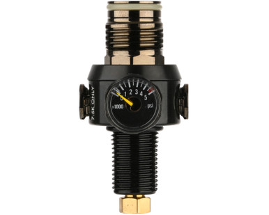

I don't see where they give the thread size but they have a picture of the bare regulator here
Scaling the bottle threads against the known diameter of the ASA threads, it appears to be the desired 0.62" diameter, meaning 5/8" - 18 like a Ninja, Tippmann, etc.. Definitely not M18 (0.71").

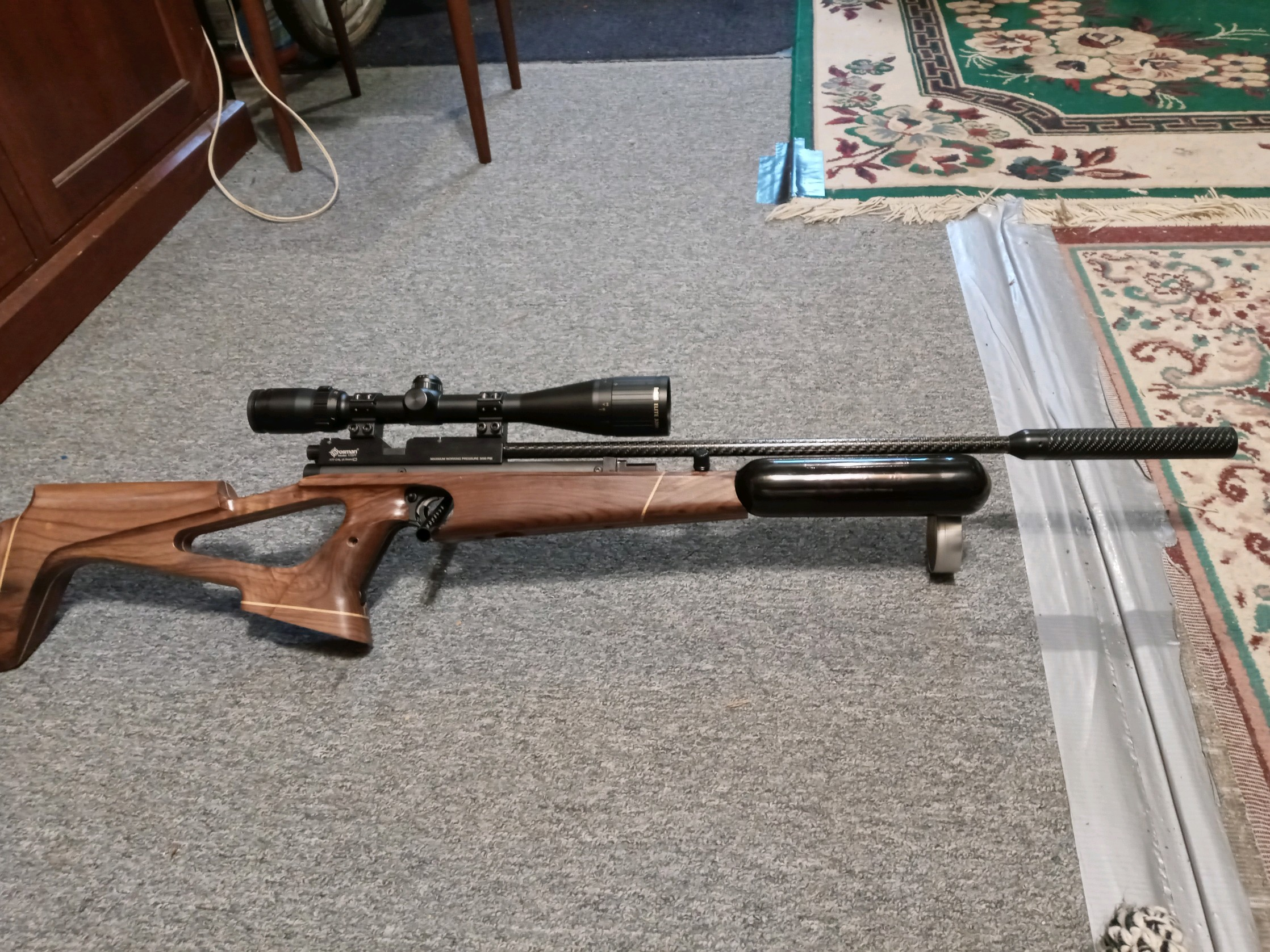

This is the first 2", 4500 psi bottle I was able to find, it's what I used on my 2250 Cothran/Stace bottle gun -
