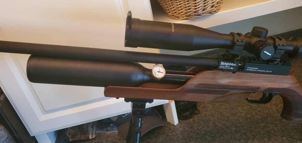

I put a 4500 PSI aluminum bottle with a Lane regulator on my .25 kratos. Very acurate, great shot count!
