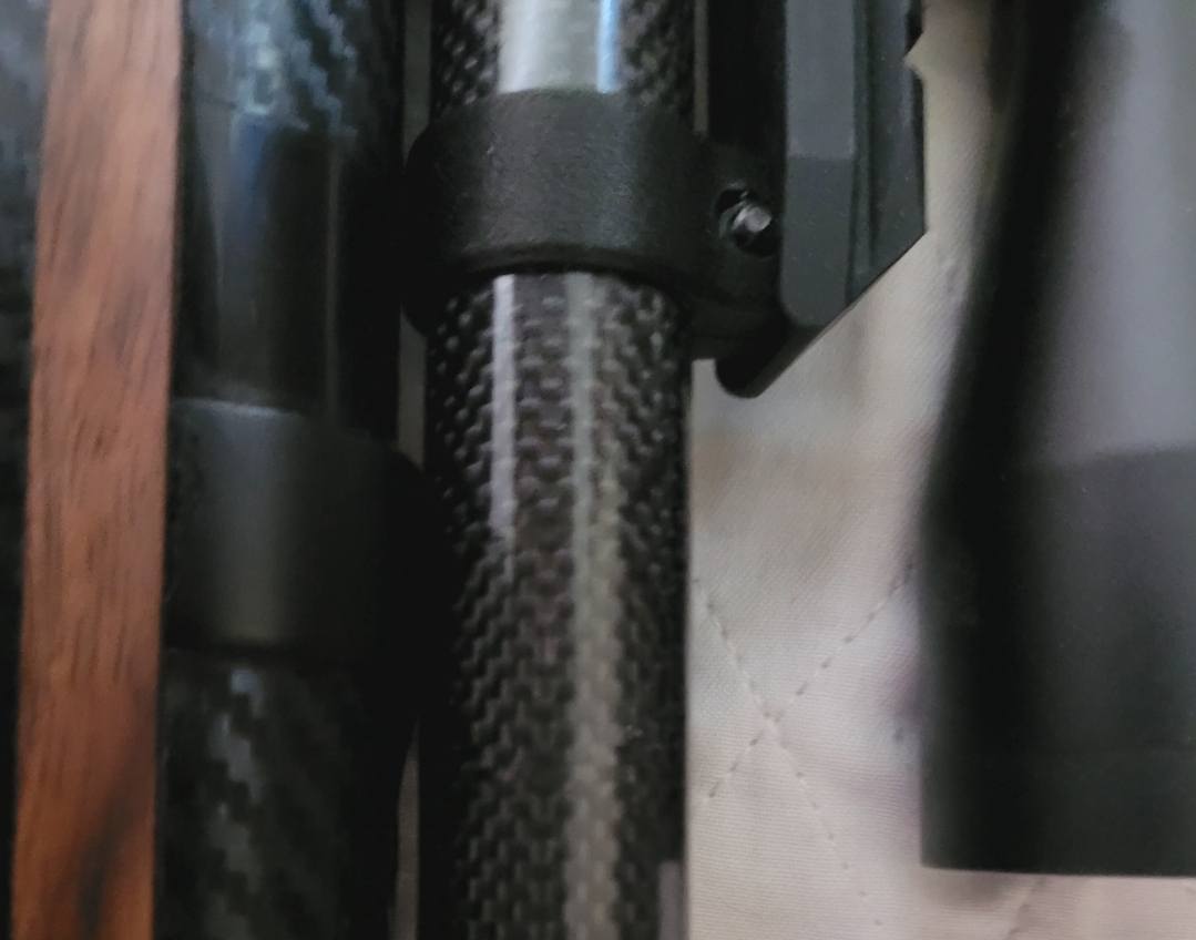

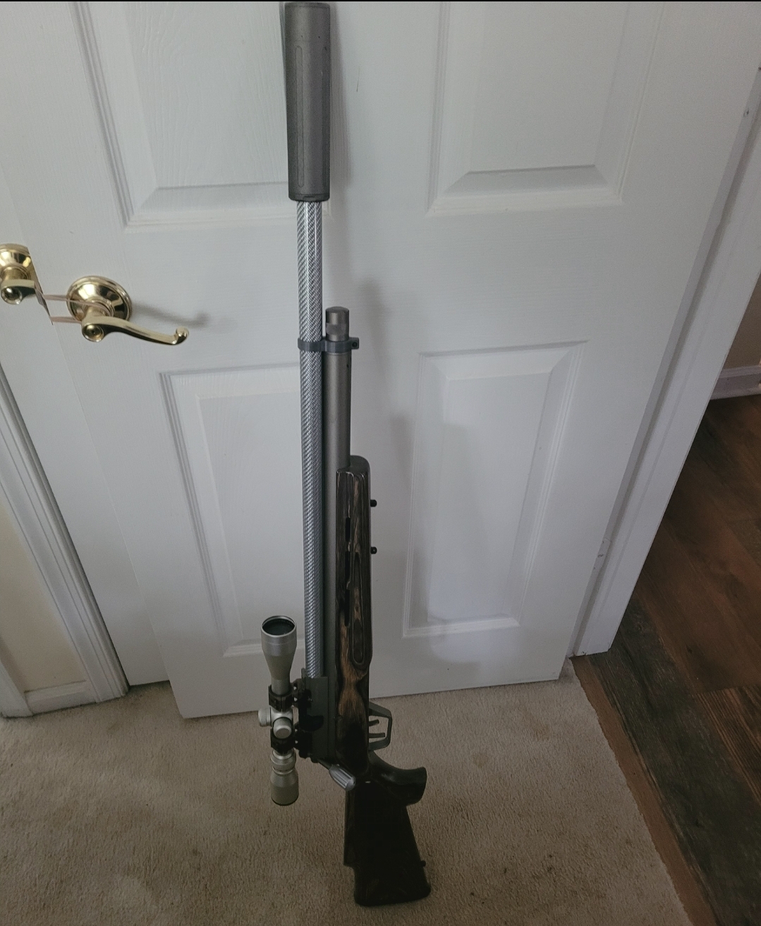

When i changed from 600 to 700 mm barrel on my Maverick, buying the longer FX barrel shroud and sleeve was way too expensive.
So i got 3 X 1 M carbon fiber pipes from China, each fitting into the other with a light suction fit ( after some sanding ) and finally onto the FX barrel sleeve i extended with a +100 mm adapter.
That worked just fine for many years, with the one problem that the CF pipes would bend the barrel ever so slightly, so you had to be mindful of the indexing of my setup.
Though not a problem CUZ i never pulled the barrel , just the liner once in a while to clean it.
