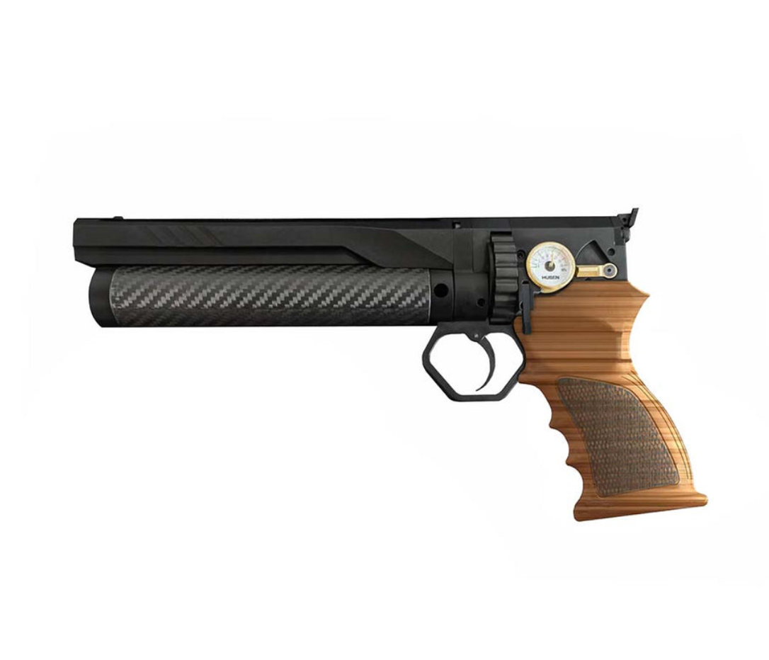

Let’s assume that the average airgunner applying carbon fiber wrap to the reservoir on their airgun is not wrapping it in a fashion that will reinforce the material that the reservoir is made of. Here’s an example of what I’m talking about.
I’m also skeptical that the GK1 reservoir is a genuine carbon fiber vessel. Anyone know for sure?
I'm pretty sure the reservoir is titanium. I doubt the carbon is real.

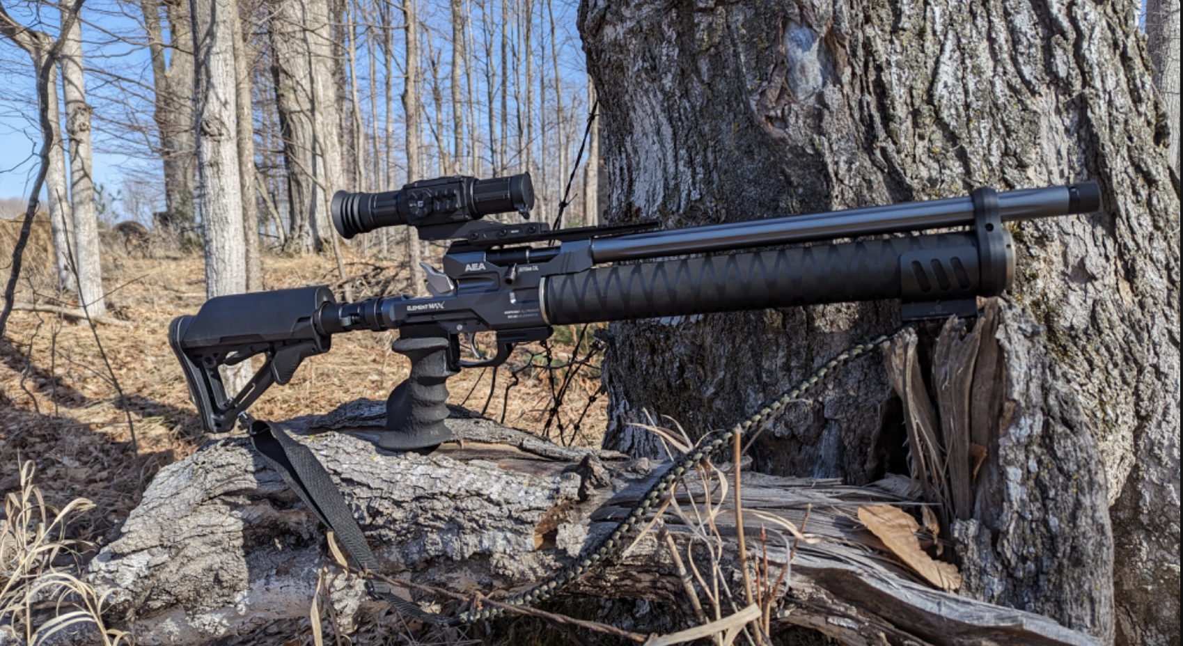

So, if someone is referring to "wrapping" their barrel or bottle, that probably won't be CF - its most likely is going be a look-alike, probably vinyl. Joe Consumer can buy & apply CF cloth, just like fiberglass, but to apply it to something small & round like a barrel or tube would be a pain, and I don't see the point. Unless, there's something newer on the market that I haven't seen, which is quite possible.
Now, to me it looks like the AEA rifle above doesn't have CF on the air tube, but rather "X" vinyl shrink wrap:
https://www.amazon.com/gp/product/B07FVMYHQP/
