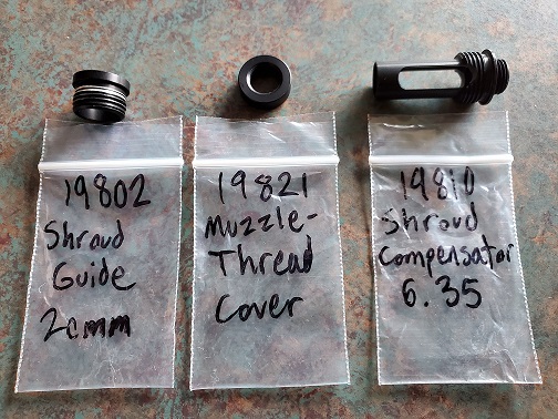

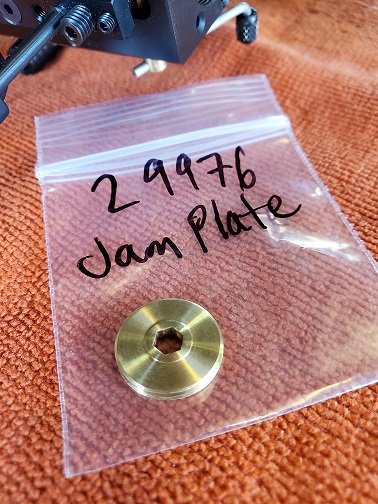

The two fittings on the FX shroud are both threaded into the stock aluminum tube, the parts I used were purchased separately from FX ( I ordered parts to put a thin shroud together for my 600mm .25 barrel so it could be used on my Dream Tac ) It was purchased for my Crown and had the larger diameter "pull out" shroud on it, when I ordered the new parts they were all packaged individually and I was able to see how the stock shroud is put together...
If the shroud is assembled from the factory I found it is very difficult to remove the fittings from the shroud tube, a heat gun is probably necessary, the difficult thing is not scratching the parts trying to take them apart... Best idea might be to order the fittings for the shroud seperately from FX... Or bring yourself to destroy the tube to get the two fittings off, a Dremel tool might help...

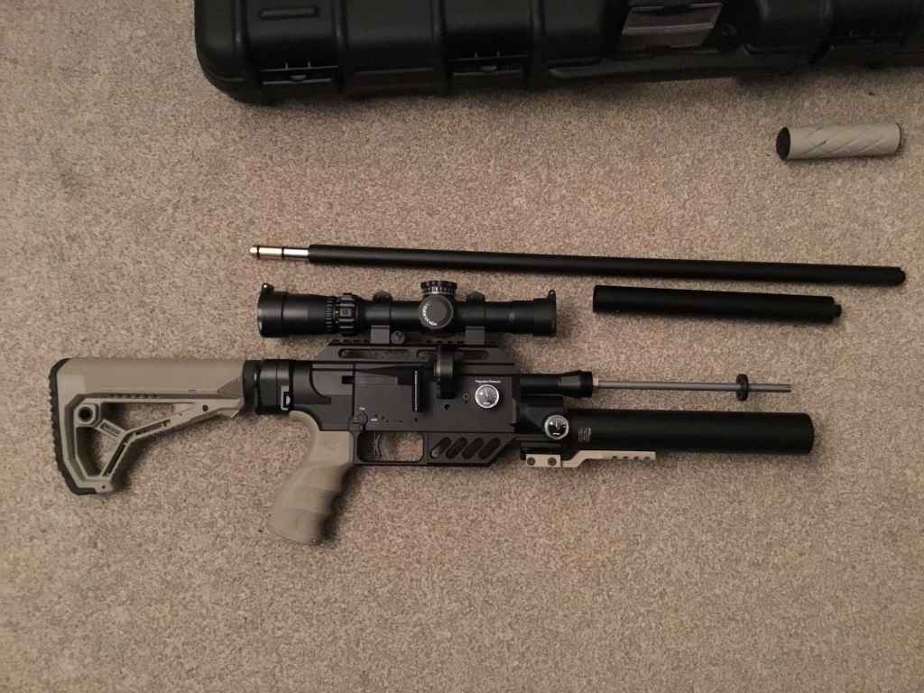

I like the look of carbon fiber, whether its a vinyl wrap or the real thing... I have multiple barrels for my FX rifles, one of the barrel kits I have is a 177 for my Crown... It has the pull out style, larger diameter shroud and does not fit my Dream Tac, I ordered pellet probes for all three of my barrels for both of my FX rifles... I found myself having to swap shrouds between my 500mm 22 and 500mm 177 barrels to use either on my Dream Tac... I ended up with an extra part when I ordered a shroud for my 600mm 25 barrel to use on my Dream Tac, the part I ordered and didn't need was the air stripper, anyhow, I had one extra for the thin style shroud...

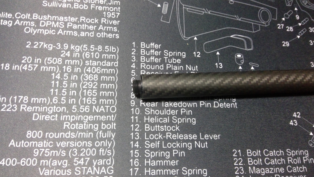

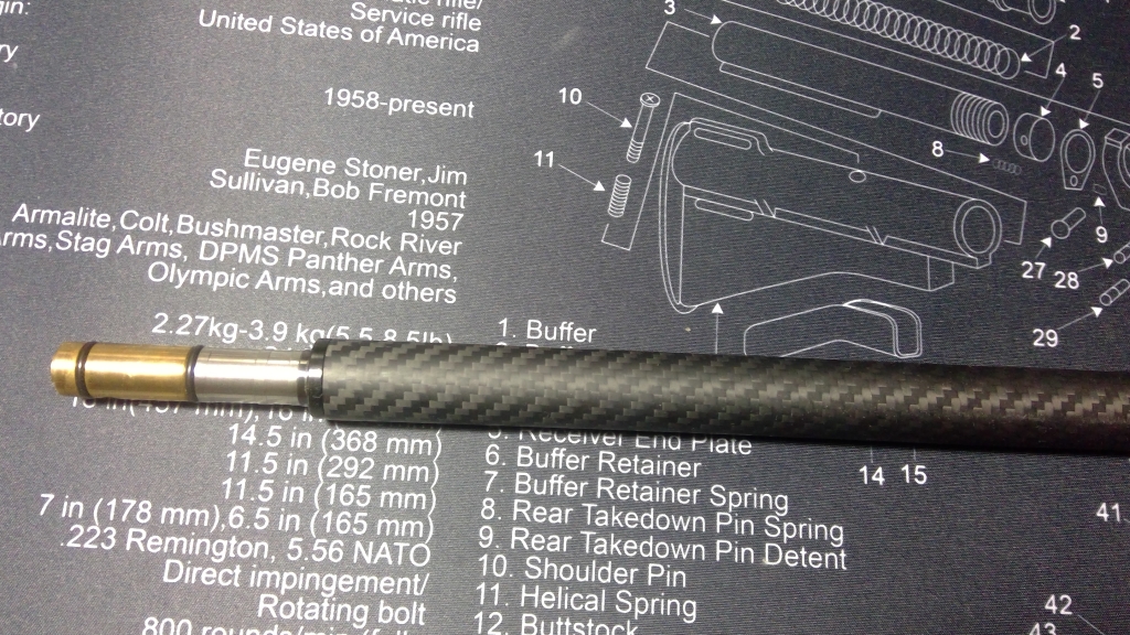

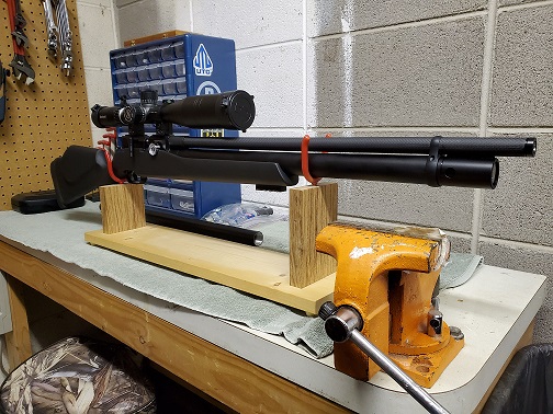

Instead of doing a carbon fiber wrap on the stock barrel shroud (which would add weight) I decided to make a real carbon fiber shroud to fit my 500mm barrels... It came out great, a perfect fit and I think it looks great too...
20mm OD X 18mm ID Carbon Fiber Tubing, cut to length (carefully) with a Dremel cut off wheel, the two fittings used on a stock FX Dreamline 500mm barrel shroud, sand the edges of the threads down just a bit until they fit the ID of the carbon fiber tubing, two very small drops of 5 minute epoxy on the threads of each fitting to secure in place...
A couple photos...
Ken

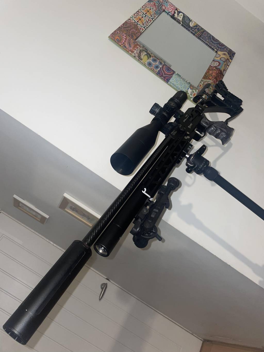

Hi all,
My .177 FX Dreamline comes standard with a 600mm barrel. I have a 700mm liner, and I'm looking just to buy the shroud, but most retailers are offering me a barrel kit.
Do any of you know what the part number is for the 700mm shroud or the dimensions so that I can try to find a carbon fiber tube to do a DIY. I understand that OD is 20 with 18 ID but I don't know the length...
