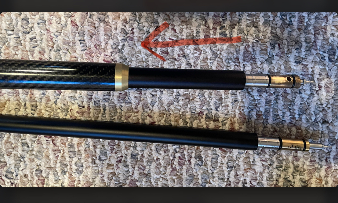

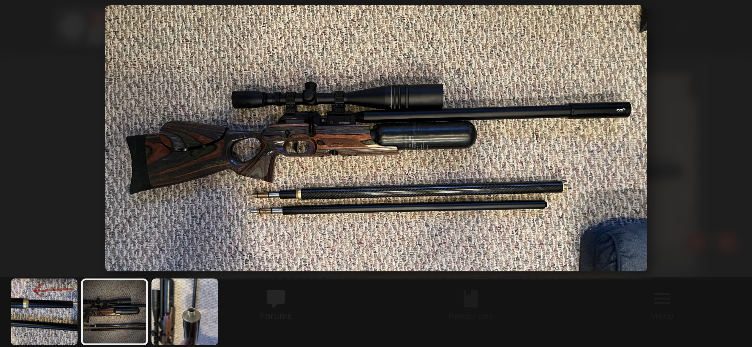

I saw one on Bulletcentral and the listing was unclear if it would work on a MkII so I called to confirm. So I ordered it and it is not compatible in any way with a MkII that has the brass nut gland over o-rings and three spacers between the barrel and outer tube. It’s some earlier barrel assembly that I can find almost no information about.
So whatever you do don’t buy that. Or at lead buy mine for a huge discount.

Your bulletcentral will definitely work with your Crown Mk2…
That carbon shroud is designed to slide Dreamline barrels into it.
You take the Dreamline barrel and leave the moderator end cap installed on it - the mod end cap screws into the bullet central shroud.
Looks great and makes the Dreamline barrels look like they were designed for the Crown. (Dreamline barrels work in the Crown but look a bit “skinny”)
Also, there is a space between the muzzle of the Dreamline barrel and the end of the carbon shroud, to act as an air stripper / moderator, so you may not need a moderator or may be able to use a smaller moderator.
I did a post on this a while back with pictures.
Hope you have a Dreamline barrel so that you can try your bulletcentral shroud.
-Ed

Thanks for the info. I no longer have the Crown and if I did, I would still be salty about having to buy a different barrel to make the kit work.
David
