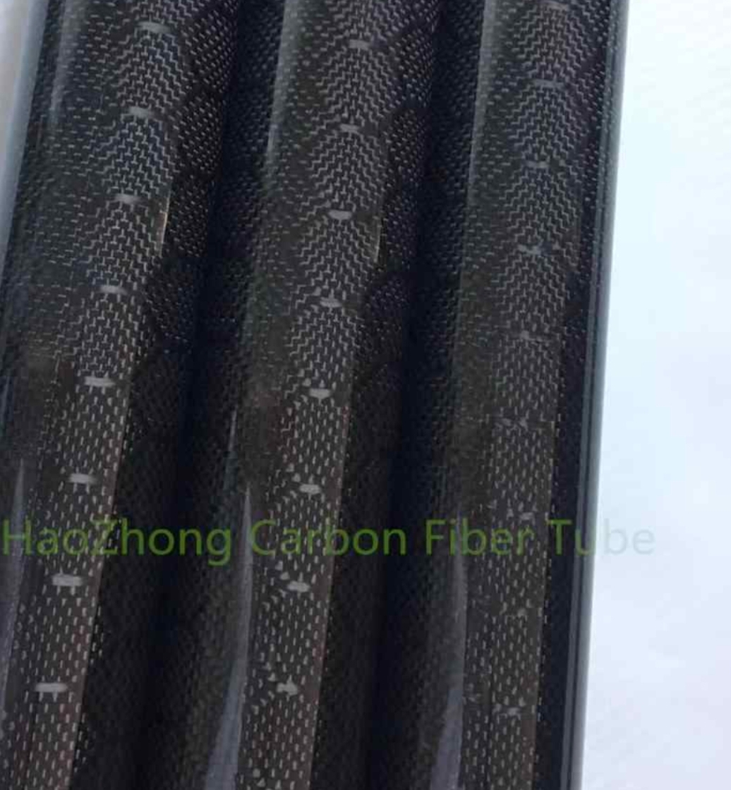

So what is the advantage to a carbon sleeve ?
B Bearwhiskers Member Jul 21, 2024 33 11 Aug 5, 2024 Add bookmark #1 Aug 5, 2024 Add bookmark #1 So what is the advantage to a carbon sleeve ? Reactions: old goat
25.cal Member Jul 2, 2023 167 87 Mission Viejo, CA, USA Aug 5, 2024 Add bookmark #2 Aug 5, 2024 Add bookmark #2 Get rid of the orings and have the barrel supported over a longer length. Reactions: JimBentley, old goat and Impact701 Upvote 0
S steve-l Member Jul 19, 2018 1,277 890 Limburg, Netherlands Aug 6, 2024 Add bookmark #3 Aug 6, 2024 Add bookmark #3 A CF sleeve adds barrel stiffness, which improves consistency as it reduces barrel whip. This is required when thin wall barrels are used to save weight. Reactions: Eli_809, old goat and Impact701 Upvote 0
Kpac Member Nov 25, 2020 275 246 United States Aug 6, 2024 Add bookmark #4 Aug 6, 2024 Add bookmark #4 Not to mention beautiful check it Reactions: Chief Ten-Beers Upvote 0
