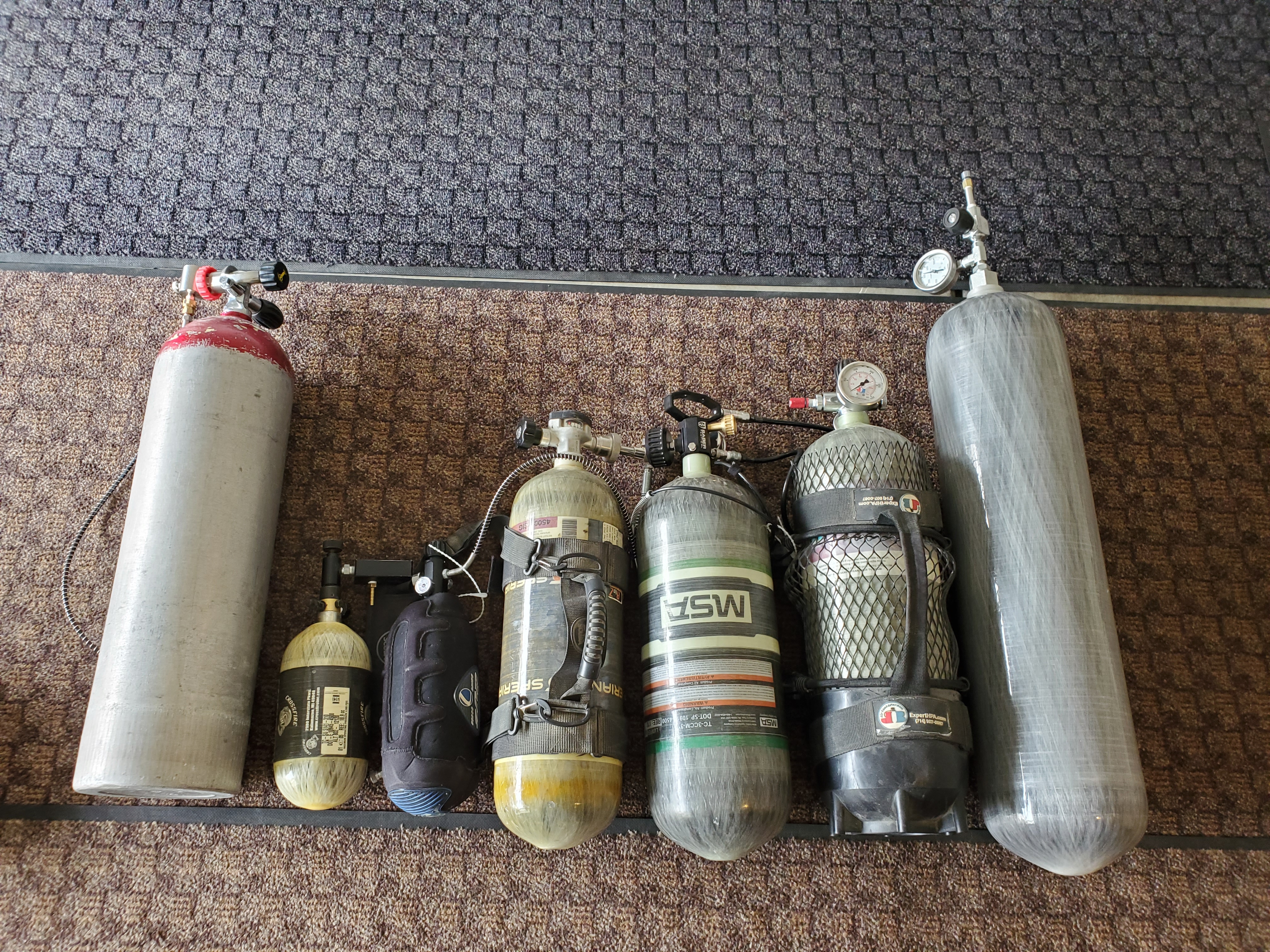

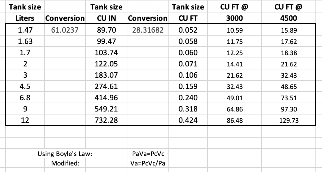

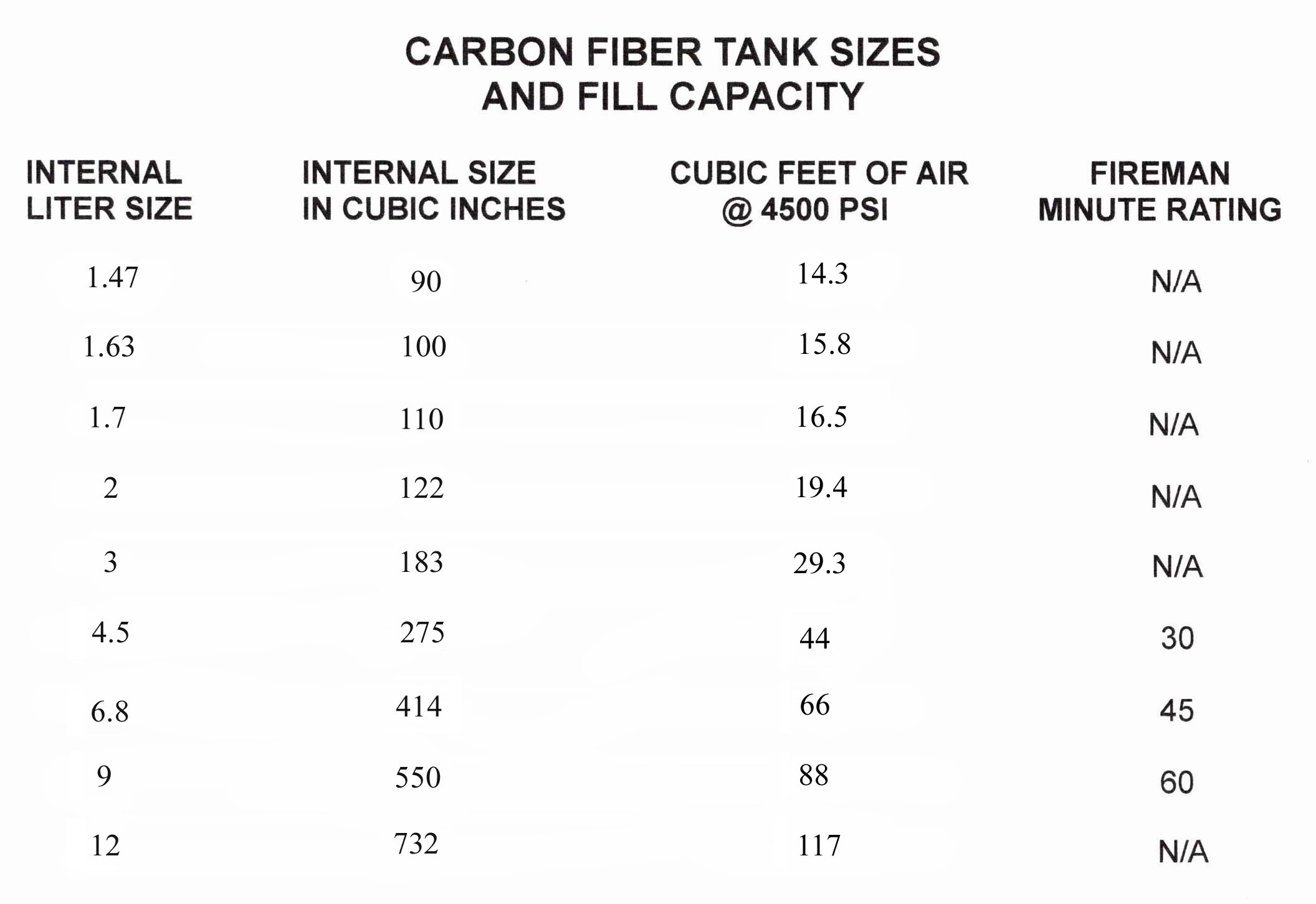

Carbon fiber tank size comparison chart

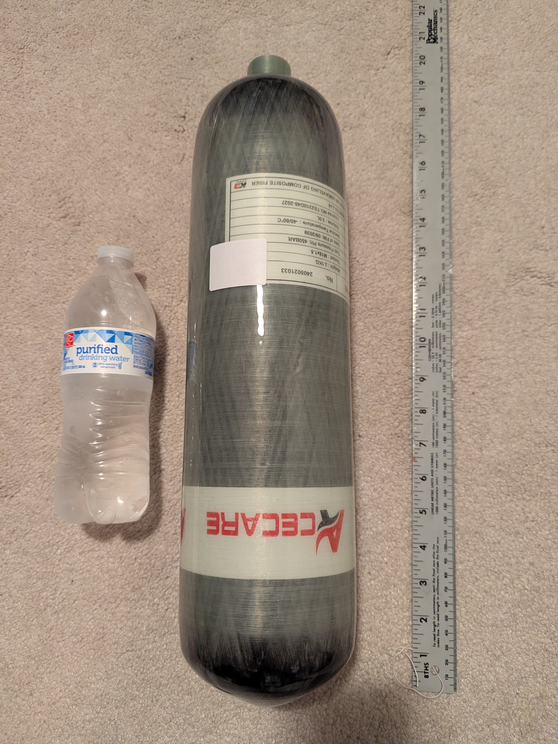

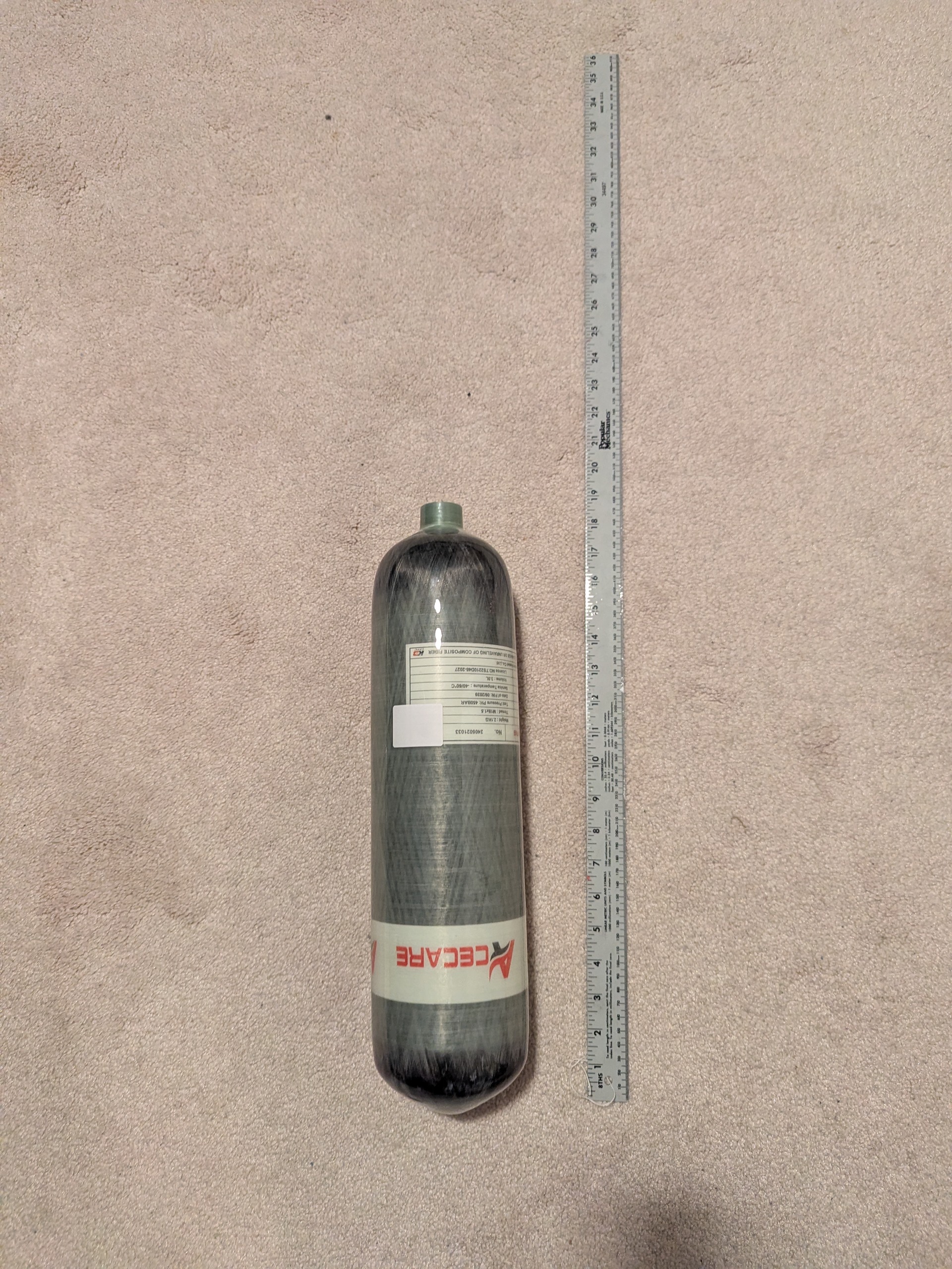

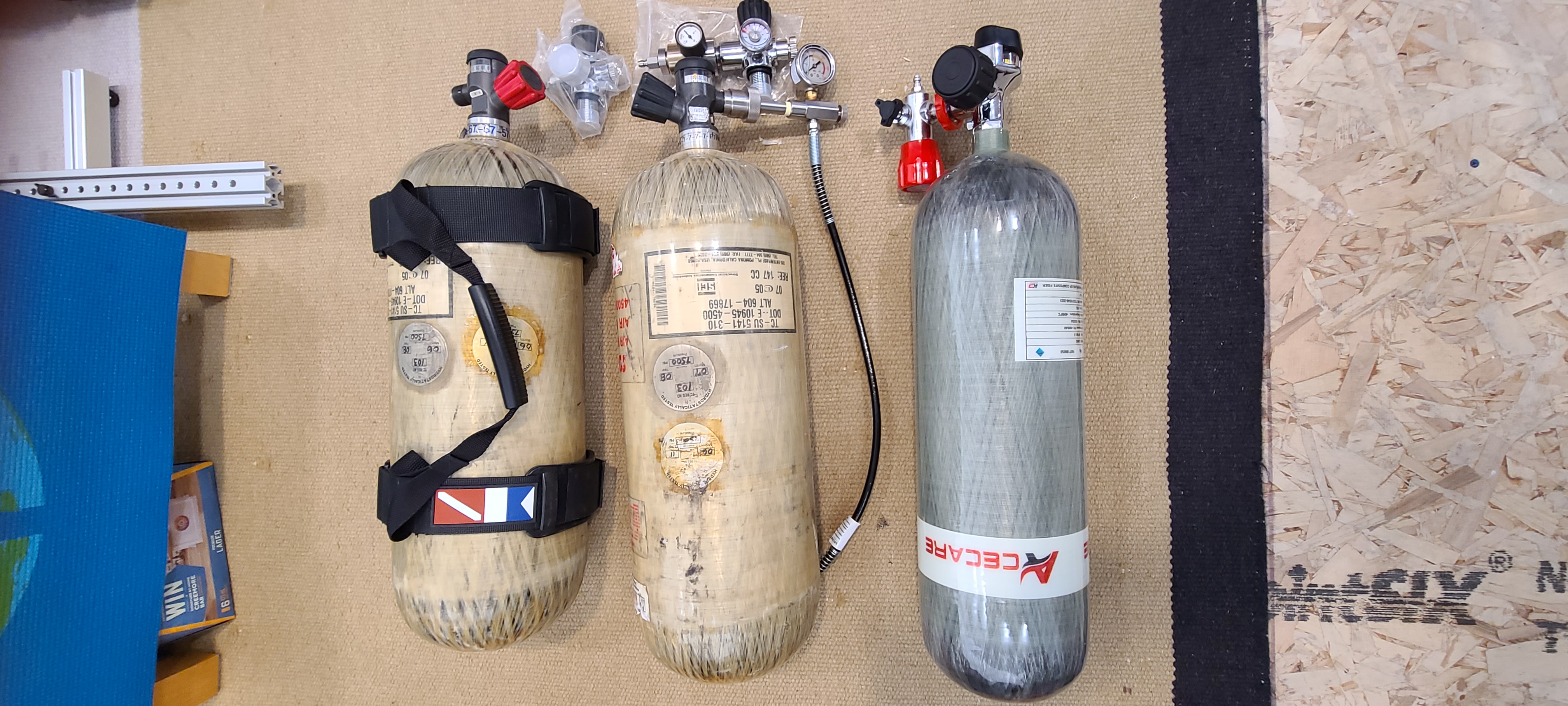

For years I was tinkering but afraid to ask... what would be the Liter size for these my fireman tanks? Or in minutes or whatever?
I know the Acecare is 9L it is saying it on the sticker

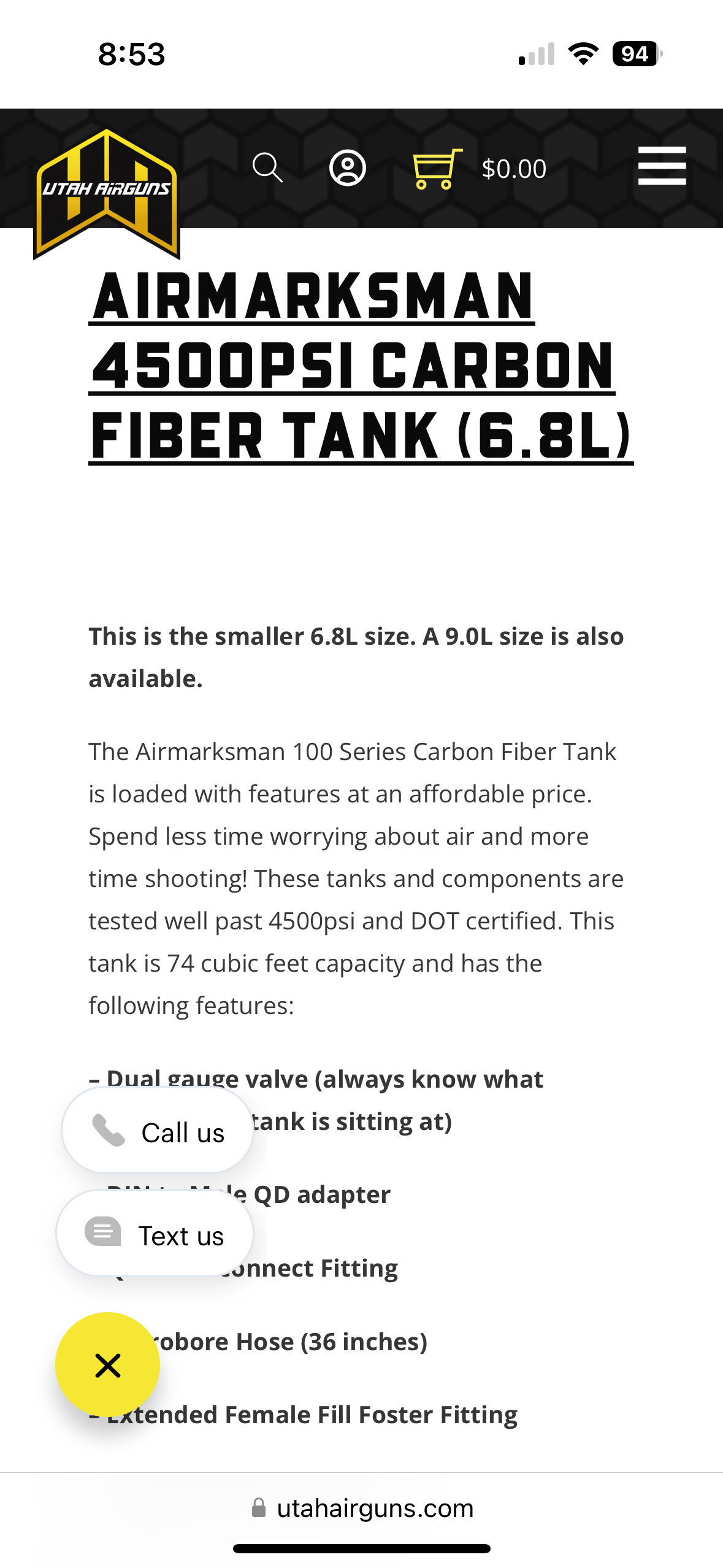

Did a little shopping to learn that the 60 min firefighters air bottles are very hard to find, and when found are pricey. Lots of 30 min. bottles. Have any members ganged two of the 30 min bottles together? Seems to me that could be ideal, easy access to cheap air bottles, gang them at home for air storage, take one along for field and range use. If any members have done similar please post up pics of your setup. I'm considering the least costly and "cleanest" set up, wondering to stick with the CGA347 valves or swap the bottles over to airgun fill valves.
This is great thanks much for the clarification it will bring.

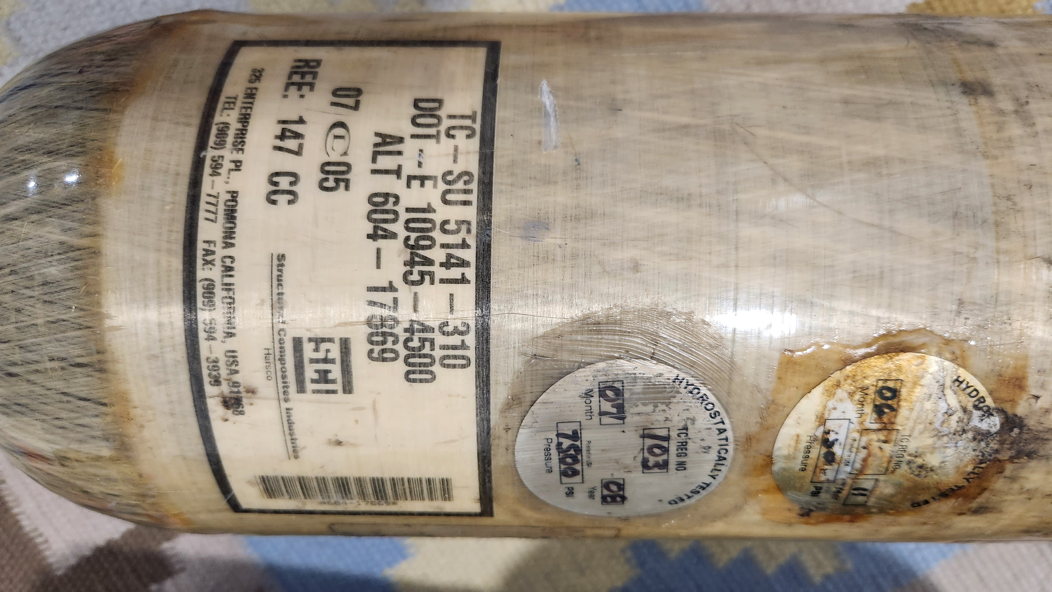

What about the 97cubic foot Great White he says it is 550 cu inches so that makes it an 88 cu ft 60 minute tank?
I own a bunch of bottles and have a great white. It's at least physically bigger in size than my 88. It seems to hold more based on known fill items. I don't want to drain them and measure fill times even on a dive compressor 😁. One day I will do so and dig this thread back up.
