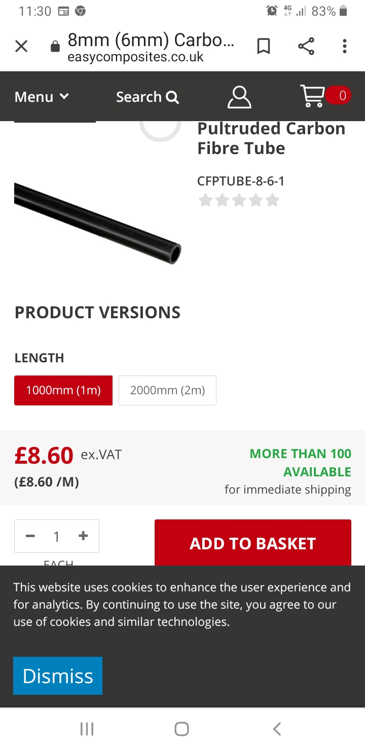

I'm looking for feed back on these carbon fiber tubes !! In particular has any member fitted one to a streamline ?? Is it a difficult or tricky process ? Any special tools required?
Would one tube be sufficient or slip a second on top of the first for extra support and rigidity.
Many thanks
