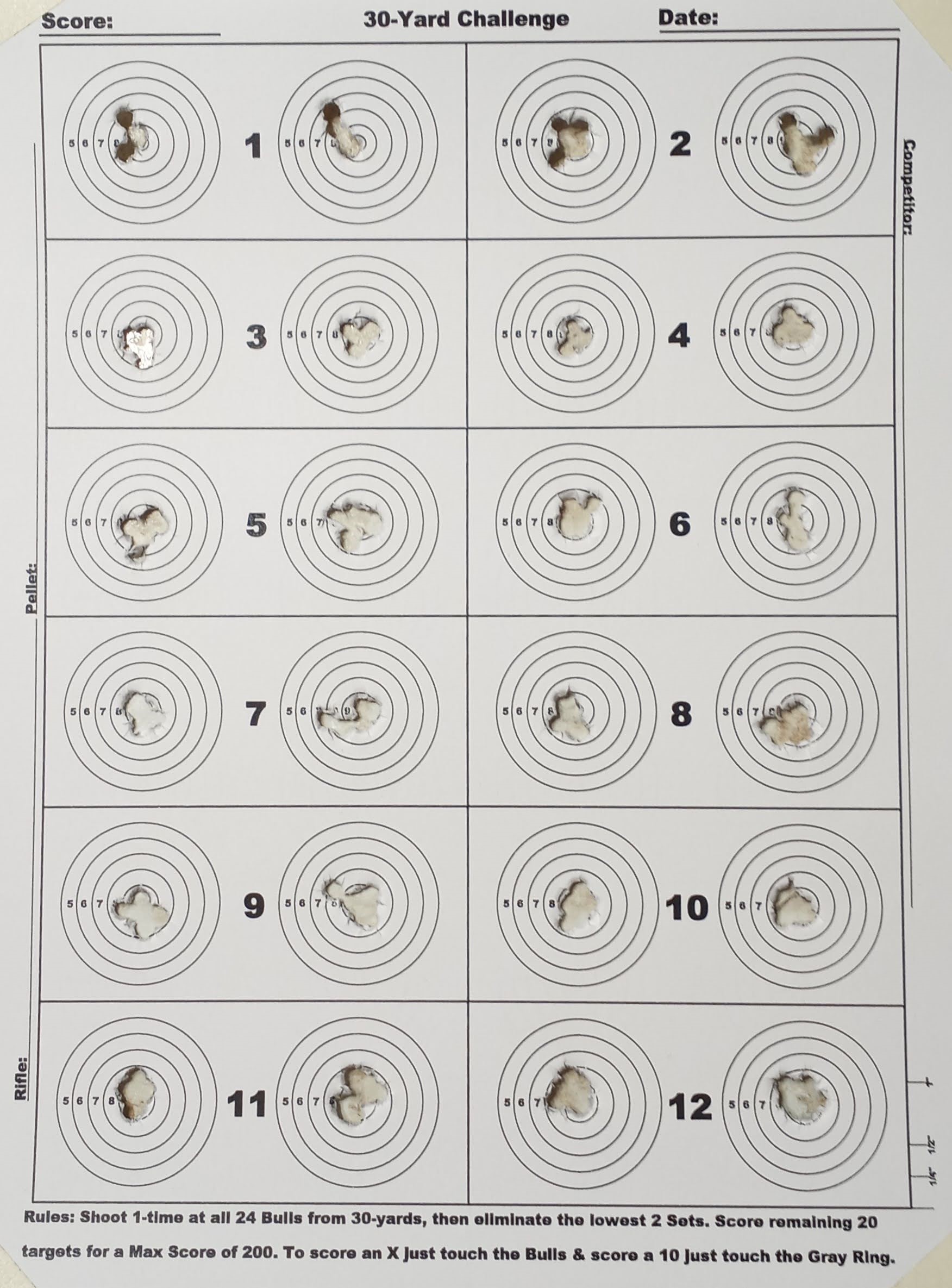

I am printing #90 cardstock on a HP Laser Jet 1320 with no issues. It does really well in not tearing.View attachment 303098
Hello Firewalker
That does look like good stock, even with the multi hits the holes look clean. The print shop said my targets would be ready early next week and I will shoot some and post a picture here.
Bye the way, I believe your score for that card is 1000+ :D :ROFLMAO: :p , that is some good shooting.
