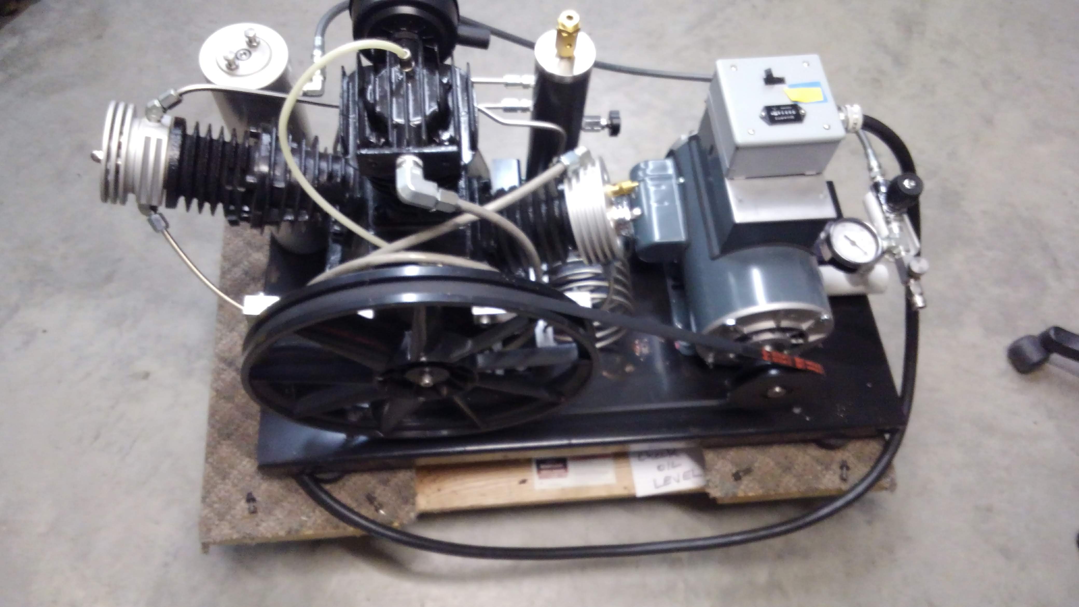

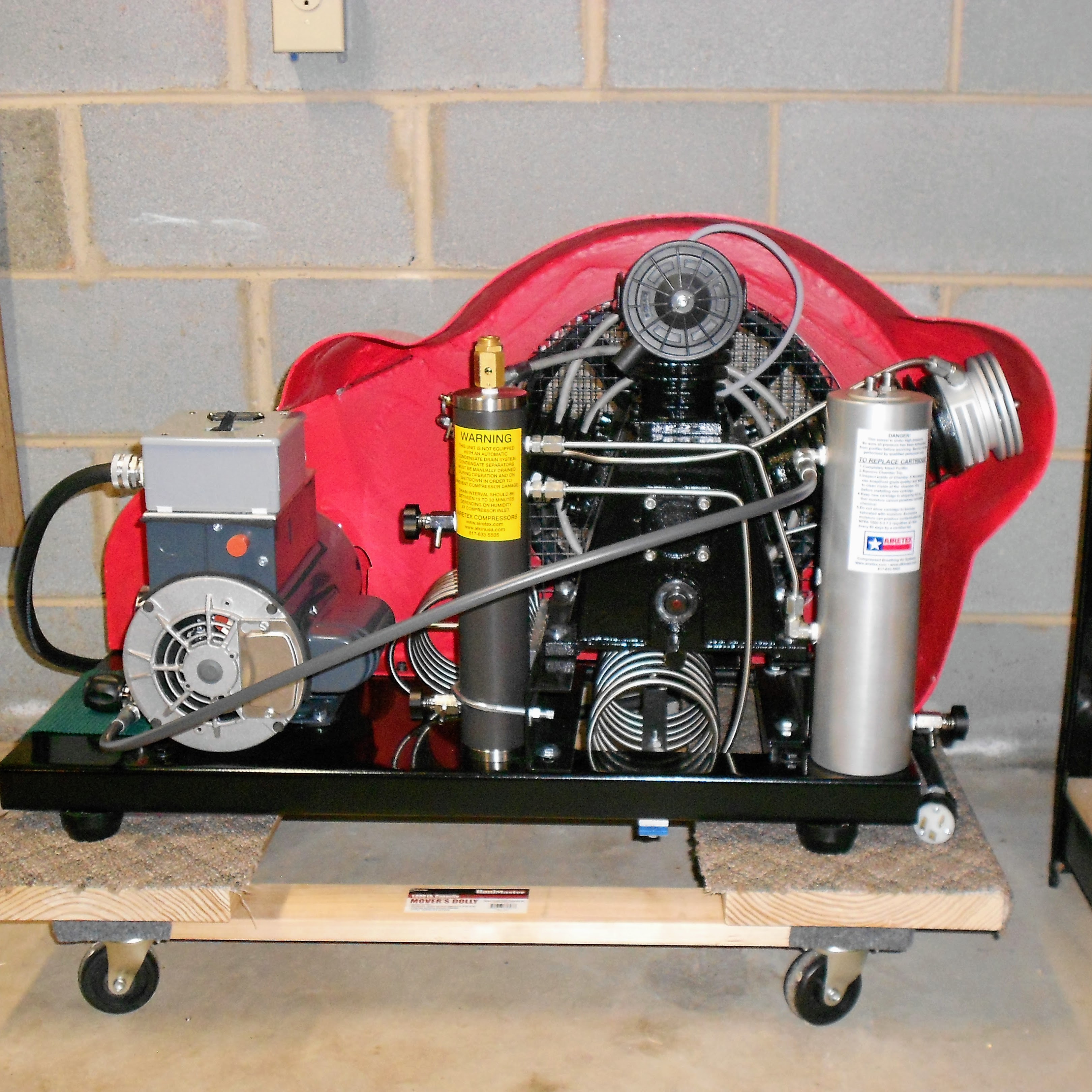

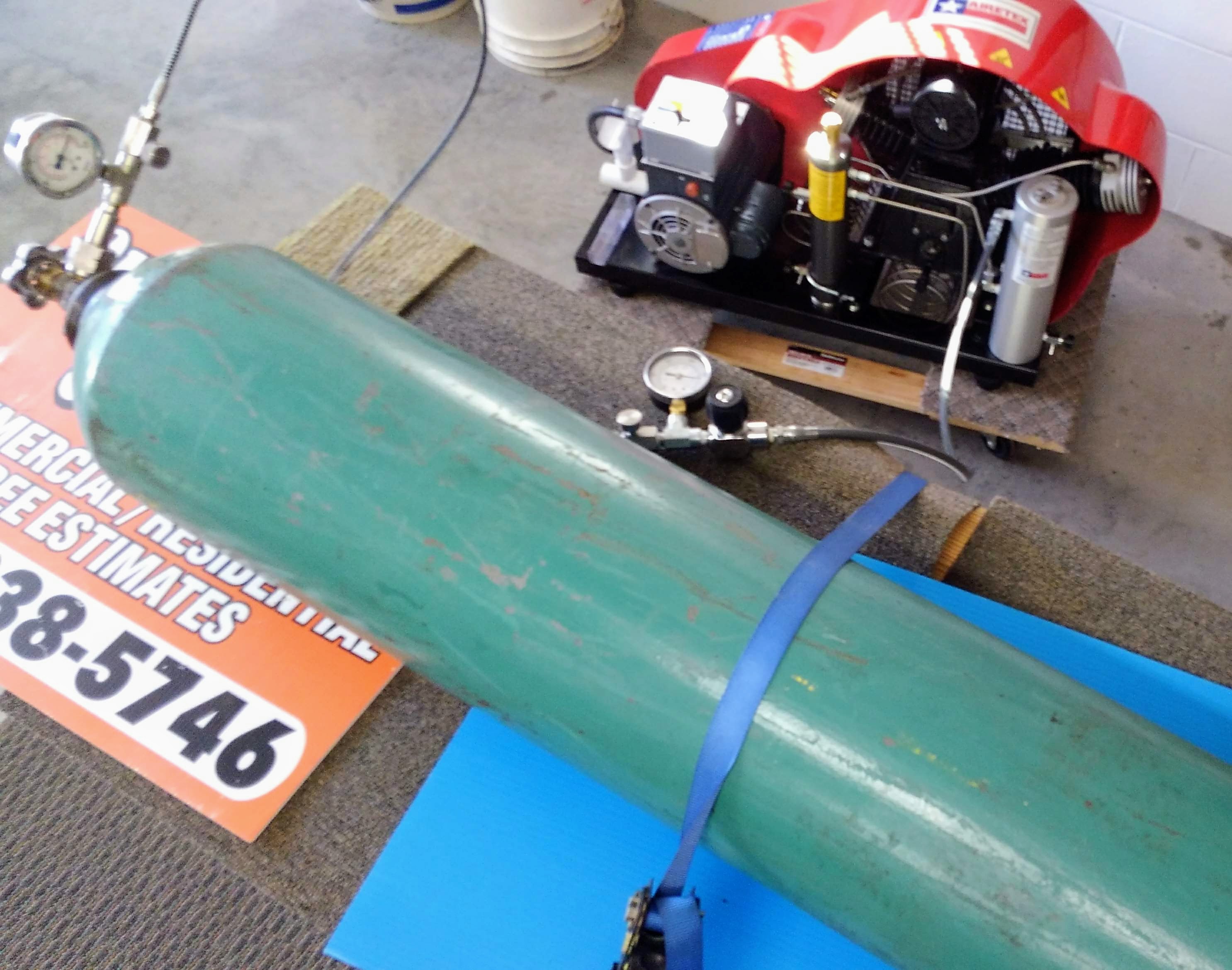

I'll chime in about the Airetex............................I have owned mine 7 years now, filled many tanks over and over including my buddies 6000 psi nitrogen tank. I think my compressor has 31 hours on it and not so much as a burp. Built like a tank. I wanted plug and play, and I got it. no regrets. I just recently removed the shroud to check the belt and fasteners,,,,,,,,,,,,,,,,still like new.
That's the same compressor that I have. One of the best decisions I ever made and changed my large bore shooting forever.
Let me share my findings for drsquall and anyone else comparing these compressors. Grackeblast and Badgerfarm own Airetex brand compressors which are now sold by Alkin U.S. compressors in New Jersey. Alkin compressors are manufactured in Turkey. I own a W31 and recommend Alkin for their durability and their excellent customer service. Airetex, in Dallas TX previously sold Alkin manufactured compressors built to their specifications. Airetex is a U.S. designer, importer, and retailer. Alkin is a manufacturer and U.S. distributor of their own compressor brand. Alkin compressors are also sold by several online air gun retailers. After Airetex and Alkin parted ways, Airetex contracted a chinese manufacturer to build Bauer Jr. II clones under their Airtex brand. I don't know if Airetex still sells compressors as they have kept a low profile the past couple of years. If you like the previous generation Airetex, buy an Alkin. If you prefer a Bauer Jr. II clone at an attractive price, contact Airetex and share your findings with us.
