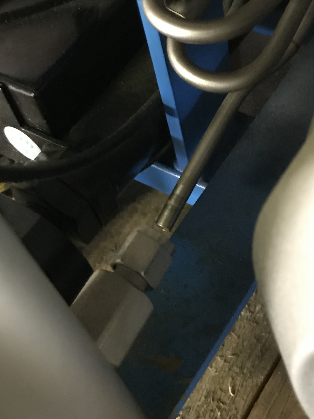

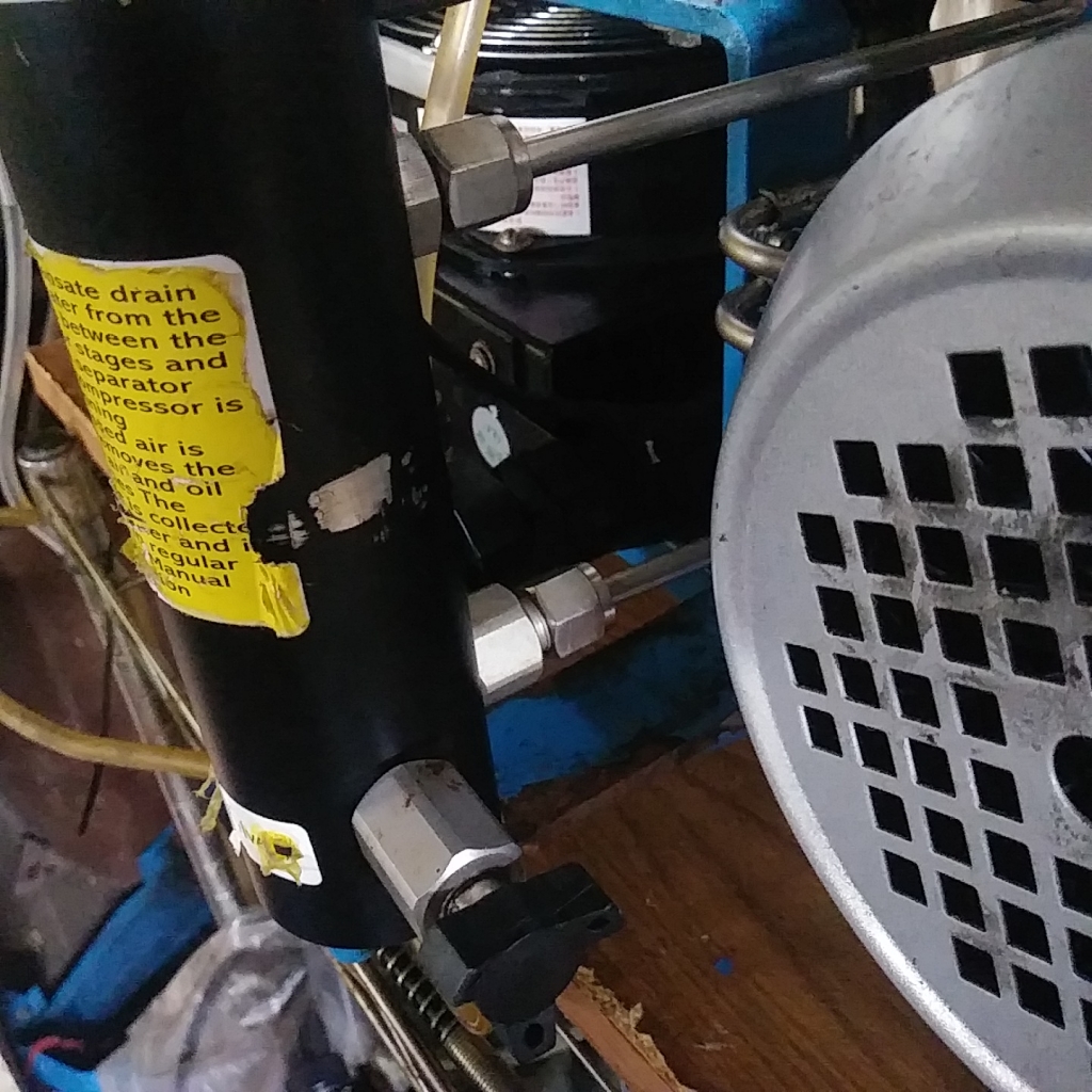

Hi, mine also just went with a bang after 3 years. The fitting got separated at the condensor. No idea what happened, it was building up pressure just fine and at 200bar it just went bang.
Do you have any contactinfo of the original vendor so I can order spare parts? Or is this something I can fix myself?
regards.

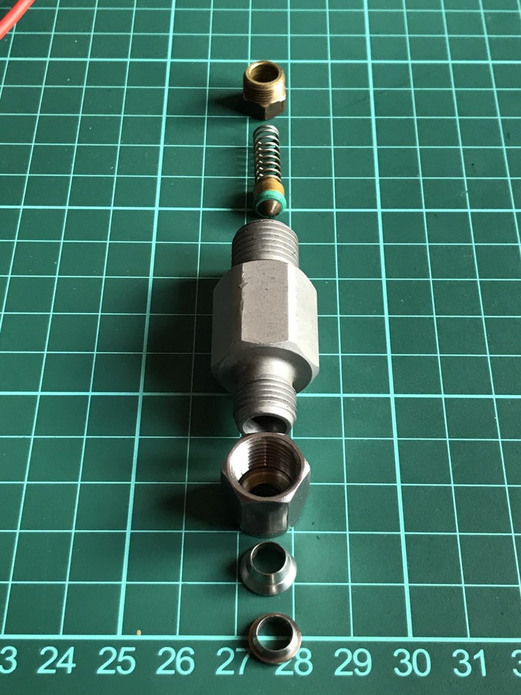

Be_Airgunner. That looks like the same problem I had. The line has blown out of the ferrel and nut. It can be re-installed. Remove the nut, and you'll find the ferrel inside.Put the nut over the line, the ferrel on the end of the line, and put it back on the connection, and tighten. Before you do that, remove that fitting out of the cylinder/filter trap. On mine, there was a check valve, that had gone bad, and stuck closed. I removed it, as there is already a check valve on the output line on the high pressure cylinder.
Pull that fitting out, where the line blew out, then you can easily remove the nut, and get the ferrel out. Nut over line, ferrel over line, push up an inch or so, then insert into the fitting, and push it all the way in, then slide the ferrel and nut in place and tighten. On mine, when that check valve locked up, my line blew out at the other end, where it hooks to the top of the high pressure cylinder. I'd just about bet the check valve in yours is locked up too. Let us know what you find.😁
