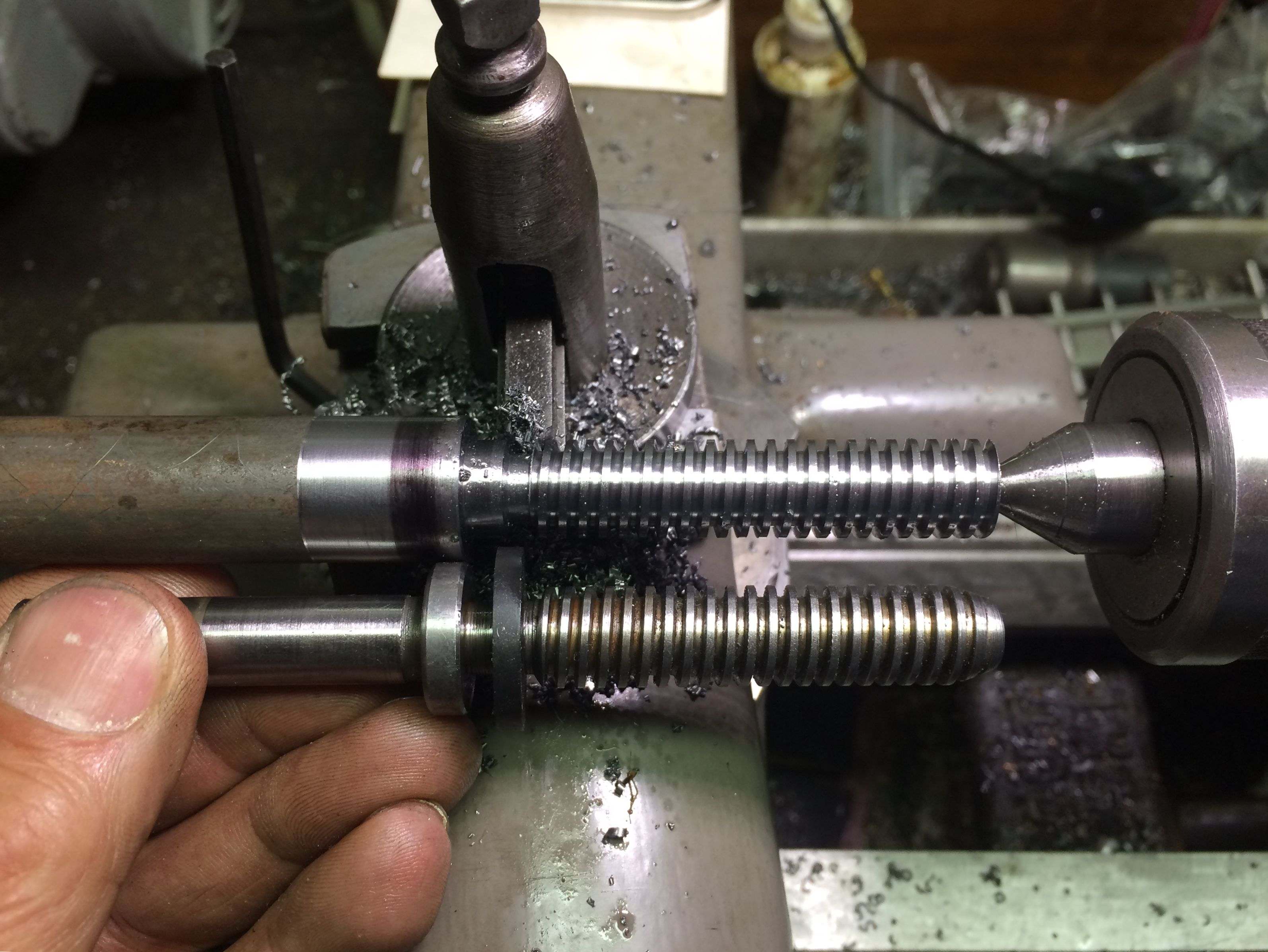

I cut this Acme thread in reverse with no issues. The form bit I ground takes more torque to run than a standard V thread.

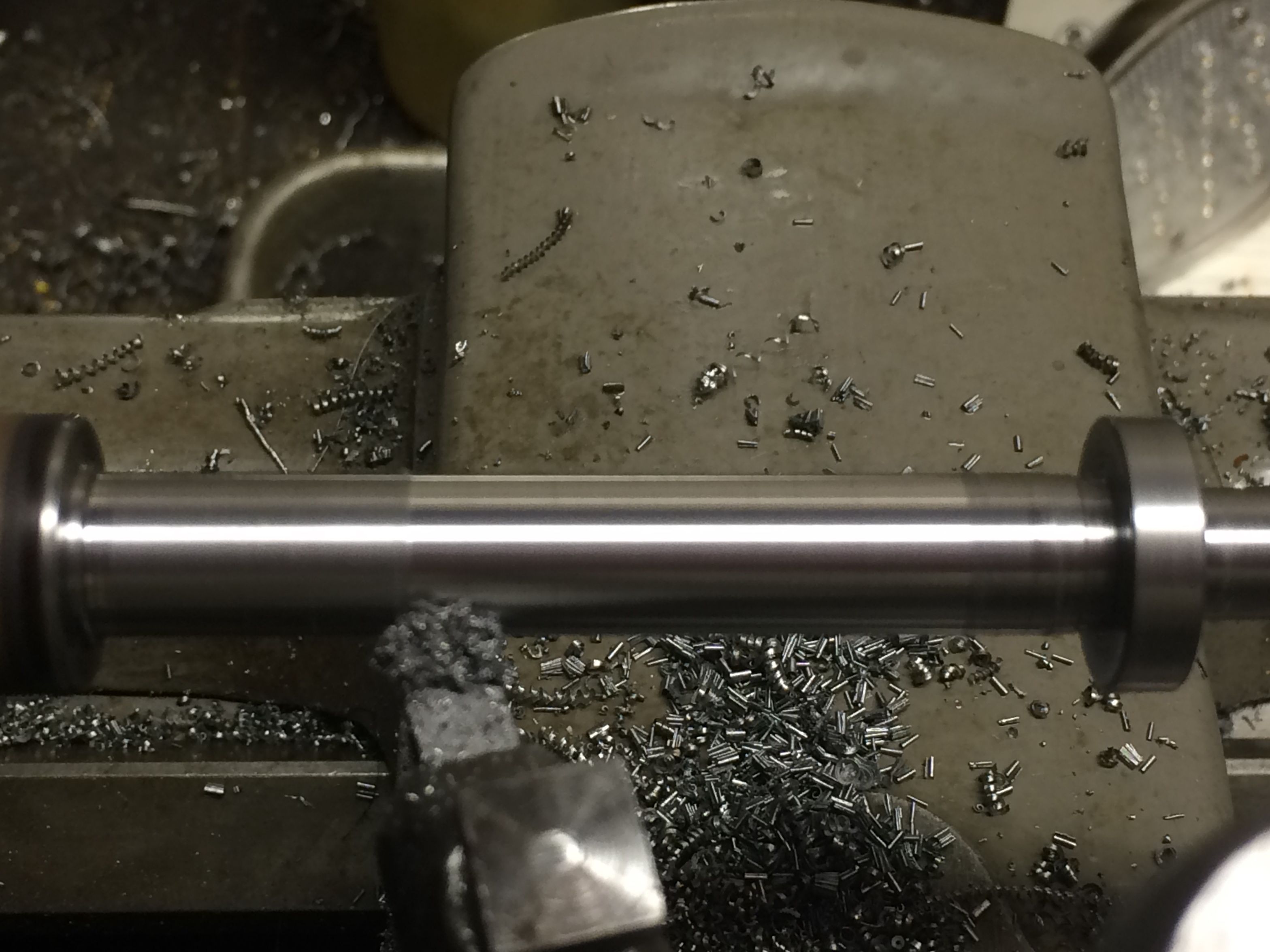

And here is that shaft being turned dry making the finish cut getting a very fine finish with HSS
Shearing tool in the second photo? Looks like it from the DoC and the "mush" on the cutter. That's one of the rare exceptions where I resort to using a cutter-grinder (actually a single-lip cutter grinder) to get the geometry correct.
It's only fair to mention that the material has a lot to do with it was well. 12L14 will leave a great finish under shoddy conditions, and "home store" 2018 usually isn't going to finish nicely under any condition. I mention this because new folks might grab whatever they have laying around (rebar?) and wonder why they can't get a good finish.

It's just a general turning tool. Running a low clearance angle to improve finish. 12L14 is lead alloy that gives a real nice finish and breaks up chips. Most everything I make is from scrap metal I scrounged over the years. For gummy steels increase your top and side rake angles.
potentially reduces the life of the edge some but I'm not running production so it's not really relevant. Or just chuck it if it's too bad and grab something else. But I can usually make even hot rolled perform acceptably. The small screw I made above in post #21 is from a scrapped stud.
