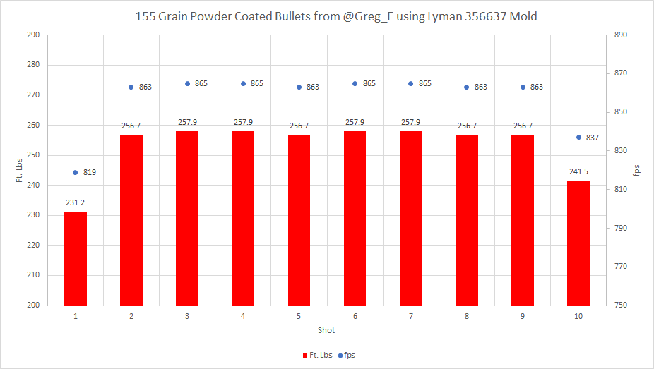

I did a test print in a 3x3 configuration, and brought nine home for testing. They are 155 grains using the Lyman 356637 mold.
Shot out of a modified Benjamin bulldog 357.
It took me three shots to get the hammer spring strength correct, and after that here are my results (I filled the air after the 4th or 5th shot, I cannot remember, and the first three shots not shown did not have the correct hammer strength):

Sorry guys I forgot to answer that. I was shooting at about 5 yards, no accuracy testing other than I was hitting the same hole every time. At 5 yards I don't think that means much. I am looking for somewhere to shoot in MN if you know of anybody. This gun is not really backyard friendly.

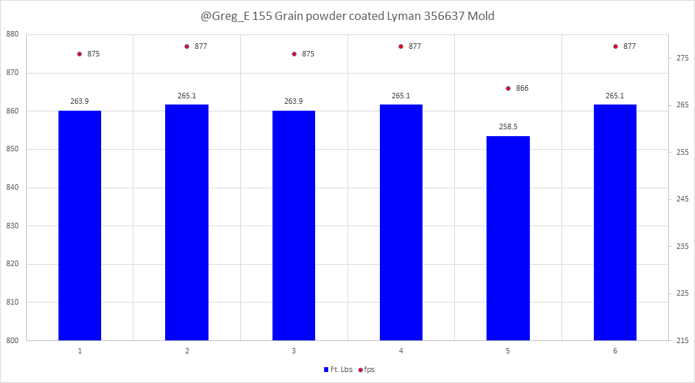

I did some more testing of these 155 powder coated bullets from @Greg_E during lunch, but it was after I was testing some other lighter bullets, so the hammer spring is both different than before and unrecorded. Also the last shot was after the air pressure was below the regulated pressure. I am not sure why that first shot was low.

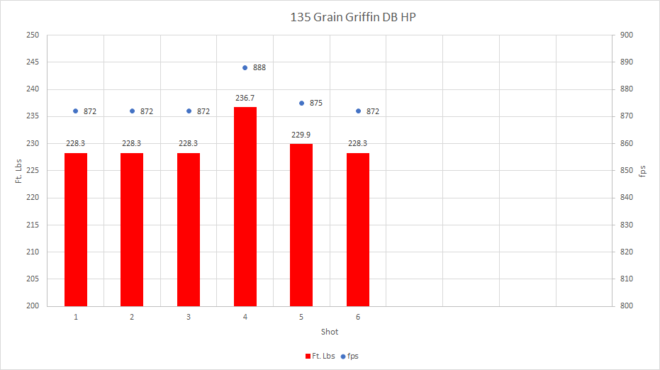

The following were for 135 Grain Griffin DB HP but it seemed no matter what hammer cap rotation I was wasting a lot of air. I think the following string had the hammer cap a lot further out than I should have had, but it was giving me the best results.
