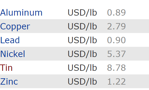

I'm a big believer in copper bullets for big game hunting, not even from an environmental standpoint, but from a terminal performance and meat loss standpoint, and I've put some thought into the thought of casting non lead for powder burners, but not airguns. As far as powder burning guns are concerned, the main problem is that there aren't any metals other than lead that are castable at lead casting similar temps, have ballistic properties similar to lead, and are affordable. Other than some of the non lead bismuth alloys that are out there, which are more expensive, I think tin is the best you can do. It makes bullets that are approximately 7/11'ths as heavy as lead due to the difference in density, which isn't good for many firearms applications, but I thought it might be better suited to airguns since typically airgun bullets for big bores arent as heavy as typical bullets of the same caliber in firearms. My thinking was you could use the same molds as for rifle bullets, but cast them in tin and have suitable weights for airguns.
Another problem is that tin is a lot harder than pure lead, so you need either a big HP or a big meplat for good performance on game. Finally, if a warden were to ask you about your ammo, you have to somehow prove your gray metal bullets are tin and not lead. In the end you could defend it just fine I'm sure, but you'd have to go through that headache.
