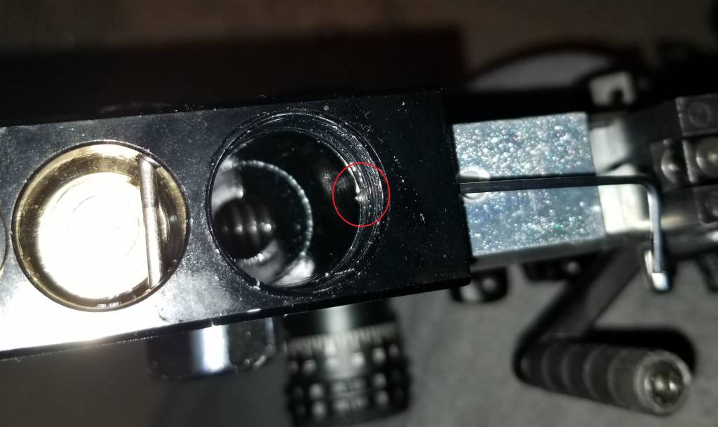

This is a Public Service Announcement for those who want to increase the plenum volume of your Avenger. I just performed this upgrade last night, and it took a WHOLE LOT longer than I anticipated from watching the upgrade being done online. Well, it turns out that there is a tiny set screw that gets torqued down on the actual threads of the Pressure Relief Valve Plug assembly. I just thought that there was lock-tight on the threads, so I gnarled the top couple threads of this plug pretty badly.
Here is a picture of the set screw peeking into the thread assembly. You can also see the 1.5mm allen wrench that I have inserted into it. You have to take the back of the stock off too, when getting to this screw.

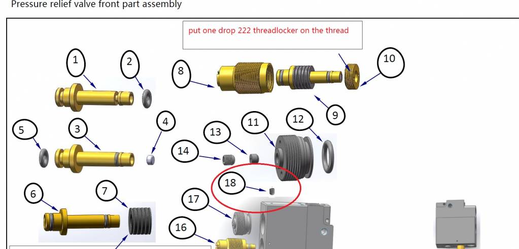

Here is a picture of Page 9 of the Avenger Schematics that shows the Pressure Relief Valve Assembly. You can see that part #18 is the set screw, but this isn't listed in the table any where. I consider this to be on me, but I wanted to show this minor discrepancy.

Hello Avenger Fans,

That little set screw catches a lot of people out, including myself initially but I figured I'd missed something in less than 1/4 turn. Others are not so lucky. I made a new plug for one guy that made a real mess of his. I also managed to save a couple too with a little filing.
I usually provide instructions with the plenums I make BECAUSE I know that little screw can cause a lot of trouble.
