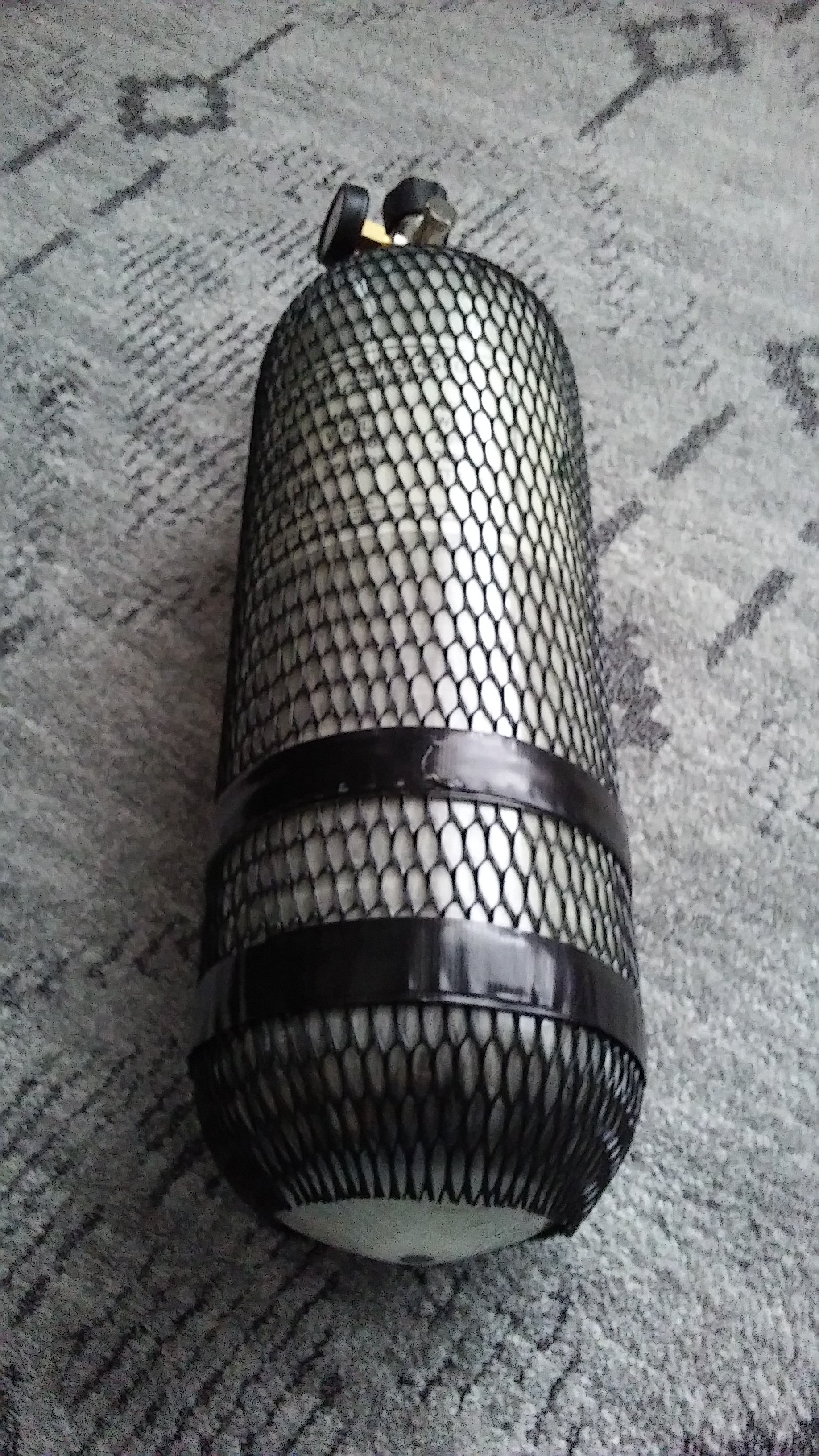

I have a couple of Air Venturi branded carbon-fiber SCBA tanks that have some very clear differences. They are sold as “Wingman” tanks. Both appear to be the same size carbon-fiber wrapped tanks, but they have differences. One is almost completely smooth to the touch if you rub or rub your fingers across the tank. The other is wavy and bumpy when you run your fingers across the tank. Particularly around the bottom and the label. The labels are different. There is a year difference between the date of manufacture. I have also noticed that one tank (the bumpy one) sits slightly taller than the other and the taller tank also has a neck (of the tank where the valve screws in) that is slightly wider than the valve.
I have my suspicions about one of these tanks. I would like to read how members who own these SCBA tanks describe their Air Venturi carbon-fiber SCBA tanks. If you rub your hand(s) across and around the surface of your tank does the finish feel smooth or bumpy? What is the year of manufacture? What does the label say? Did you buy yours new, used (from an online Airgun shop), new old stock, reconditioned, used from an individual, used from an auction site, etc.
Edit: Upon closer inspection one tank appears to be a 60 minute SCBA tank the other is a 45 min tank. I’m still curious about the experiences of others.

So with help from @Gerry52 I realized that my tanks are made in two different places and probably be different manufacturers. Also, they are two different sized tanks. I couldn't see it until I looked at a photo of them side by side. One is a 45 min tank, the other a 60 min tank. The folks I bought the 60 min tank from didn't seem to realize that's what it was. I asked and that's not the answer I got. So thank you Gerry.

My AV 98 cf (60 min.) tank is made by Draeger and is smooth with tape wrapped over the labels. I believe I bought it in 2018.

I have a AV. 74 cu. ft. wingman manufactured in 2021 bought from a vendor ( new old stock ). As far as the label it's hard to read as I have webbing over it. The tank is smooth as glass and the same as my great white tank. The valve sucks, hard to open and close btw. I know its not a 60 or 45 but thought I'd throw it out there. Maybe ask a vendor that sells them. Edit: Further inspection tank is made in (KOREA)
