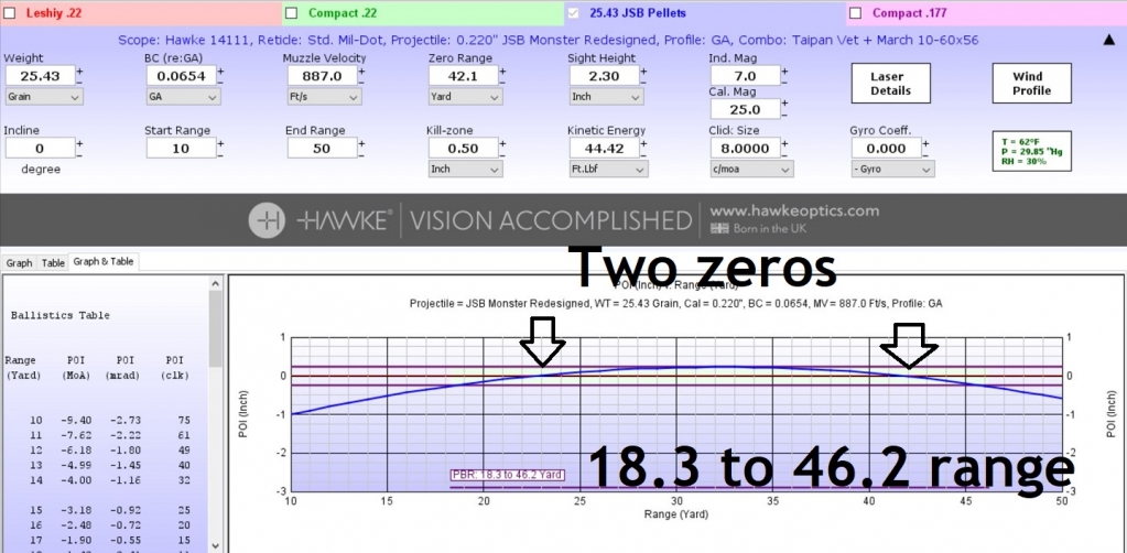

Optimum zero in Chairgun is intended to set you up so that your projectile rises to line of sight, crosses it and goes above line of sight and then drops until it crosses it and goes below line of sight. Why? Suppose you shoot at a target the size of a golf ball. You are in the field and you have no means of estimating range accurately. You want to set up your rifle so that you can aim at the center of the ball and have the pellet strike the ball anywhere on it. Essentially you establish a BRACKET of ranges wherein that pellet will hit the ball if you aim at the center of your target (golf ball).
There will be some range at which the pellet has risen enough to hit the bottom of the ball. That range is the near edge or closest range. There will be a range at which the pellet has risen above line of sight and will just hit the top of the ball. This is close to (not exactly) at the center of your bracket. There will be a range at which the pellet has dropped where it will just hit the bottom of the ball. That is the far edge or farthest range of the bracket. This "range bracket" is established by setting the FAR zero (second point where the pellet crosses zero line) so that the longest distance is covered in the bracket.
Said another way. The optimum zero is that point at which the pellet crosses the line of sight on its way DOWN from the highest point of flight above the line of sight. The range bracket or effective range or zero zone is that spread of distance between which the pellet will strike the bottom of the target zone as it rises towards line of sight and where it will strike the same point after it has again fallen below line of sight.

Near point blank range is the closest the object can be and still hit it with your zero without holdover or under. Far point bland range would be the farthest you'd still hit the target. The smaller the kill zone, the shorter the PBR will be. Entering .1" will give a very short range of PBR values.

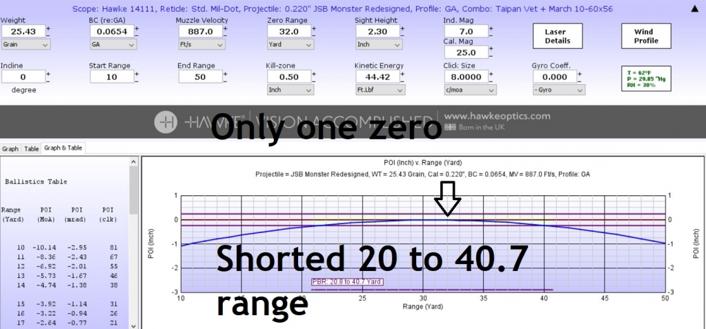

Choose "Single Zero Range" if you want no hold unders and a single zero point.
Here is an example using all the same data but changing from the Optimum range (2 zeros) to the Single zero range. Notice that the overall PBR is shorter for the single zero range.
Yes. If you want to set a zero stop and always click for the range, you can enter 0.01 for the kill zone dimension. Then when you click the "optimum zero range" from the toolbox, it will show the near/ far zero as the same.
