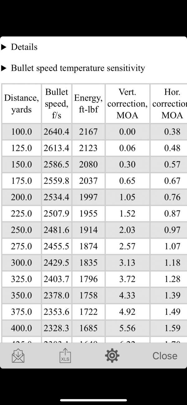

Maybe its different with android. On my iphone after you have all your data entered you go to the main menu. At the bottom theres two rows of buttons. The one on the far right that looks like an empty calender takes you to your trajectory table. Once you are at the trajectory table open the settings button on the bottom of the screen. In the settings window you can change what data is shown and switch between moa, mrad and inches. Theres a button for turning on bullet speed, energy and flight time. If you turn on bullet energy it will add a column in the trajectory table that shows the energy at any given distance.
Heres a pic showing the energy column.
1544815682_16815040445c140442838dd9.69648625_A7EEF22D-FD9F-47F0-B4DC-B13DBCD5B13A.png
I see what you mean, LDP, yeah, there is a way to find FPE. Thanks.
