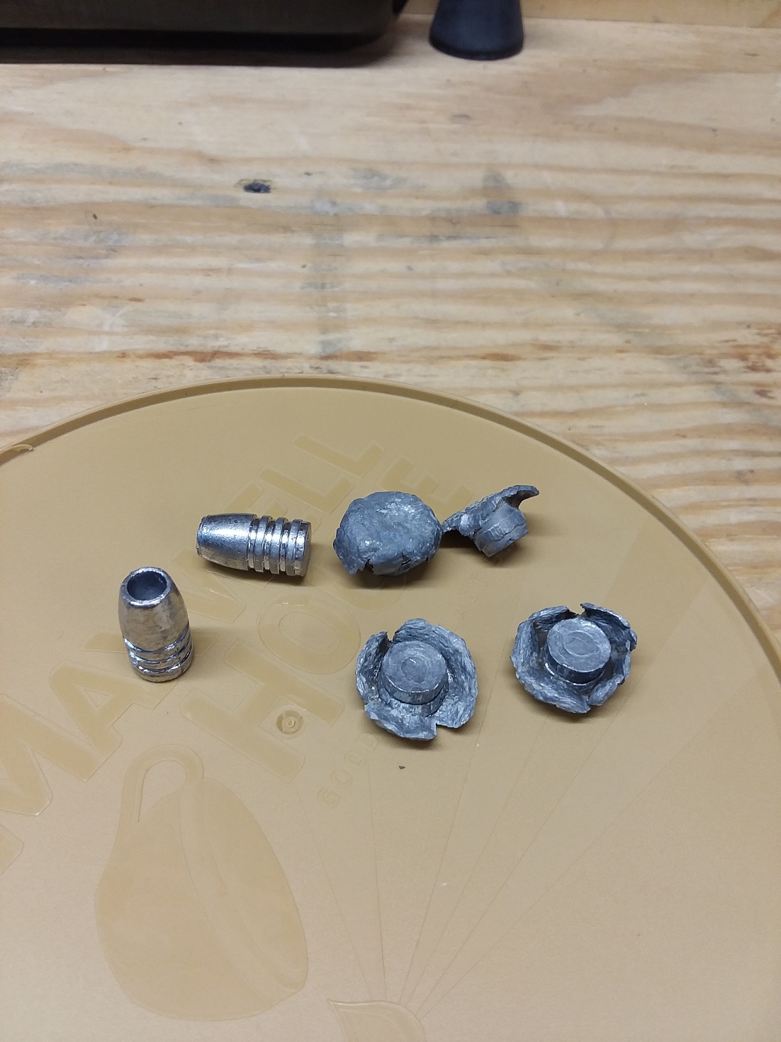

Started with MrHP's slugs but had large deviations across shot string on chronograph. Slugged bore, was .457, resulting in his barely engaging lands. Groove's were .461ish. So got myself for setup casting .460, more $. Experimented sizing .458, .459, and powder coating. Best results just .460 as cast. And absolutely hates powder coated slugs.

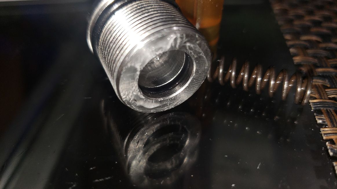

Next, last weekend, suddenly started what I thought was valve bouncing, by double firing randomly. Tech support gave possibilities, and sending another spring, not arrived yet.

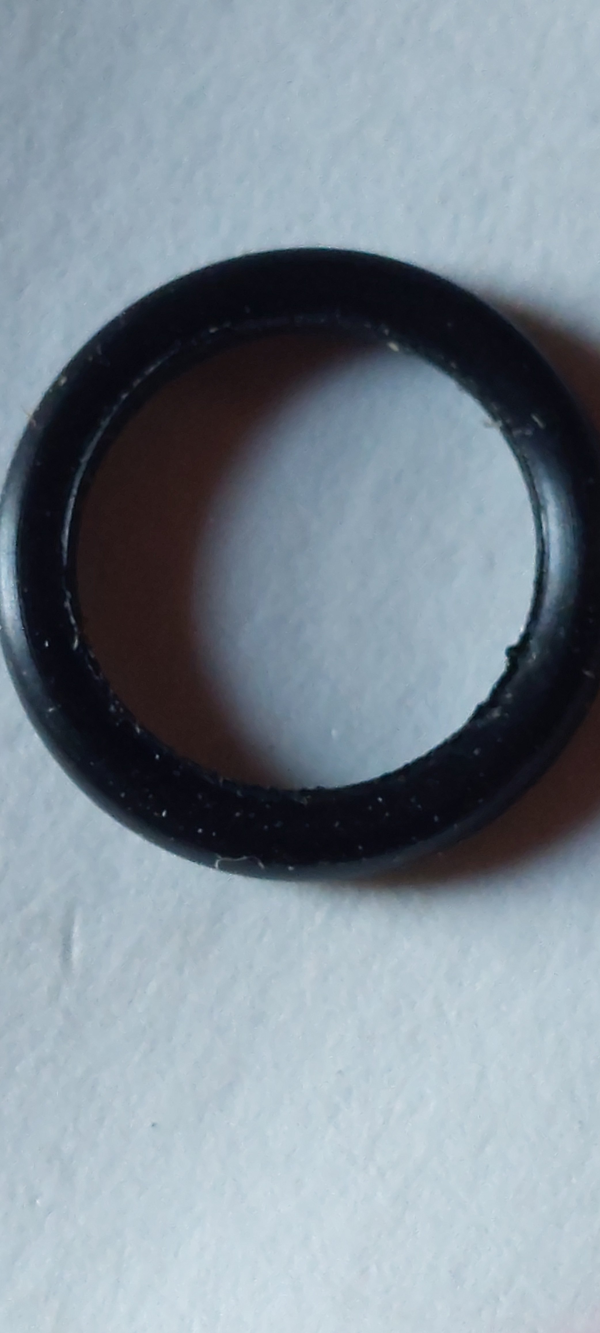

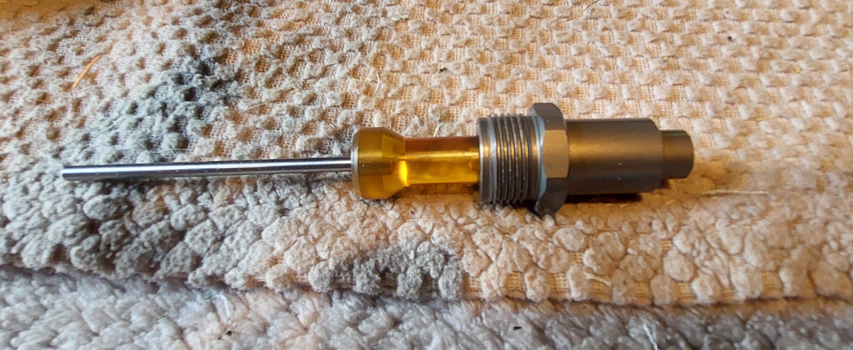

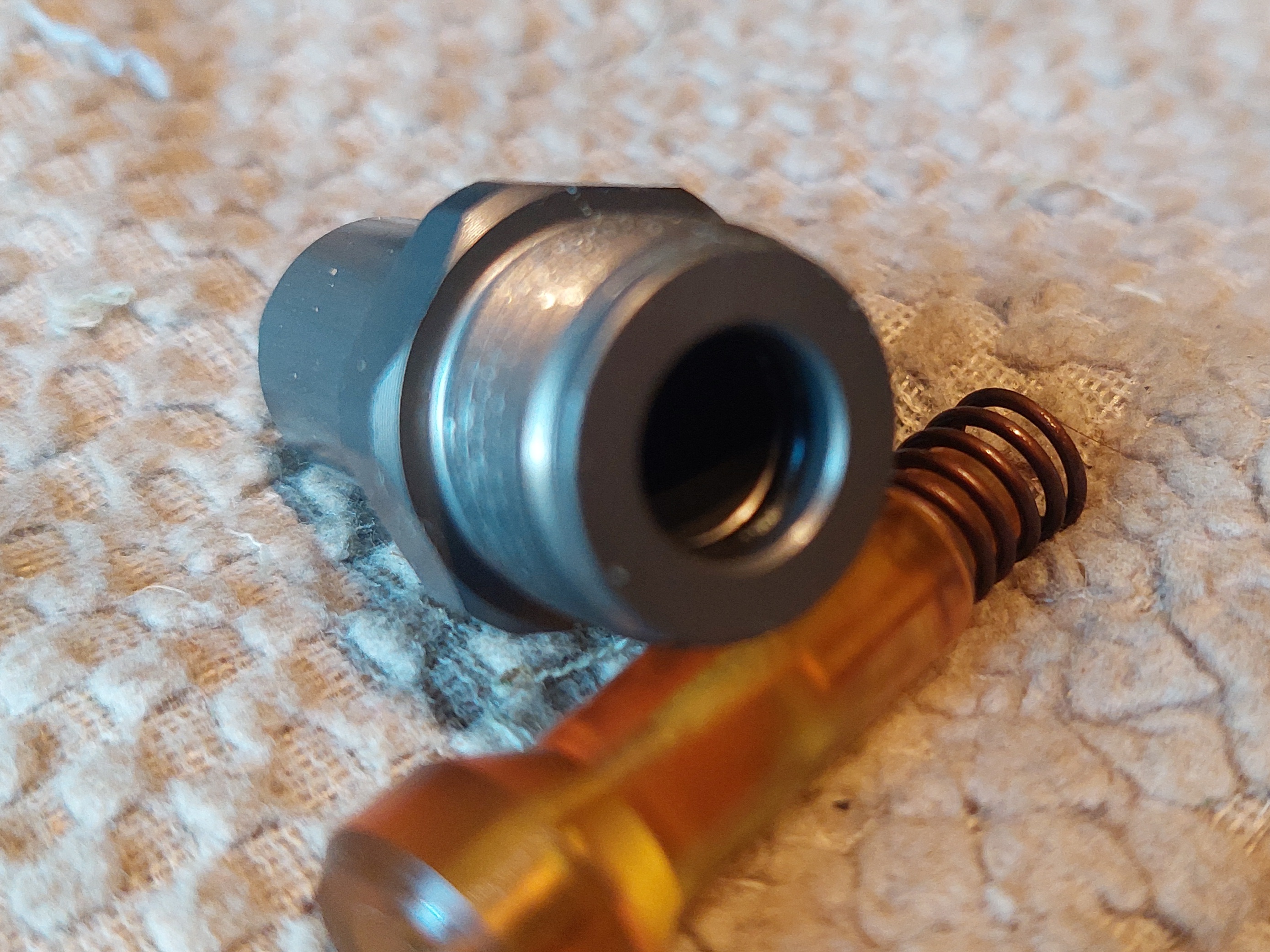

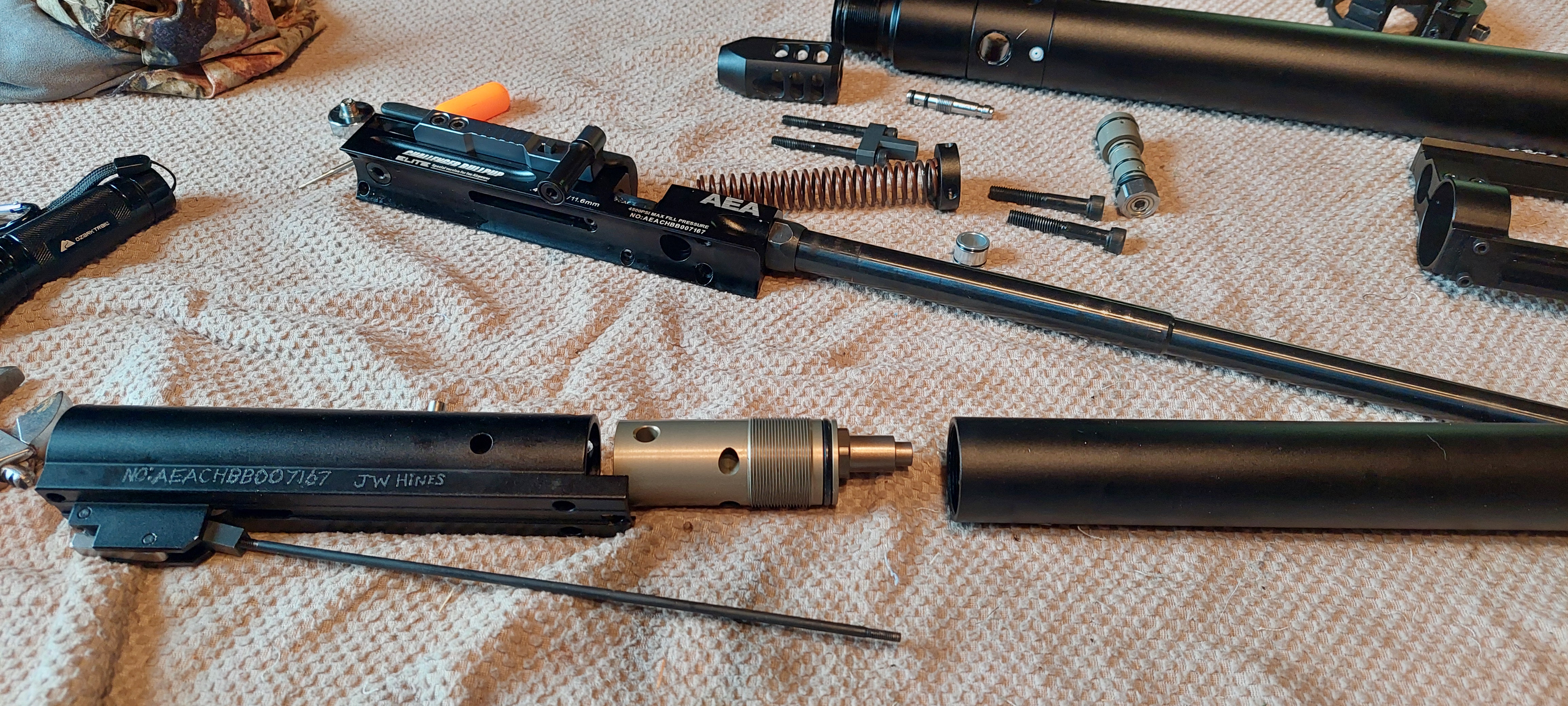

Less afraid now, took apart gun this morning and found valve pin was hanging up in it's o-ring. Fortunately had already bought the o-ring kit for gun. Replaced o-ring (#42 in gun diagram) and valve pin moved smoothly. 50+ rounds today FINALLY not a single issue.
