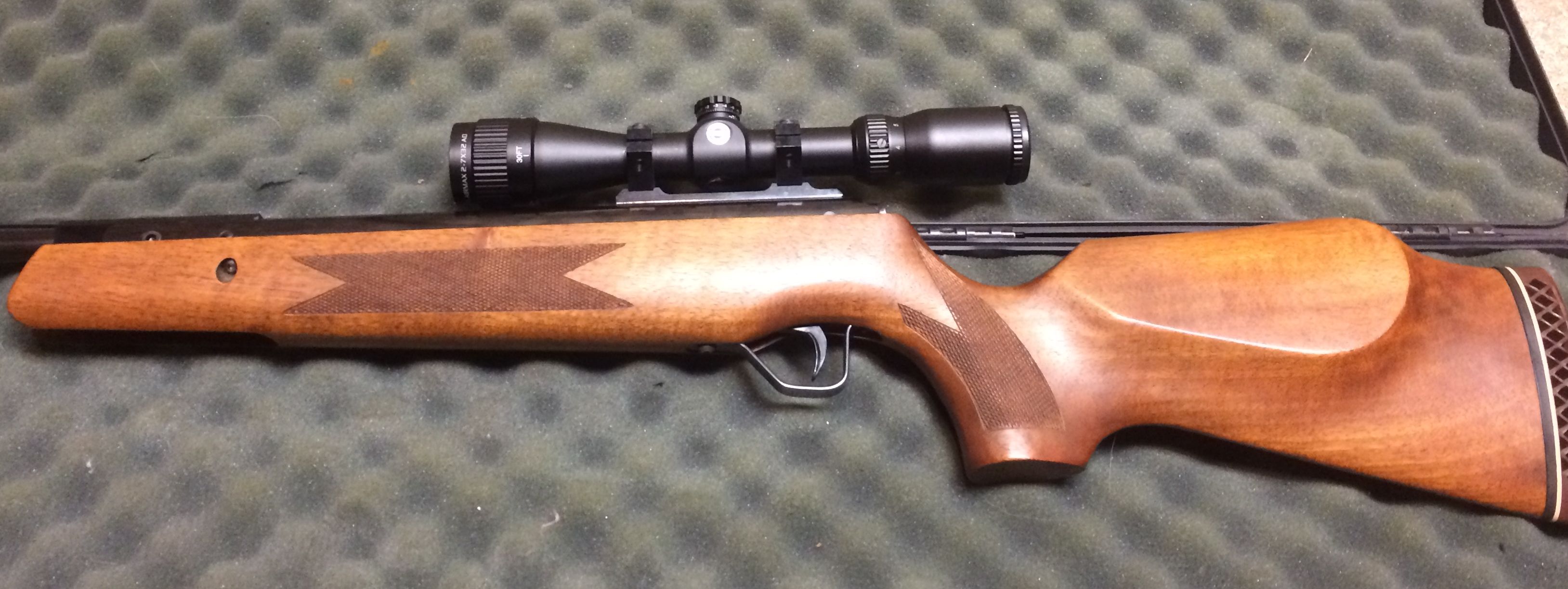

I had one of my Siroccos in storage for a few years. Our 3 son's sports kept me pretty busy. Some years I had 3 sons in jr high, varsity, and college wrestling at once. Track, cross country, and soccer too. Summertime trips to wrestling clubs, etc. And fall/winter we also had some great night time walleye fishing I couldn't resist. When I broke that particular gun out it honked when cocked and had very erratic low velocity. I lowered the ram pressure and tried a few drops of Beeman silicone oil I had since the 80's. Which the manufacturer forbade. After a few sessions shooting consistency returned so I raised the ram pressure to shoot 17 ft lb. I did see and smell burning for a few shots. Expected the seal to need replacement soon. It's still shooting great 3 years later. I don't shoot it very often, though. The original seal is 35 years old. Still one of my favorite shooters.
  • Love
Reactions: BABz58 and Steveoo
